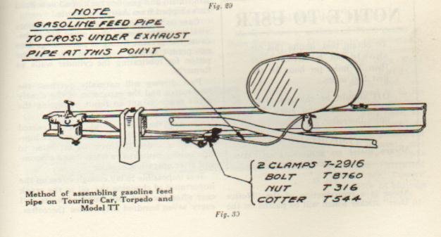

				Ok, I added those Cotter Pins and the frame clip, even though I only show one, it should be understood that there are actually two of them, they hold the fuel line in two place.
				Re: ***1920-1925 Fuel Tank Assembly & 1926-1927 Fordoor Sedans***
				Posted: Thu Oct 10, 2019 6:29 pm
				by Scott_Conger
				Martyn
I think the "two" refers to the double clip that makes up the single assembly. I believe your drawing is complete as-is.

As for copper vs steel gas lines,  the times I've seen leaks is when copper tubing is used with a brass compression type ferrule in the standard Ford Packing nut against the Ford carb elbow.  The angles aren't correct for compression fittings, were made for felt, and over time these rigid ferrules  will crack the copper line  at the carb.

				Use type "L" copper it is a heavier wall it is also called refrigeration copper and use a flare fitting instead of a compression ferrule it wont crack. Think about your air conditioner or refrigerator running for years with high pressure up to 600 psi and add the compressor vibration and pulsing and the copper lines hold up forever, Ford used a seamed brass line but with felt compression fittings and they held up well, don't knock copper it is tough.
