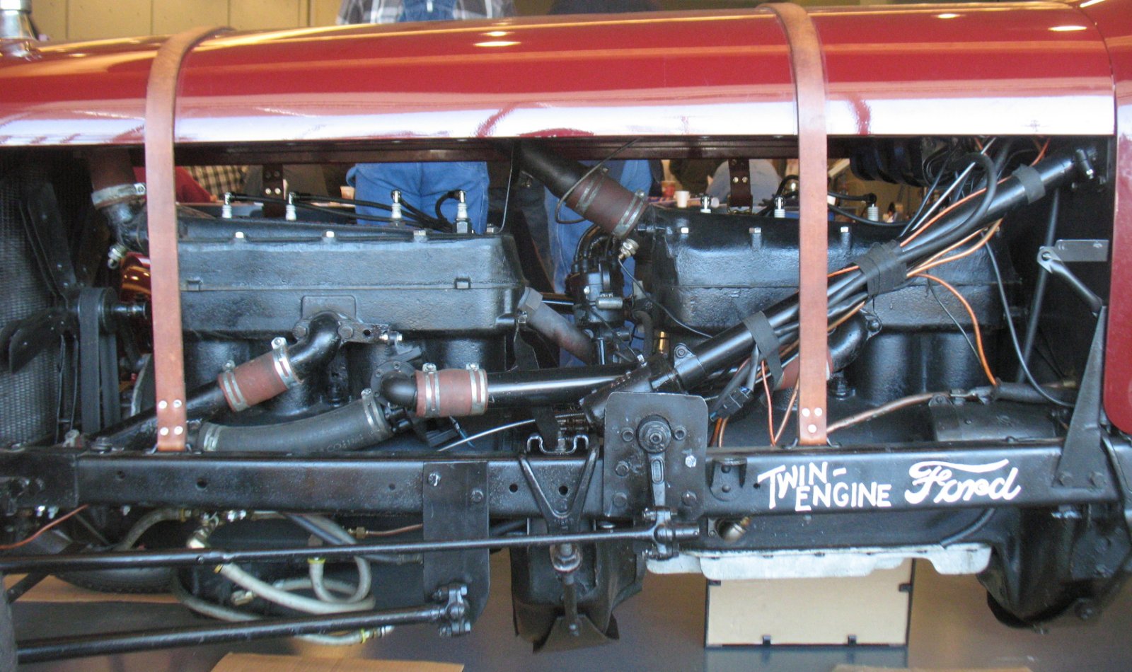

..and Gary LeFever’s stunning special

by Wayne Sheldon
This is fascinating to me. I have seen several pictures of Gary LeF's car before, as well as a couple others. I have also seen pictures or read about three or four tandem block eights built back in the model T days.
Look at the era photo above of the engine. Notice the rear intake manifold. It appears to be aluminum, doglegged, and facing backwards. I think it would be an N/R/S intake manifold. The front intake also appears to be aluminum and doglegged, but faces the model T usual way. Probably '09 to early '12. The rear pan appears to be '13 to '16, three rivet arm and not a "teacup". It would be nice to know the history behind that engine.
I look forward to continuing updates on your project! You can just keep adding onto this thread like other people do to share their ongoing projects. Or start new threads if that seems to suit you better. Most seem to prefer ongoing threads as they can easily refresh their memories when new updates are added.

wayne sheldon wrote:
Thu Oct 31, 2019 6:53 pm
I would have written it off as being a T manifold with the bottom cut off, turned 180°, and welded back on. Just a guess but I don’t think much of a stretch given the effort that went elsewhere in that engine.
