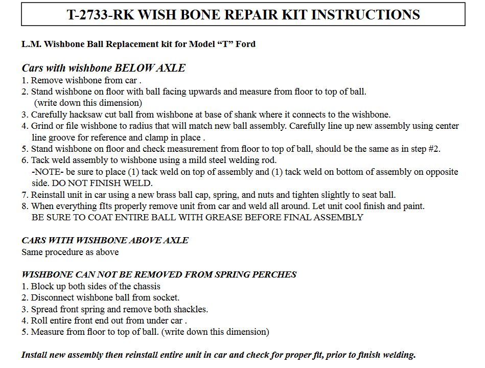

Attached is a replacement type ball kit mentioned above in the other posts, that I installed on my '25 touring. The ball also pulled out of the APCO socket due to ball wear and excessive pulling while hauling. The worn ball barely measured 1.1" whereas the new ball measured 1.25". At the time of the replacement, I replaced the radius rod ball cap with a new steel cap. Upon completion, everything fit real good, and steering was great. Now, when I haul the car on my trailer, straps are attached to the frame- not the front axle or the wheel and tires.
This is my 4th T to install the new ball kit on, and all went well with no re-do's reqd! Tools required- tape measure, welder, hand grinder with a cutting wheel and grinding wheel. Go slow, be persistent. It's easier than welding up a ball, then lots of filing and tedious measuring.
Just don't install on a car to be shown in a Concourse type event. It looks really different than Henry's original. It'll cost you points.

The answer to your second question. Yes you can weld it up & grind it back round. I do this to wishbones & pitman arms when ever A worn part is found.
That cnc machined replacement weld on ball looks like a good way to go if you dont have the tools or skills to weld the original ball back up.
