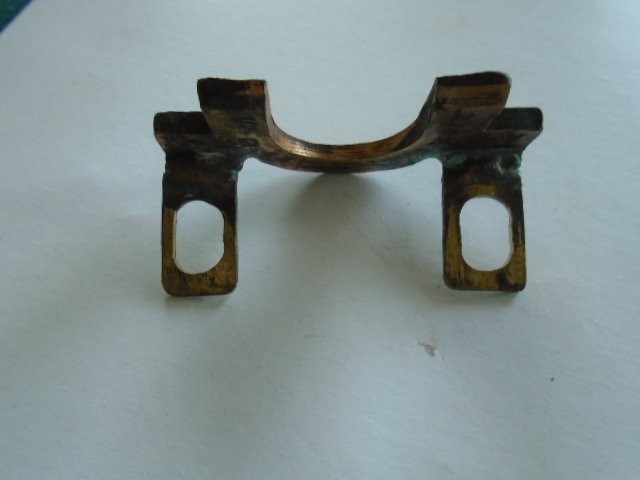

Could be something simple like a corroded switch, or might be something not so simple like a worn rear main bearing allowing fore-aft play in the crankshaft which would allow the magneto gap to change.
Like the others have stated, I'd start by taking the switch out and inspecting the contacts and connections.

Round up the usual suspects. Individual One on my list would be the switch. Scott's link will tell you all about it. Last week I fixed the intermittent switch on my 1923 touring. The price was perfect. All it took was slightly deepening the dimples and pulling up the contacts a little. My second suspect would be mag post lint, but I think that's less likely to be intermittent than the switch.

The problem may be in the switch. Take the switch apart and check all the contact points. In my expierence the tabs can be loosening the tension against the contacts. Use some fine sandpaper and lightly sand all of the contact areas and carefully bend out the spring tabs for better contact. That usually will take care of the problem.
