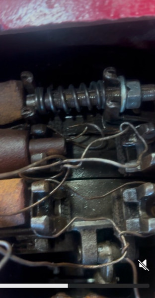

I recently replaced the brake band on my Model T and ended up doing it in a way some of you might appreciate (or laugh at). I didn’t have the proper band-changing tool available, so I improvised with bailing wire to snake the new band around the drum.
I also chose to do the whole job in the car, without pulling the hogshead. It took some patience and a few choice words, but it ultimately worked. I filmed the process in case it’s helpful to others, or if anyone wants to comment on better techniques or things I should try next time.
Here’s the video if you’d like to take a look:
https://youtu.be/Mfq15zHDguA?si=tIYA2AfIvGVJao_Y
I included both real-time footage and some high-speed sections to show the fiddly parts without making it a long slog.
Would love to hear how others approach band changes in-car — tips, tricks, or tools you swear by.

No laughing here. I used a Oxy-Acetelyne welding rod. You can also use a coat hanger to do it. 1” banding also works OK. The 1” banding with a split brown handle about 6” long makes for a good handle for it too.
Here an advertisement from Ford about Joe Snow and how long it took for him to do it. I’ve never done it that fast. The add doesn’t say if he used some kind of tool to pull out the bands though!
In the Ford dealerships the mechanics had it down because of the number of times they had to do it. Most of us aren’t pressed for time these days and not being able to do all kinds of twisting and turning to do it. But I did remember to put new bands in when I had the engine out of the car to rebuild it. That made it much easier!!

Thanks, John! Good to know I’m not the only one who’s improvised a “band tool” out of whatever was on hand. A coat hanger or welding rod probably would’ve saved me a little grief, but the bailing wire did the job in the end.
That Ford advertisement is great — I hadn’t seen it before. I’ve wondered what kind of magic Joe Snow was using to get it done that quickly. Certainly wasn’t my experience!

Changing bands in a finished car is the best selling point for Kevlar. At 6'3", its just flat horrible.

I just finished putting a motor together and I don’t have the band clamp tool so I wired them all up with baling wire. Good for making cotter pins if you can’t find one, I’ve got it holding the muffler up on my 88 GMC where the tailpipe rusted in two as well.

I use nylon zip ties to hold all together whilst replacing the cover - they USUALLY slip out from under the band ears but being nylon, if a small piece goes AWOL, it really can't damage anything.
Took the words right off of my keyboard! If ya lose some part yep they'll just be ground up!

Thanks for all the responses! I didn’t expect a vocabulary lesson, an engineering lecture, and a comedy show all at once, but here we are. I really enjoyed reading everyone’s explanations and learning from you all. I had no idea my misspelling of baling would take on a life of its own and spark so much discussion—apparently one wrong vowel can start a small linguistic wildfire. Lesson learned.
I also appreciate the comments about using Kevlar or similar materials to avoid having to redo this very often. That definitely makes sense, and I can see the long-term value in investing in something built to last.
And truly—I appreciate all the input, even the teasing. It’s part of what makes this group fun. Thanks again to everyone who jumped in with advice, corrections, and a good laugh.
Also, Robert mentioned “no attempt to true up the band to the drum before installing the lining.” I thought I had done that by fitting the band around my drum jig (as shown in the video), but I may be missing something. Robert, could you explain what I should look for or do differently? I’d really like to understand this better.

I might add that I mount my linings to the bands then soak in an old Dutch oven - takes 1 gallon of oil but can do all 3 at the same time with small sticks holding them slightly apart - a couple days soaking then I hang them over the pot with sticks to drip off - still messy but not as messy as doing it your way.

. . . I mount my linings to the bands then soak in an old Dutch oven -
I do the same thing, Steve. I believe it makes a big difference in how cotton linings wear. FWIW, the Ford manual recommends it !

. . . Robert mentioned “no attempt to true up the band to the drum before installing the lining.” . . . ?
Just about every T owner who has changed bands a few times will have his own ideas, and will prefer methods (or the lack thereof) that work best for him. T’s are rugged and forgiving, so there’s a pretty wide gamut of what will “work”.
That said, anyone who has worked on any number of Ts will have noted how band linings wear unevenly, sometimes to the point of failure, when the bands are out of round or sprung. They still work, though !
The best service and performance is to be had when the band is concentric with the drum, and not bent or distorted in some way. Truing the band is best accomplished before installing a new lining. It’s for this reason I have never liked the “quick change” removable ear bands snaked through the trans cover inspection opening.
