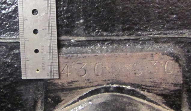

I know I will get a rebuttal on this, but have have not see an engine with my own eyes that the numbers were nice and straight. Look at the number of engines produced per day after the assembly line got perfected, I doubt much thought was given to making them nice and straight.

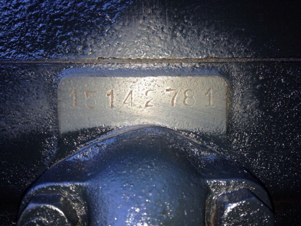

These were hand stamped, so yes, none are perfect. But depending on the skill of the employee, and likely the time of day, and a nicer shift, perhaps his work was very well done. Have seen several, including my '27 below that is fairly nicely done
Here is another nice one
These workers were proud of marking the Ford, with skilled hands, one motor numeral at a time.

Dan, I guess by the time the guy to 14 million he got good. My two '25s , my '14 and all of the spare engines I have are very hap hazard.
