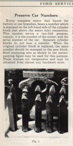

There is a Service Bulletin that covers how to do this. If you can think of a question of how to do something, there is most likely a Service Bulletin that covers it. Dan

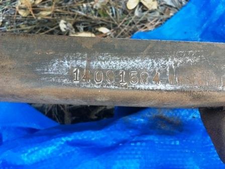

Re: Stamping a new serial on a blank engine block.

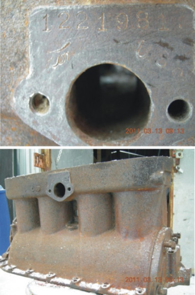

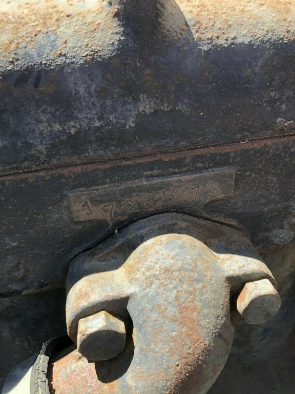

Post by Jeff Hood » Sat Feb 06, 2021 8:49 am

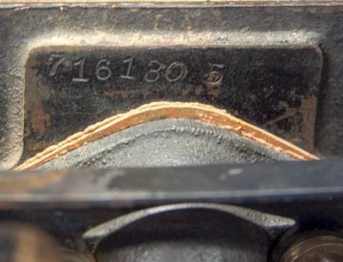

They weren't straight.
Crooked Serial Number

Nothing looks less authentic than perfectly stamped engine numbers. They were always stamped with some variation, some look pretty straight, others look like a 2 year old did it. Do it as Henry did it, one individual stamp at a time.

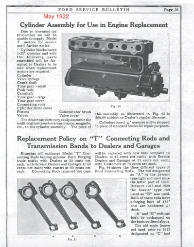

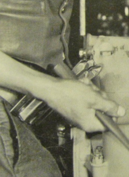

Factory stamps varied, but some are fairly nice, on this photo the skilled stamper is using a metal guide, for a very important engine, all other stamping was free hand, typically with a skilled worker on that task.
Here is the dedicated stamping worker in 1915, one view shows his box containing metal numeral stamps, and the other shows the same worker stamping the numbers on the block. Likely chosen for ability to hit the hammer blow correctly for a deep stamp that is placed best he can.
Ford Service, showing wood box of stamps. Have done blocks with Harbor Freight 1/4" high numeral stamp set, works fine. You have to have a good hard swing, but the iron block takes the imprint OK. Just don't use numerals with serifs on the ends, as those are old time looking, but Ford didn't use that font style on T serial stamps.

not straight and a double strike
Vern (Vieux Carre)

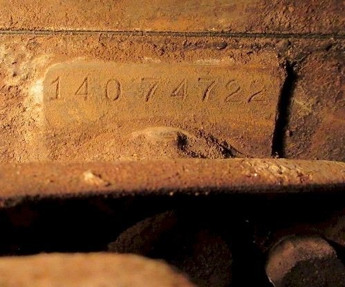

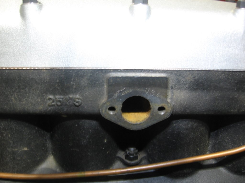

Post by varmint » Sat Feb 06, 2021 11:01 am
straight, not quite perfect
Vern (Vieux Carre)

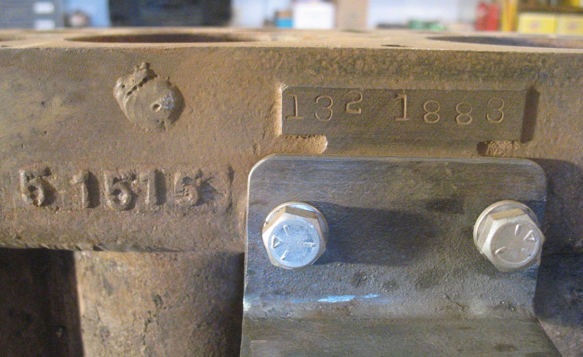

I agree, levels of skill varied. Some numbers are straight and even, others not so much.
This guy got a couple of digits upside down.

"Considering the rarity of a block without a serial number,"
I have seen several engine blocks without serial numbers, but then again I have a milling machine.

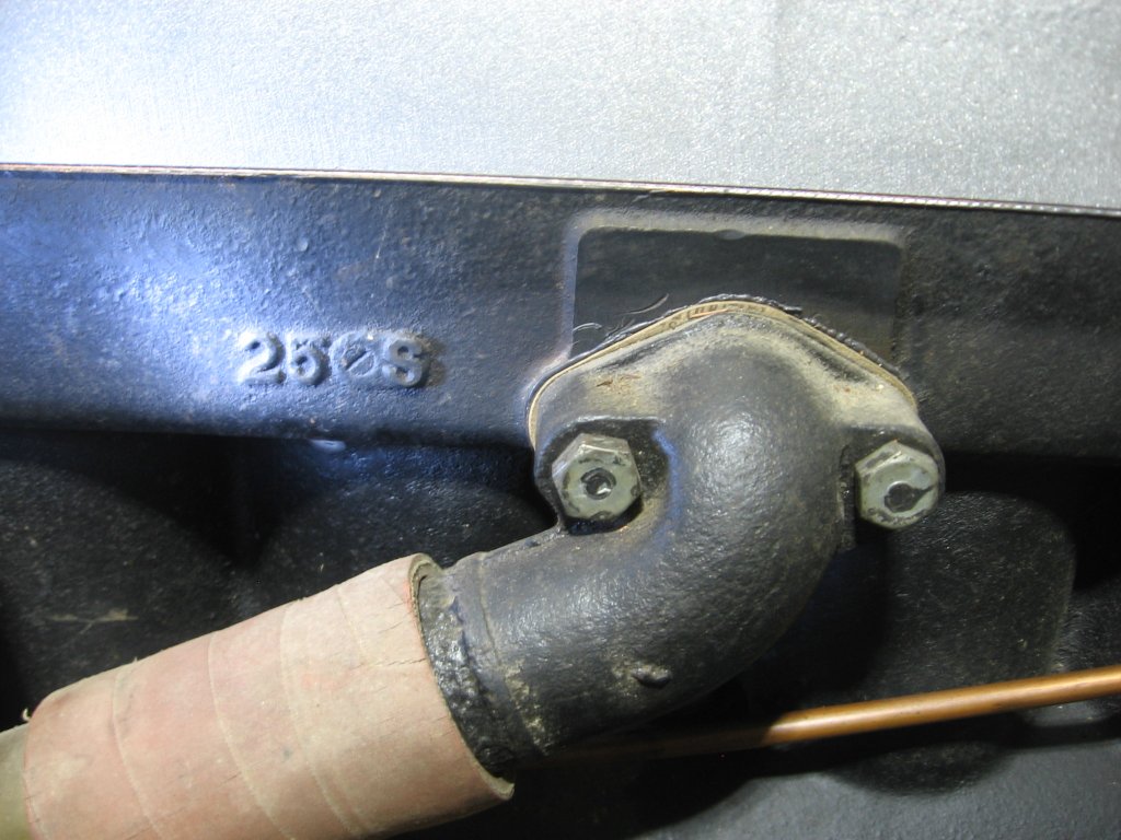

It's too bad someone altered the casting date on the '16 block Steve posted... you can see the weird shape of the "6" turned into a "5"... At least they didn't mess with the serial number, but I'm not sure how one could change it back to a "6" easily... It also shows the unusual "serifs" on Fords 1 and 2 from that era... finding those stamps might be a challenge!
Kerry
Posts: 1463
Last Name: van Ekeren
Post by Kerry » Sat Feb 06, 2021 3:59 pm
Susanne, I reckon it was an 8, the engine number pad is a give away too being the longer one.

My educated guess would be that isn’t a FORD stamped serial number
Ed Fuller
Posts: 885
First Name: Ed
Last Name: Fuller
Location: NJ
Board Member Since: 2012
Post by Ed Fuller » Sat Feb 06, 2021 5:42 pm
I agree. The 1 & 2 digits are different than on the other blocks.

I realized as well there were 3 separate sets of stamps used on that block... different sizes, different numbers, etc... 2 different sizes of "1"' (one matches the "3", the other doesn't), and the 2 and 8 are smaller...
I doubt those were done at Highland, and I wonder now if they were even done by Ford, or at a garage stamping a blank block with whatever punches they had...

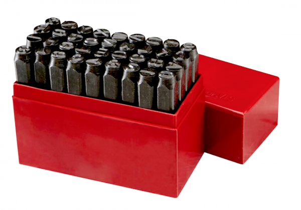

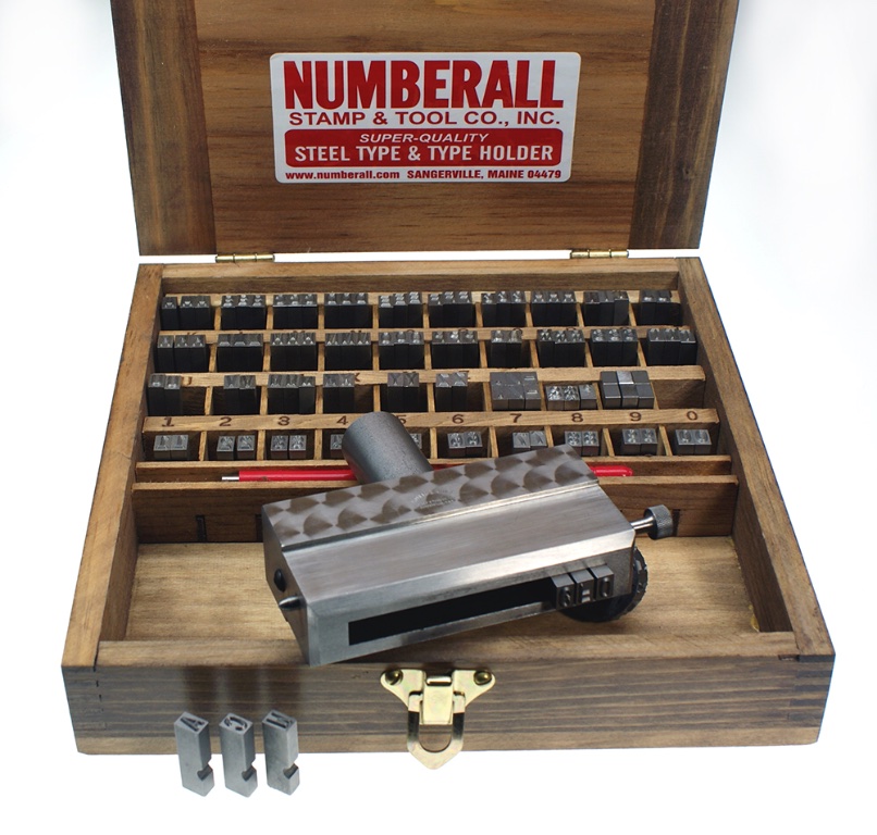

If you want to have perfectly aligned numbers, there are stamp holders similar to this one that would hold all the numbers perfectly in line.

Dan, what Service Bulletin issue has the article on block stamping? I have a complete set, and all I can find is an issue that lists the motor numbers used for given years.
The picture and instructions are from April 1, 1919 Service Bulletin. Another ref. about not grinding off old numbers in re-stamping is in July 1925 Service Bulletin.

Just get a set of stamps. They do not need to be exact Ford repro stamps. If building up a car be sure to check to make sure number is good.

The numeral 1 has both serifs on many engines, but in the service bulletin photo of the stamp set it has only the top one.
https://www.harborfreight.com/14-in-ste ... mber+stamp

FYI, here are several photos of an unstamped Model T block with a mold mark of 25 S and the Ford script and USA in the area partially covered by the lower water inlet. If you can look closely you may be able to see the boss machining marks that come down and arc to the left.

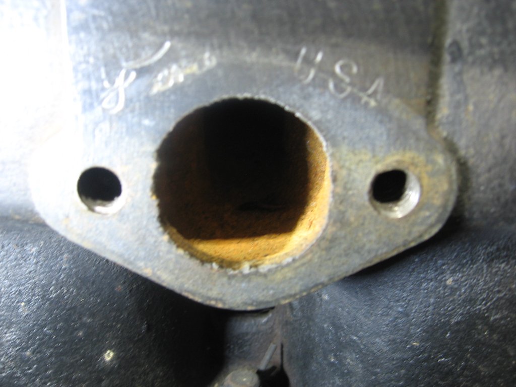

Post by DanTreace » Fri Feb 19, 2021 3:26 pm
Dom
That script just confirmed to the buyer, it was a genuine Ford block, ready to be assembled by the dealer shop or another repair shop back then.
Ford must have figured that was needed to guarantee the buyer.
There were ''spurious" parts out there by golly. :o
Image 1-21-21 at 9.28 PM.jpeg (61.45 KiB) Viewed 11131 times
Or perhaps these blocks were the ones sold to dealers, that came complete with most of the internals to assemble into a completer motor. At this time seems the factory could not ship out complete finished and serialized motors to dealers. So bare blocks with parts were sold.
Image 5-3-20 at 12.26 PM.jpeg (96.75 KiB) Viewed 11131 times
Here is another with that Ford and USA, but with a serial number stamp. Since its an Improved Block, was stamped with Ford, as even the later cylinder heads didn't have Ford script on top!
OilyBill
Posts: 683
First Name: William
Last Name: May
Location: Tucson, Arizona
Post by OilyBill » Fri Feb 19, 2021 5:32 pm
I agree with Jim Patrick.
The engine numbers on my 1914 are near perfectly aligned.

My recently acquired '26 frame is stamped, and I thought it interesting that both 8s are upside down. Apparently this happened frequently???
Frame number email.JPG (36.15 KiB) Viewed 10985 times

That is an UNUSUAL number stamping set in that Ford Service bulletin...
So far, nobody has figured it out...

OK, What is the last stamp (letter/figure) in the red box? Is it the number 6 or 9 or is it a . (dot)....N..... :roll:

The far left stamp in the red box is an &. The ampersand is also known as the and sign.

The red box has 9 rows of 4 stamps = 36, 26 letters, 9 numbers and the ampersand = 36. I wonder if they are the same height as the original T numbers. My set are old style numbers, but there is no C stamp for the Canadian numbers. I found a Q stamp in a junk store and ground the pigtail off with my Dremel tool.
