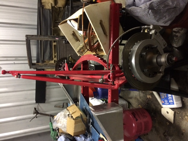

- Posts: 4694
Re: Hydraulic Front Brakes
If you put any brakes on the front wheels, be sure to beef up the suspension. The T is prone to losing castor by just bumping the front wheels too hard on a pothole or curb. Even the Model A had front brakes which just slowed down the wheels, but the back ones locked them up. Anyway it would be especially bad on a car with the radius rod bolted above the axle, but even on one with the rod bolted under the axle, it could cause a problem. If it happens, your car could suddenly veer to one side and pull the steering wheel right out of your hands. So be sure to add additional support.
- Posts: 7309
An innovative tinkerer in our club once fitted disc brakes to the front of his improved T. They were so effective that under a heavy application before a hairpin bend, the front axle stopped and the car drove on over the top of it. Perhaps anything on the front end needs to contribute to braking rather than become the dominant force.

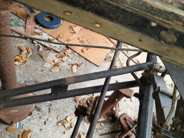

Charlie B in N.J.
- Posts: 790
- First Name: CHARLIE
- Last Name: BRANCA
- Location: Brick N.J.
- Board Member Since: 2010
Is it worth it? I mean I’m assuming you have them in the rear and can lock the wheels with them. Think about going in reverse and tearing the radius rod ball joint out & folding the axle over.

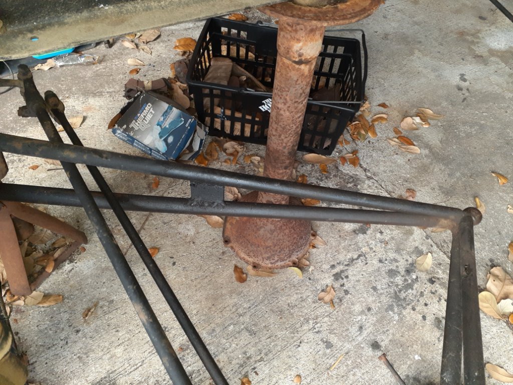

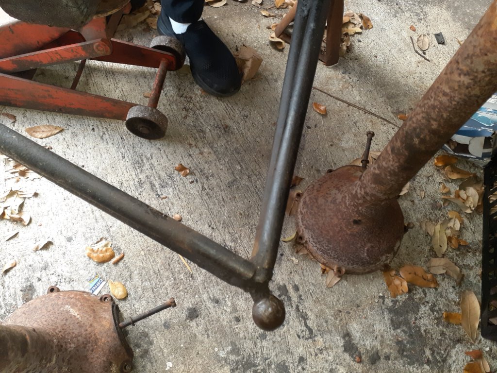

SurfCityGene
- Posts: 681
- First Name: Gene
- Last Name: Carrothers
On any thread about Front brakes on a there's always lots of comments about how the front axle will fold under or how the thin sheet metal pan will get bent.. There are a few of us that have T's with brakes on all four wheels. Ralph Ricks RIP aka RDR probably drove more miles with his T with front and rear brakes made from Metro hydraulics. He did two Great Races when his car was in the Speedster configuration and later converted it to a Picup as a daily driver hauling loads from Home Depot. We've done some panic stops for testing without any issues. On my '12 with the McNearney / Big Four front and Bennett rears I have not seen any distortion of the early pan. Last time I had the pan off the alignment was perfect at the fourth main.
I feel anyone who drives his early T a lot should have a double wishbone installed for safety! Of course adding brakes its a no brainer.
Thanks for reposting the links to past threads. There's lots of good info there.
