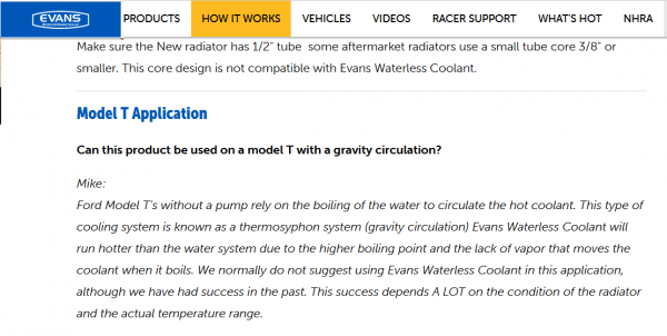

Terry, with all due respect, you need to do some more research on Evans coolant.
Even Evans discourages the use of their coolant in a Model T: "Ford Model T's without a pump rely on the boiling of the water to circulate the hot coolant. This type of cooling system is known as a thermosyphon system (gravity circulation) Evans Waterless Coolant will run hotter than the water system due to the higher boiling point and the lack of vapor that moves the coolant when it boils. We normally do not suggest using Evans Waterless Coolant in this application, although we have had success in the past. This success depends A LOT on the condition of the radiator and the actual temperature range."
When a manufacturer of anything claims it is the best there is, I view the claim with skepticism until I find evidence supporting their claim. On the other hand, when a manufacturer of anything claims it would be well to avoid in in my case and provides the reasons why, I'm inclined to believe them.
Lang's (and I'm sure others) carries this product and they state: "This waterless coolant allows engines to tolerate running hotter without boiling." Note - it will NOT boil; it WILL run hotter. Kudos to them for their forthright honesty (which I consider to be one of their trademark qualities). Considering that Evans' specific heat is around .65, or 65% as efficient as water, there is no conclusion to come to other than it is not suitable for a system DESIGNED for water (or as we typically use them, water-equivalent coolants).
OK, OK, I relent...at a 375F boiling point, perhaps there is someone on the planet that could drive a T to the point of complete melt-down. That would make for an interesting post and would not garner much sympathy from me...that would be an excellent example of getting what one deserved.
If someone is looking to cook their oil and deal with associated issues, this is the product for them.
No, they don't. The water begins circulating soon after the engine starts, and in a Model T that is up to specs it keeps circulating without ever boiling.

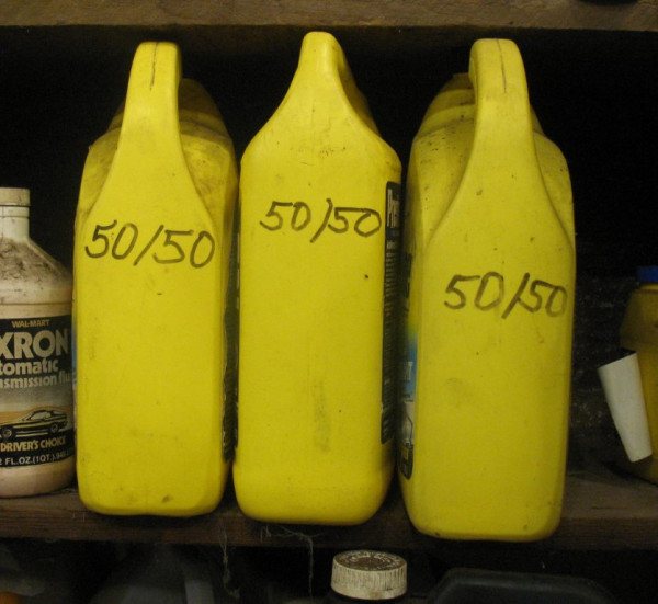

While it is easy to mix anti freeze in a pail as Steve suggests, the occasional top-ups are less easy to judge. Are you going to mix a batch each time? How much will you need? What do you do with the extra?
The extra.
- Posts: 1559
- First Name: Don
- Last Name: Allen
- Location: Houston, TX
Re: Ideal T antifreeze/coolant???
That's what I do as wellSteve Jelf wrote: ↑Thu Jun 03, 2021 2:42 pmWhile it is easy to mix anti freeze in a pail as Steve suggests, the occasional top-ups are less easy to judge. Are you going to mix a batch each time? How much will you need? What do you do with the extra?
The extra.![]()
1924 Touring

Topic author - Posts: 690
- First Name: Terry & Sharon
- Last Name: Miller
- Location: Westminster, CO
Hello Ladies and Gentlemen,
Thank you for all of your responses. I had expectations regarding potential replies. With the exception of about a half dozen posts, you did NOT disappoint me.
Thank you Bob Jablonski for your story. You have confirmed my expectations.
As was stated, Evans is up to 90% ethylene glycol. From the Evans web site, it is stated there will be a 6-8psi pressure increase when the coolant warms up to operating temperatures. This means the coolant expands to increase pressure. Expansion directly correlates to density. The hotter the fluid, the less dense it becomes. Thus, a thermosiphon flow has a great potential for occurring. Being as Evans is up to 90% ethylene glycol, it would appear it would work very much the same as a standard mix of ethylene glycol coolant. With the added corrosion package and the total lack of water, the corrosion resistance should be outstanding as compared to any water diluted products.
My plans are to completely rebuild the engine, add an aluminum head, add a new, quality, radiator, and am considering whether or not to add a water pump (most likely will since water pumps were a period appropriate aftermarket option). In understanding period appropriate water pumps, I find the clearances and impeller construction designs leave a whole lot of room for thermosiphon flow when not operating. Much different than modern pumps. My most important concern is galvanic corrosion between the block and aluminum head. I have experience with this type of corrosion and common prevention methods. Using an anode is problematic. The anode requires replacement on a regular basis and will leave corrosion products in the coolant that will foul the radiator and coolant passages.
It appears most of Model T owners have accepted technology newer than Henry used and are happy with it. I appreciate your comments.
It may be years before I will comment on how well my plans have worked out. This thread will be long forgotten by then. I expect to be able to write the same as Bob J. posted when that time comes. BUT, you can be sure I will post results whether the results are good or less than desirable for all to benefit from my experience.
