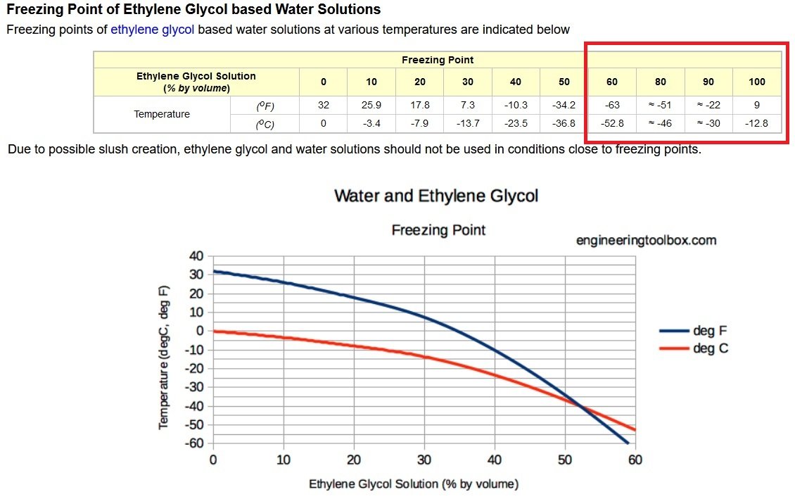

I have been questioned as to why I don't believe in the science of a 50/50 mixture of water and antifreeze. Well I do. The information I am using for a 100% glycol mixture comes from my father's library and discussions years back with him on engine rebuilding. During WWII he was an Army Air Force aircraft mechanic, later a machinist in civilian life.
A publication from 1939 has some interesting information on Liquid Cooled Vee Engines. Merlin/Rolls/Packard/Curtiss/Allison and others.One publication from 1939, Aircraft Engine Maintenance, Brimm and Boggess, pages 68 and 130-131 contains the following statement." Using a chemical coolant it is possible to permit an engine temperature to run as high as 350 degrees F." (but page 130, it is recommended not to exceed 250 df) The mixture of coolant is one part ethylene and one part di-ethylene-glycol (100% antifreeze?).
Nowhere in this publication was there a comment on 50% water and 50% antifreeze.
Safe operating temperature not to exceed 250 degrees Fahrenheit.
We have used the 100% glycol in a number of small engines, Renault, MG, Triumph. AC-AD3's, Packards of the late 1930-1940's and Ford 292, 351s. And Farmall. And in the1922 Model T Coupe.
I am not recommending this mixture, I am stating I (as well as my father in his lifetime) used this mixture with no major problems.

Too much water, it can freeze.
Too much glycol, it will gel.

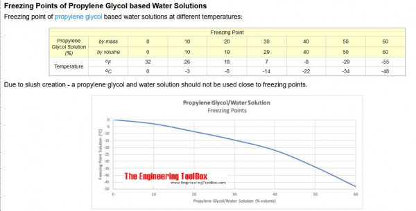

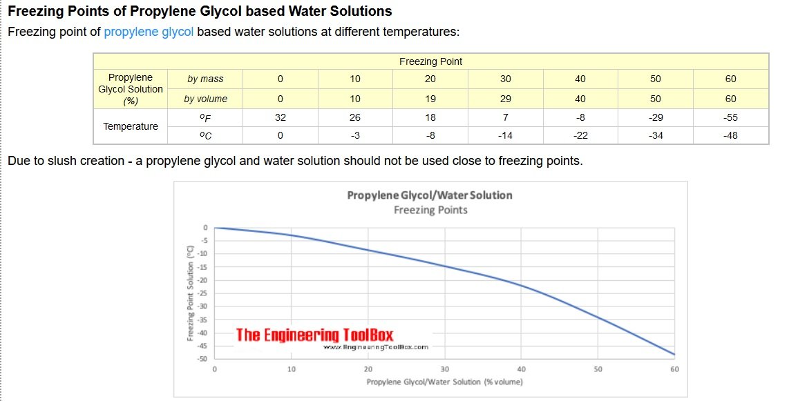

Facts:
The following temperatures were checked on several websites
Undiluted ethylene glycol has a boiling point of 197.6 ° C (387.7 ° F) and freezing point of -13 ° C (8.6 ° F).
Diluted ethylene glycol with 50/50 water, the boiling point is 107 ° C (225 ° F), respectively the freezing point of -37 ° C (-34 ° F)
Undiluted propylene glycol has a boiling point of 188 ° C (370.4 ° F) and a freezing point of -59 ° C (-74.2 ° F)
Diluted propylene glycol with 50/50 water, the boiling point is 105 ° C (221 ° F), respectively the freezing point of -32.2 ° C (-26 ° F).
Di-ethylene glycol has high boiling point and more viscosity so it is more benefit than ethylene glycol http://www.ijirset.com/upload/2017/janu ... YSIS_R.pdf possible reason for the mixture used in the Merlin
Safe operating temperatures (note the word SAFE not what is possible)
Merlin/Rolls/Packard/Curtiss/Allison not to exceed 250 degrees Fahrenheit.
Model T between 195 degrees and 220 degrees Fahrenheit
Decision in selecting a coolant mixture:
Should be such as to maintain a safe operating temperature - must be above the safe operating temperature.
Decision in selecting an anti-freeze mixture:
Should be such as to maintain a safe operating temperature based on weather conditions in the area's of operation - must be below the lowest recorded level.
Undiluted ethylene glycol has a freezing point of -13 ° C (8.6 ° F) caution in considering this mixture as an ant-freeze
Conclusion:
Everybody may be correct in their decision if their mixture is within SAFE operating temperature ranges for their area of use.
Charts from https://www.engineeringtoolbox.com/ethy ... d_146.html
