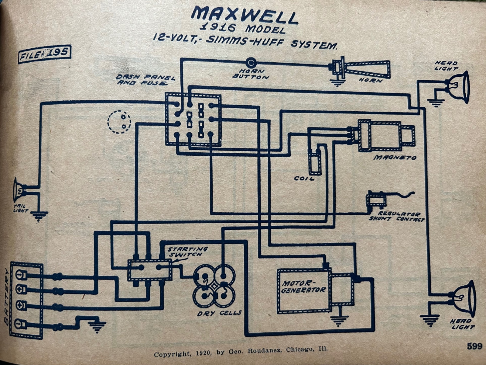

Re: Are there any rules of thumb on wiring gauges?
No such thing as a non-deliberately stupid question, I’ll take a crack at some answers to them in order:
Yes, the mag ignition is a separate system from the charging system. It is AC, Dynamo puts out 6 volts of DC.
Correct, to run the car with a mag ignition you have no need for the charging system. The dry cells and coil were required to help intensify the spark in the mag at the RPM at which the dynamo turned the engine. Not sure what that was, but you might be able to hand crank it faster? Sort of like how a Model T doesn’t like to start on mag using an electric starter, but will respond better to a good fast yank on the crank.
I assume that like many generators, the Simms-Huff unit will burn itself up without a load on it if ran a lot.
Yes? I believe you can ground out the dynamo by grounding the small post on the bottom, that is the charge output post and originally led to the regulator on the dash. The big post on top is for starting power. You could also unhook the belt from the dynamo’s pulley, and run a smaller belt to the fan only.
Yes sir, that or retard the spark and starve it for fuel is how I would kill the engine.

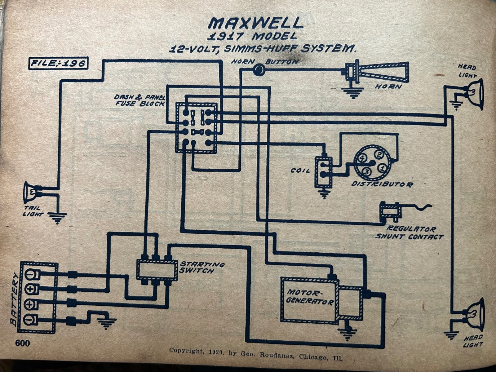

Here are some wiring diagrams that might help some, both the distributor and mag systems for same Maxwell.
