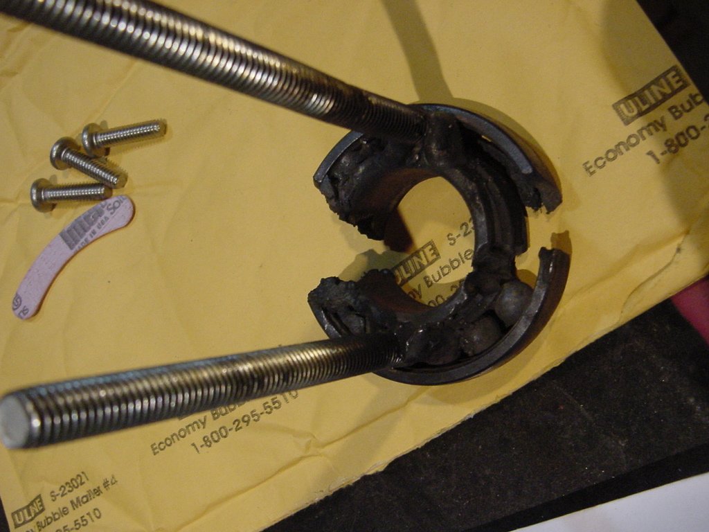

NOT a vehicle but it gets towed by 1.
1 of my neighbors I have always been able to depend on to help me if I really needed it called me 1 day last week and ask if I could help him fix his old mortar mixer. "sure". Turns out he was in the middle of a major job and needed it bad.
WOW, 1 day i will learn!
anyhow, the bearing was up in a pipe and there was no simple pulling to be done. THis is what I wound up with.
I welded 2 peices of threaded rod into the bearing and then had to cut it off the shaft and out of the pipe.Didn't scar either 1! I was LUCKY.

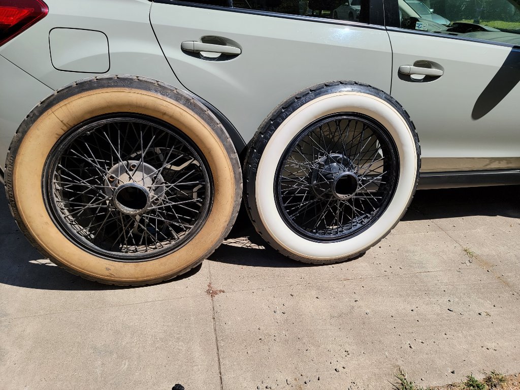

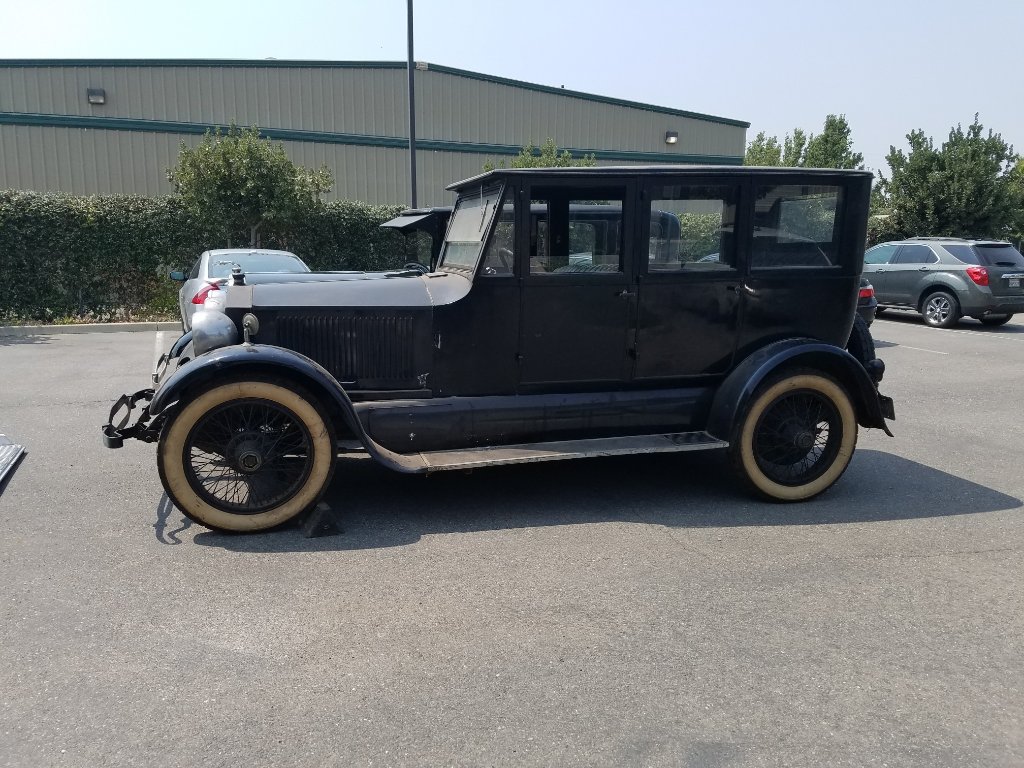

After a horrified look at what new tires would cost for the Stanley sedan, it was times to stock up on jumbo-sized jugs of Blechewhite and a new box of SOS pads

Dan, from my standpoint the discolored whitewalls are beautiful. Thanks for taking pictures before scouring them.

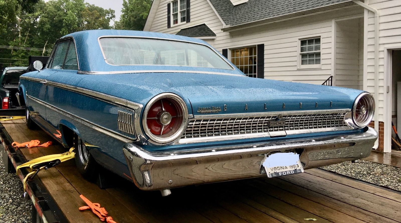

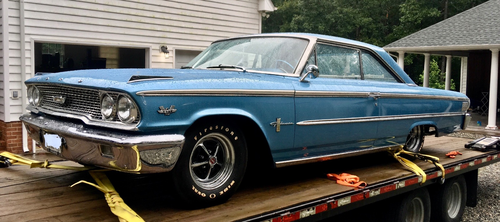

It’s been awhile since the last post. how time flys.
After the passing of my Father in-law, my family has been honored in taking care of his classic. 1963 1/2 Ford Galaxie 500. FE 390 4V 4 speed.
I went down to Virginia with our farm tow rig to pick her up. What a beauty! I will be going through all the maintenance and getting it set up in Maryland and back out on the road. First family outing will be somewhere that has ice cream.
Bryant

Thank you for digging up this thread Bryant. I’m glad the Galaxie is going to a good home. That’s a fine machine.

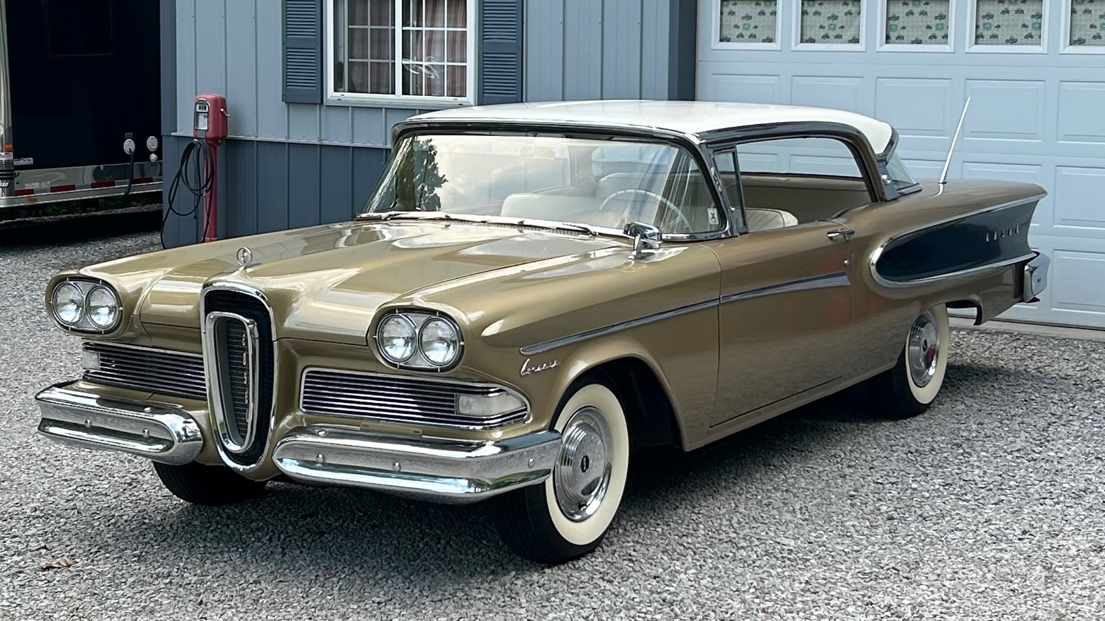

I will join in too, got a new Edsel and had to replace bent pushrods and unstick valves after a long hibernation.

good old Edsel
we had two here on the farm. a 58 corsair and a 59 ranger. both had FE 332 cid engines
what engine is in yours?

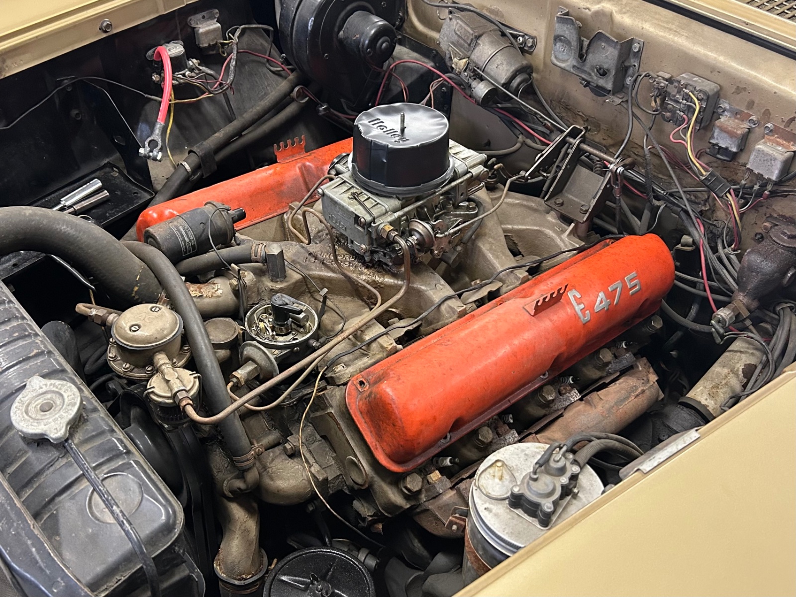

The ‘58 big cars had the E475, it’s a MEL 410ci 345hp
Can’t beat an Edsel! They are my favorite

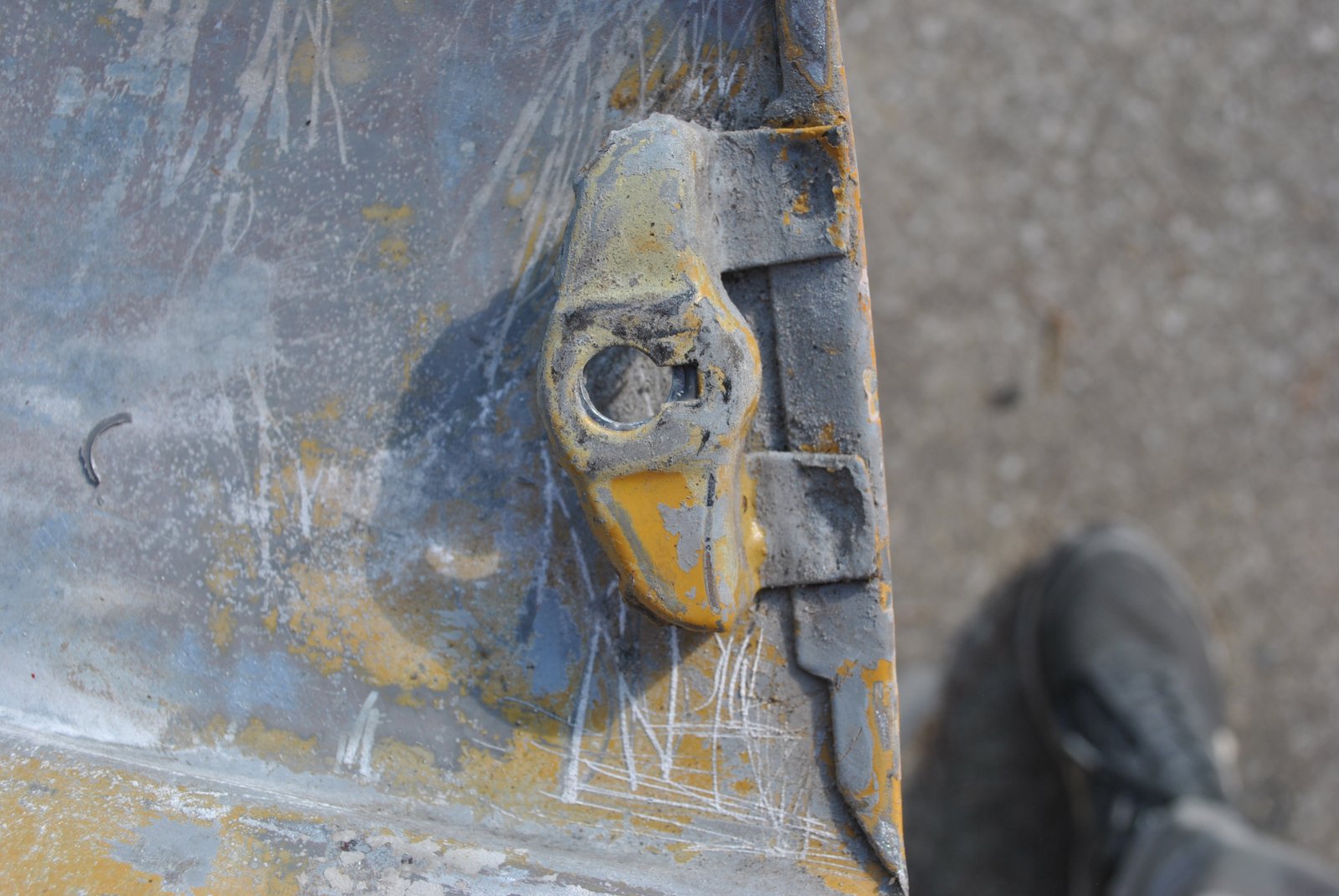

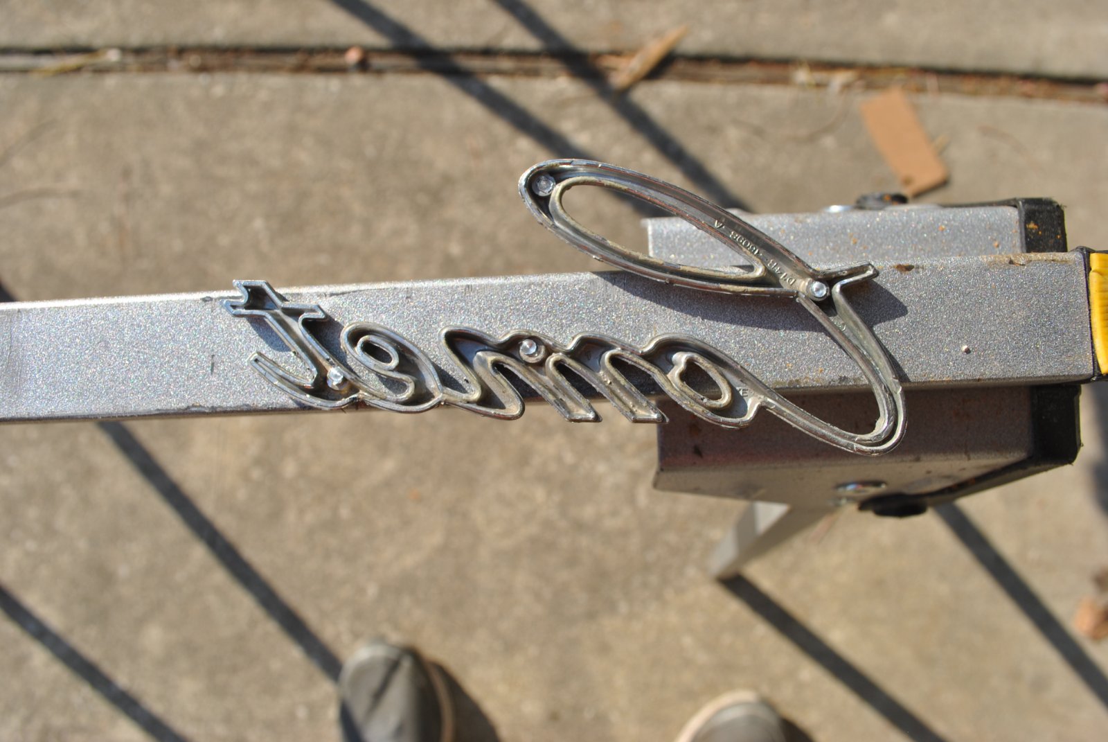

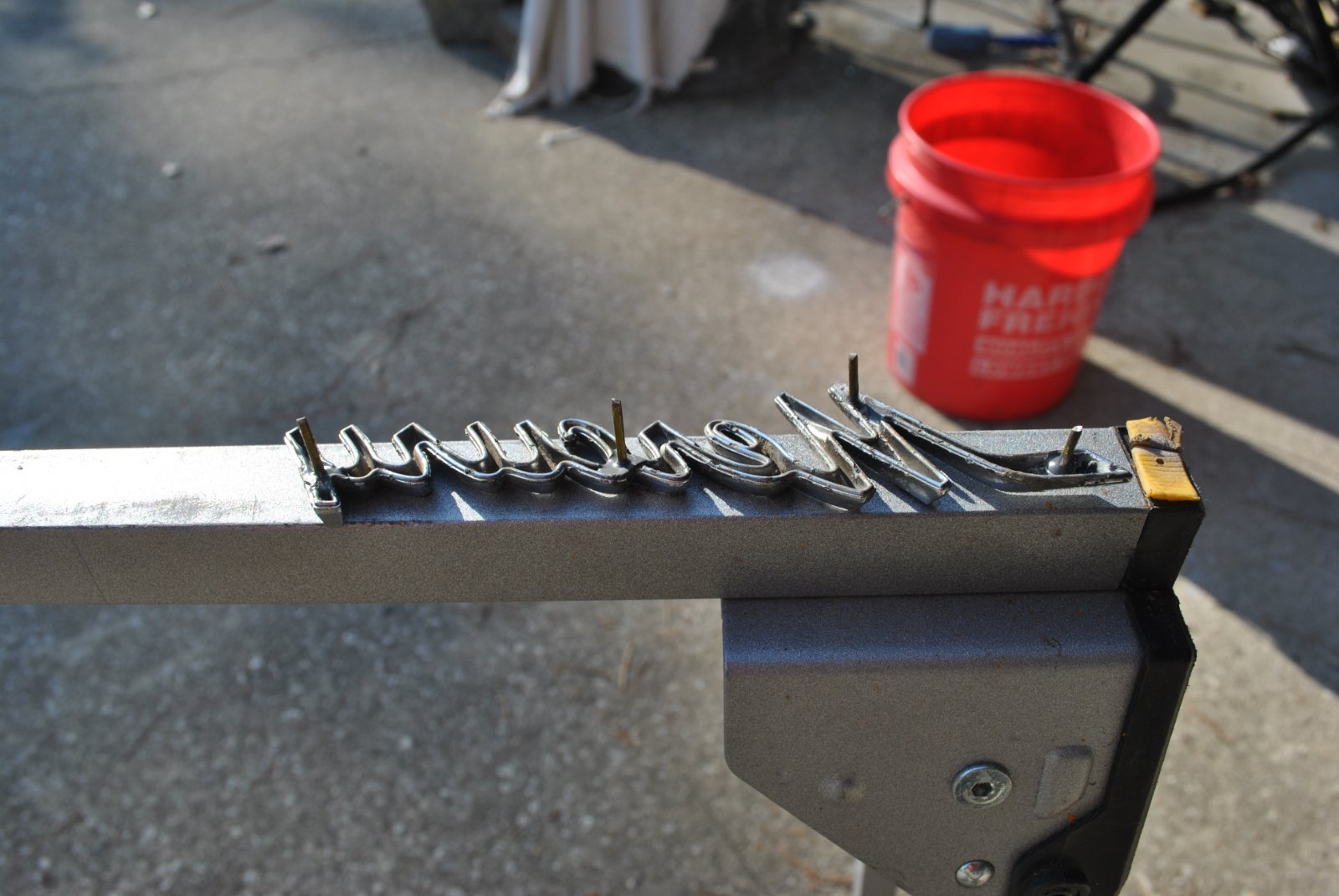

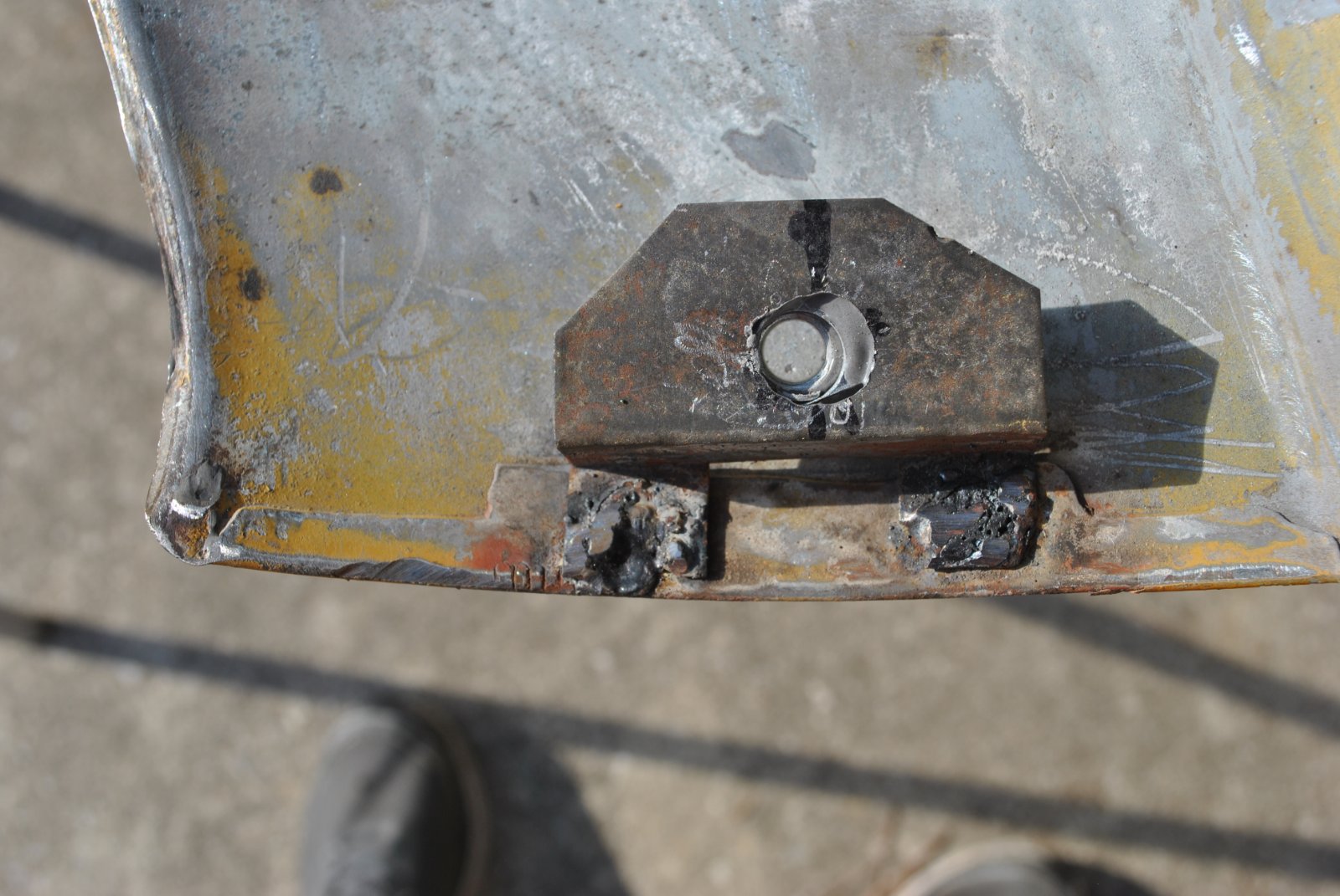

After almost 3 years I am finally getting back to work on my late wife's 1972 Mercury Comet. Here's where I'm at now.

Looks like your not to far off from driving it out of the garage and to a paint booth!
How many cubes are under the hood?
Got a color in mind?

Tadpole
Love the big cubic inches!
The valve covers are really cool looking
Bryant

Bryant Main color Blue The Back panel and lower body line Satin Black And Bright work will be powder coated Satin Black
Interior Powder Blue (She Choose The Colors)
302 (5.0l for the young guys)

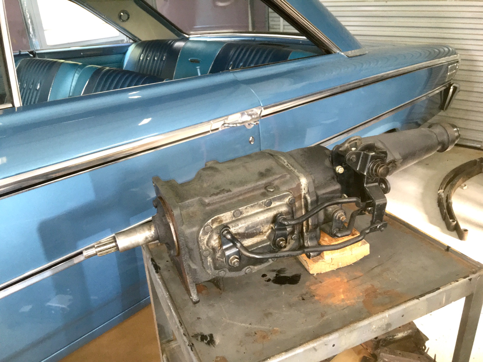

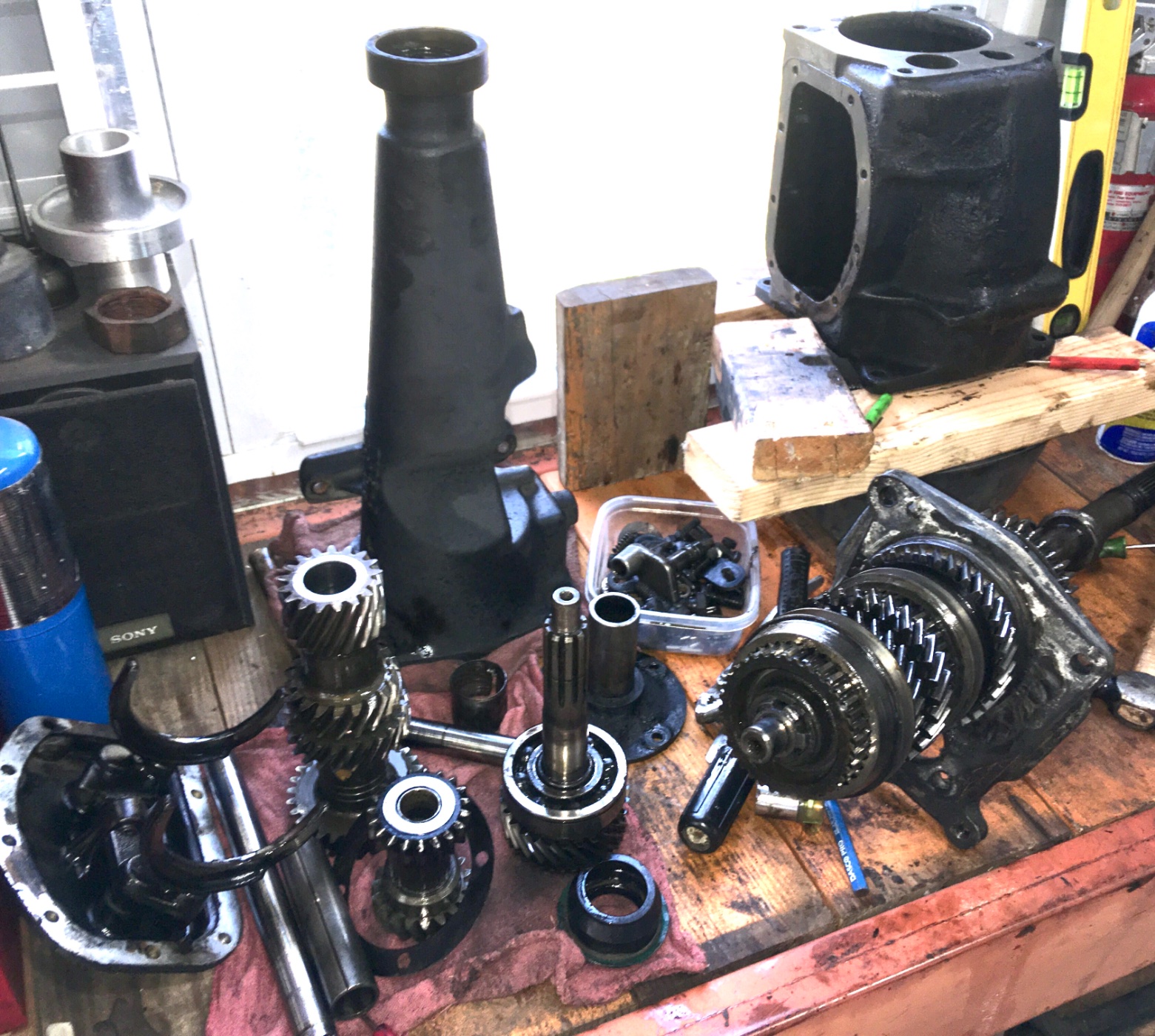

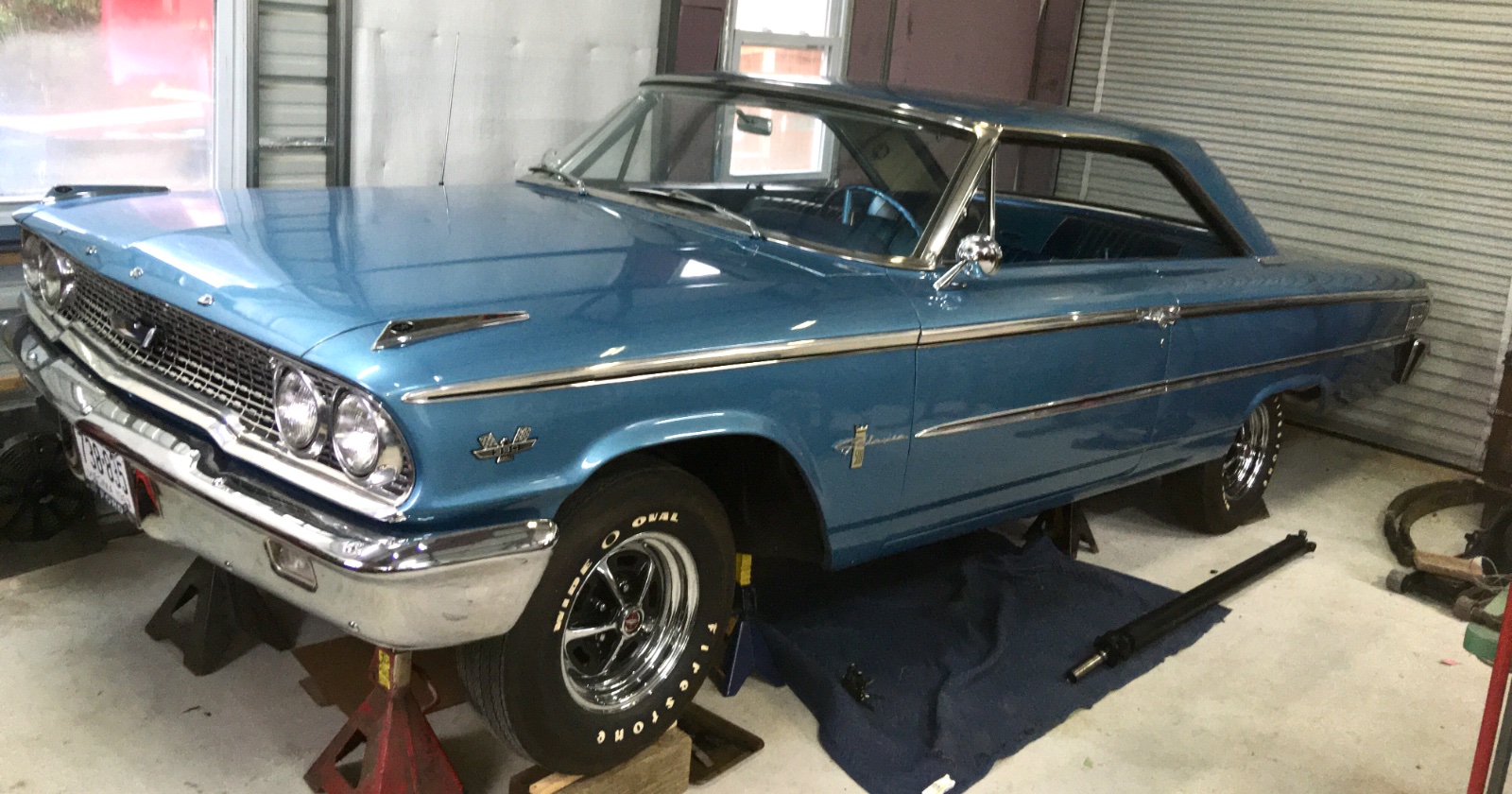

after a short drive I decided there was something off with the transmission. Popping out of 2nd gear sometimes and the speedometer cable was whipping between 0-120 mph like crazy! found the tail shaft bushing out. Really wrecked up the driveshaft slip yoke. Time for a rebuild. probably caught it in time. Things look a little wore out but definitely re-buildable. Between this and the Model T auxiliary transmission build I’ve been dreaming about gears….

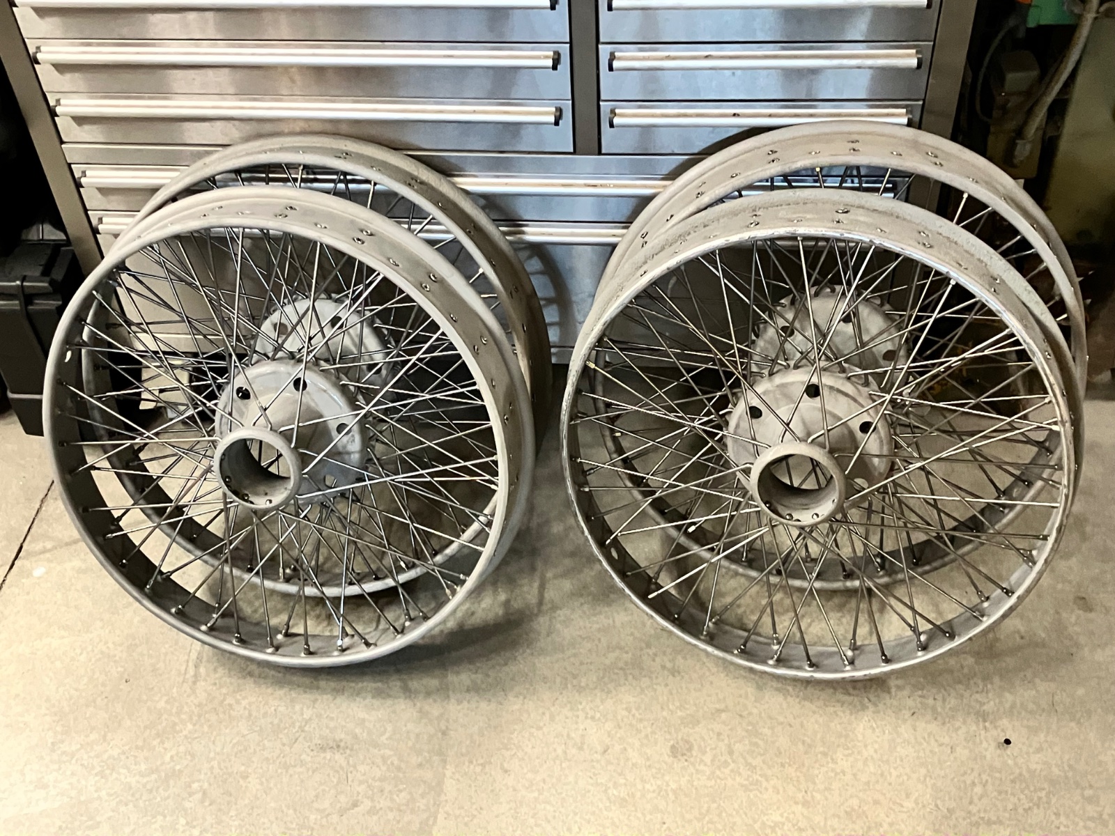

Rebuilt a set of #4 Houk, 60 spoke, 24” lock ring rim wire wheels for a 1919 Detroit Electric. Just need true and paint. Also made a new hub cap to accept an original factory accessory Veeder hub odometer and replacement steering column control grips.
Last step is to make new lock rings to fit the rims. The only fella in the world that makes these rings ran out of material, and won’t be making any more. Sooooo, I had some rings cut from 1” plate and gonna load em in the mill today. We’ll see how it goes…

While working on the 1972 Comet I found some broken parts.
The rear valance had a broken attachment which someone just drilled a hole and inserted screw
the badging had all of the "pegs" broken off and was reinstalled with double sided tape this is how I am trying to fix them takes patience of which I have very little!
