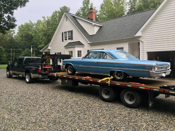

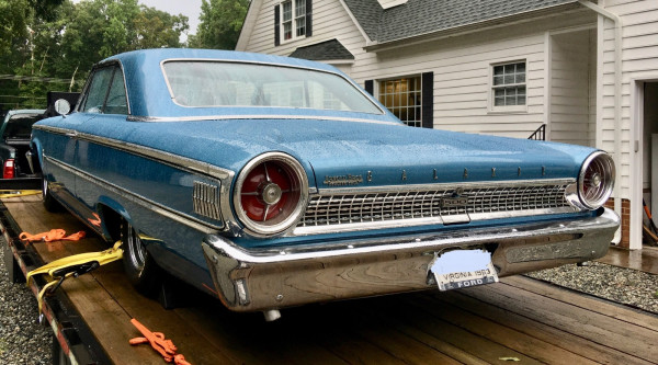

It’s been awhile since the last post. how time flys.
After the passing of my Father in-law, my family has been honored in taking care of his classic. 1963 1/2 Ford Galaxie 500. FE 390 4V 4 speed.
I went down to Virginia with our farm tow rig to pick her up. What a beauty! I will be going through all the maintenance and getting it set up in Maryland and back out on the road. First family outing will be somewhere that has ice cream.

Thank you for digging up this thread Bryant. I’m glad the Galaxie is going to a good home. That’s a fine machine.

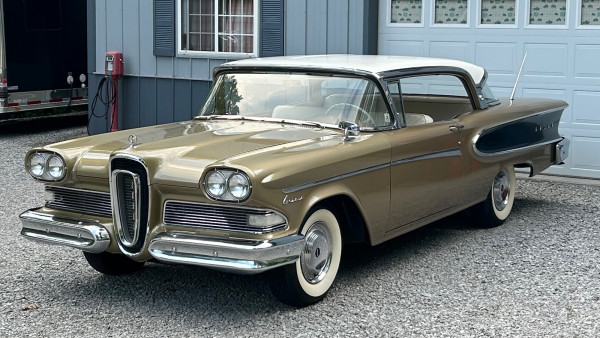

I will join in too, got a new Edsel and had to replace bent pushrods and unstick valves after a long hibernation.

good old Edsel
we had two here on the farm. a 58 corsair and a 59 ranger. both had FE 332 cid engines
what engine is in yours?

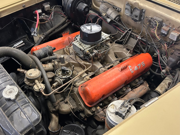

The ‘58 big cars had the E475, it’s a MEL 410ci 345hp
Can’t beat an Edsel! They are my favorite

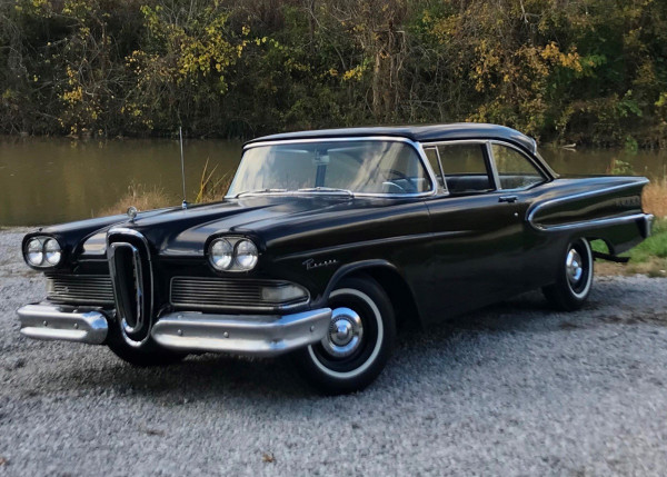

My '58 Ranger has the E400, FE 361ci 303hp

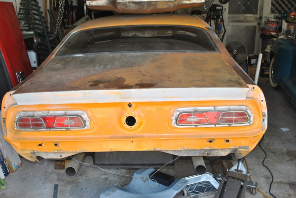

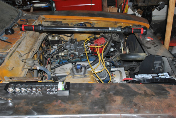

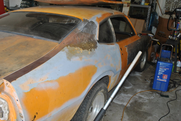

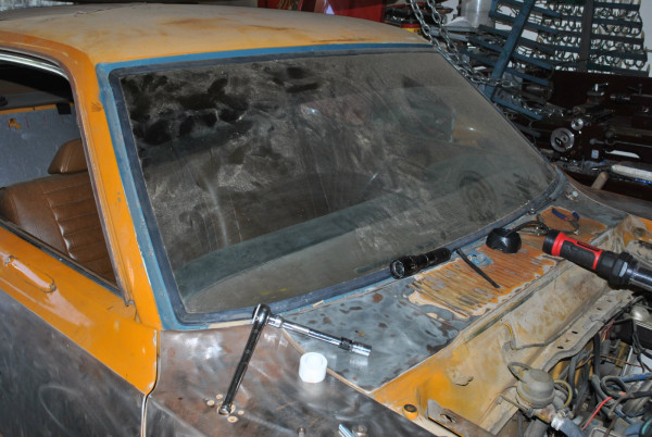

After almost 3 years I am finally getting back to work on my late wife's 1972 Mercury Comet. Here's where I'm at now.

Looks like your not to far off from driving it out of the garage and to a paint booth!
How many cubes are under the hood?
Got a color in mind?

Tadpole
Love the big cubic inches!
The valve covers are really cool looking

Bryant Main color Blue The Back panel and lower body line Satin Black And Bright work will be powder coated Satin Black
Interior Powder Blue (She Choose The Colors)
302 (5.0l for the young guys)

Those MELs were fine engines. If you can't get fuel to the carburetor, check the fuel pump pushrod. Vapor lock might be an issue with modern gas, too.

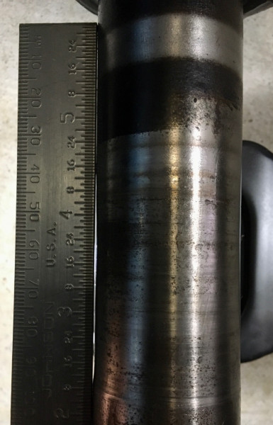

Post by Bryant » Sun Aug 10, 2025 11:32 am

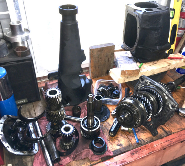

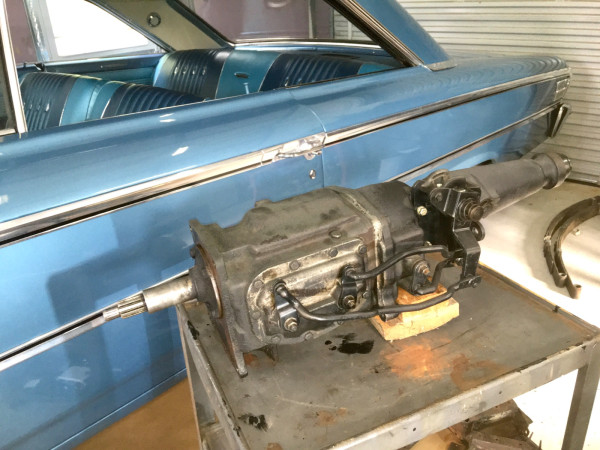

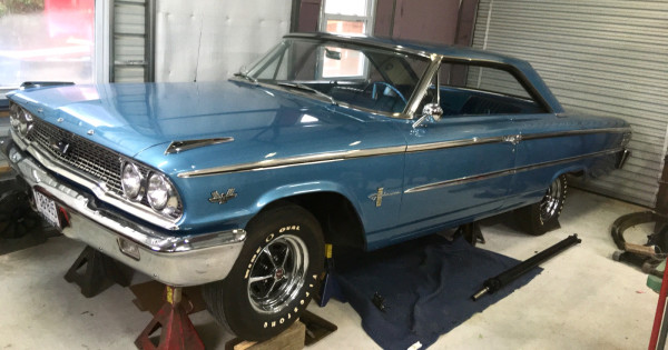

after a short drive I decided there was something off with the transmission. Popping out of 2nd gear sometimes and the speedometer cable was whipping between 0-120 mph like crazy!
found the tail shaft bushing out. Really wrecked up the driveshaft slip yoke. Time for a rebuild.
probably caught it in time. Things look a little wore out but definitely re-buildable. Between this and the Model T auxiliary transmission build I’ve been dreaming about gears….
