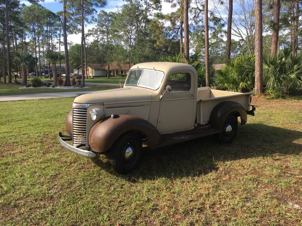

I have a 1940 Chevy truck that I allowed to sit to long and now the clutch is stuck, This happened last year also but it freed up quick just by warming up the truck and driving it with the clutch pedal pushed in. This time it didn't work. Any ideas on how to get to come loose?. Oh, I'm try to swap it off for a 64 to 68 Mustang for my wife if there is any interest.

So far I have tried just warming up the engine, Driving in circles in the front yard and jerking the throttle. I also tried jacking up a back tire and applying brake pressure but that so far has not worked, I'm soaking with WD40. I'm busy this weekend so next week I'm going to try and start it in gear and pull my modern truck down the road with while my wife gives some light braking. The bolt from the clutch assembly to the plate are easy to get at so I might like you said loosen them a couple of turns also. I'm certain it will free up, Its just stuck a little harder than last year. I keep the clutch blocked down with a 2 x 4 on the steering wheel. Next summer I will keep the pedal blocked down. Its interesting, I drove that truck just two months ago to show it to a guy that had a Mustang, The wife didn't like the car so we drove the truck home. That said we have had a lot rain in the last two months.
