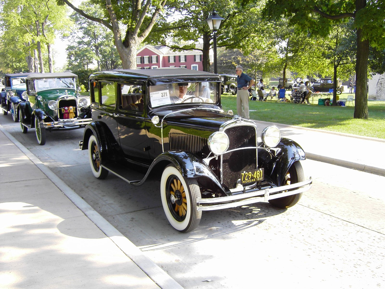

Here's me in my 1929 Dodge Brothers DA.
Yes, later and a 6 cylinder, but the pre-Fast Four in the '23 is a very reliable and underrated engine. Top speed is close to a comfortable 40-45 MPH, you can push it higher, but I wouldn't. Compared to the Model T, definitely a more "sturdy" feeling car and smoother riding, but not too much faster. Parts are available, not as many vendors and sources as a Model T or Model A, but parts are available and there is a good club with a news letter and guys that post regularly on the AACA Forum. The most difficult/troublesome thing that I ever had to contend with on a DB 4 cylinder is the starter-generator. A combined unit that works well, it is just getting it to the "well" point. The only other issue might be the radiator, but that is an issue with just about any antique car though.
Any trip you would venture in a Model T would be no problem for a '23 DB. If you are looking for something a bit faster, look later. The later Fast Four cars have a better engine, but are heavier and top speeds are about the same. Dodge Brothers started with hydraulic brakes in 1927. Any repair that you can do/undertake on a Model T, you can do on a Dodge Brothers as well. The DA in the photos will comfortably do 50-60 MPH (open flat road) with a 6 cylinder (60+ horsepower) and 3-speed transmission. The most difficult/expensive things on this car is the ignition (North East, right before the switch to Delco-Remy, a lot of one year only stuff) and the carburetor, pot-metal Stromberg U-2, we won't talk about that.

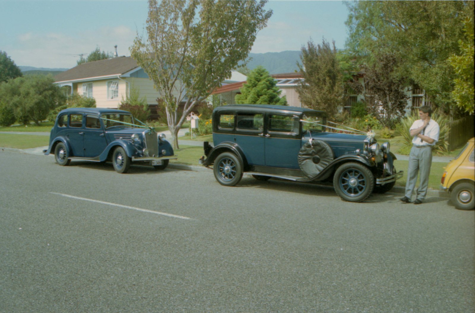

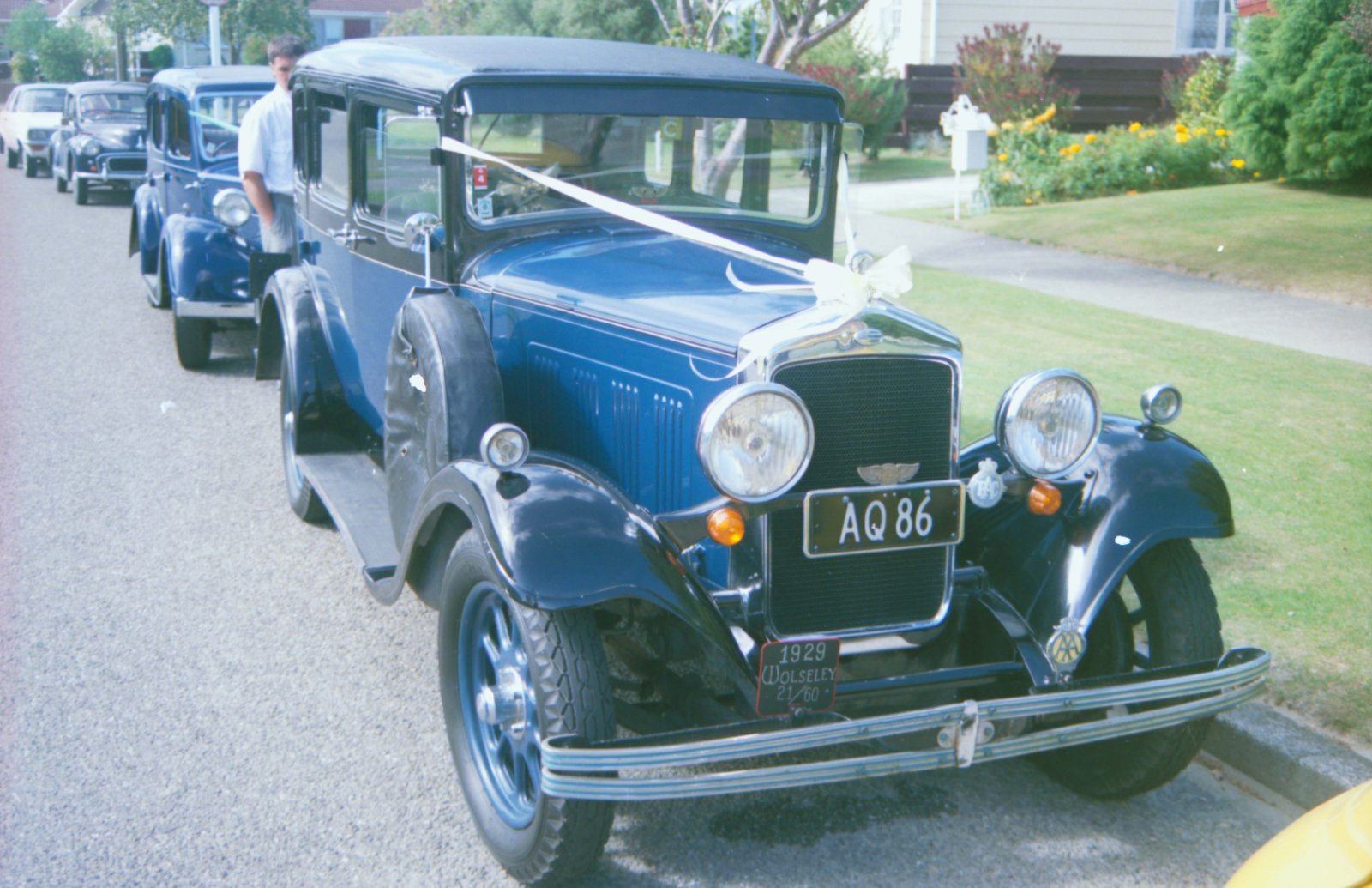

Hmmmm, well my father once owned a 1929 Wolseley Colonial. This was a large straight 6 engined car made by Wolseley of the UK (which was actually an off shoot of an Australian sheep shearing equipment manufacturer) with things like high ground clearance, large fuel tank, folding front seats (to make a bed in the car) and roller blinds on each window - all you need for long distance travel off in the colonies.
AND it was built around a '29 Dodge DA body..........
(The smaller car is a 1936 Wolseley which have owned since 1989)
