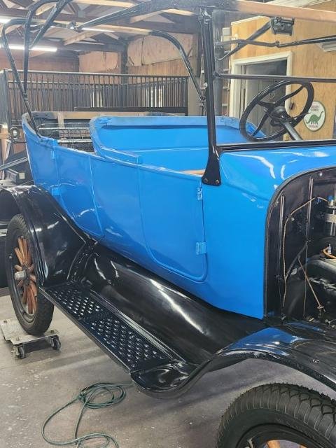

I had the same problem. I learned to do it myself and it is not that hard and 1/10 the price. Get a paint gun from habor frieght/home depot you can use rustoleum paint, just thin it with acetone a bit and a piece of sheet metal to practice on. Also, you tube videos are great and will get you there. Unless you are looking for a show car you will be happy. ..The black paint is rustoleum the blue I bought at napa. All painted in my shop/driveway
