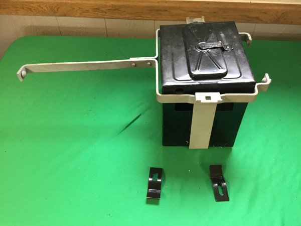

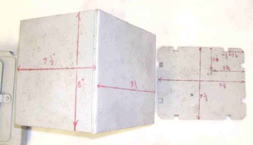

Not to hijack the thread, but I have a battery carrier from a Model T that mounts inside the frame rail just in front of the rear axle. Is the group 1 battery referred to by the OP the group that will fit this carrier.
I can measure the carrier and look up a fitment chart, but it may be common knowledge.
Also, an option for the OP might be to just measure your battery tray or carrier and head on down to WalMart or Sam's Club or a retailer that has all the batteries out on display and start measuring and looking at terminals. If it is a 6v battery, Tractor Supply is a good resource.
I have seen battery group size charts on the internet that give dimension, but do not know if they give terminal locations. I also thought available were top terminal lugs that screw into side terminal screw holes, making it not only atop terminal cable type battery, but would have them on the same facing front side. Might be another option.

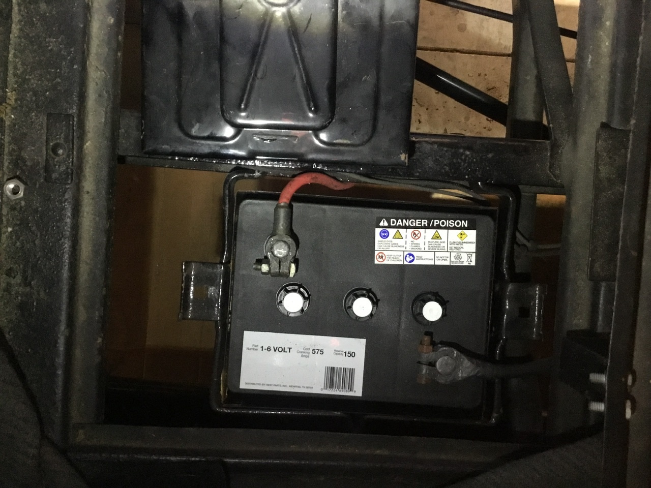

Not sure if this is group 1 or not. The she one, (dead) was in my car when I got it so I just picked up a new one.

It seems to be a 12v battery, it would have to be to have both terminals on the same side of the battery. Jim did not actually see his battery, hence the reason for his battery question. George

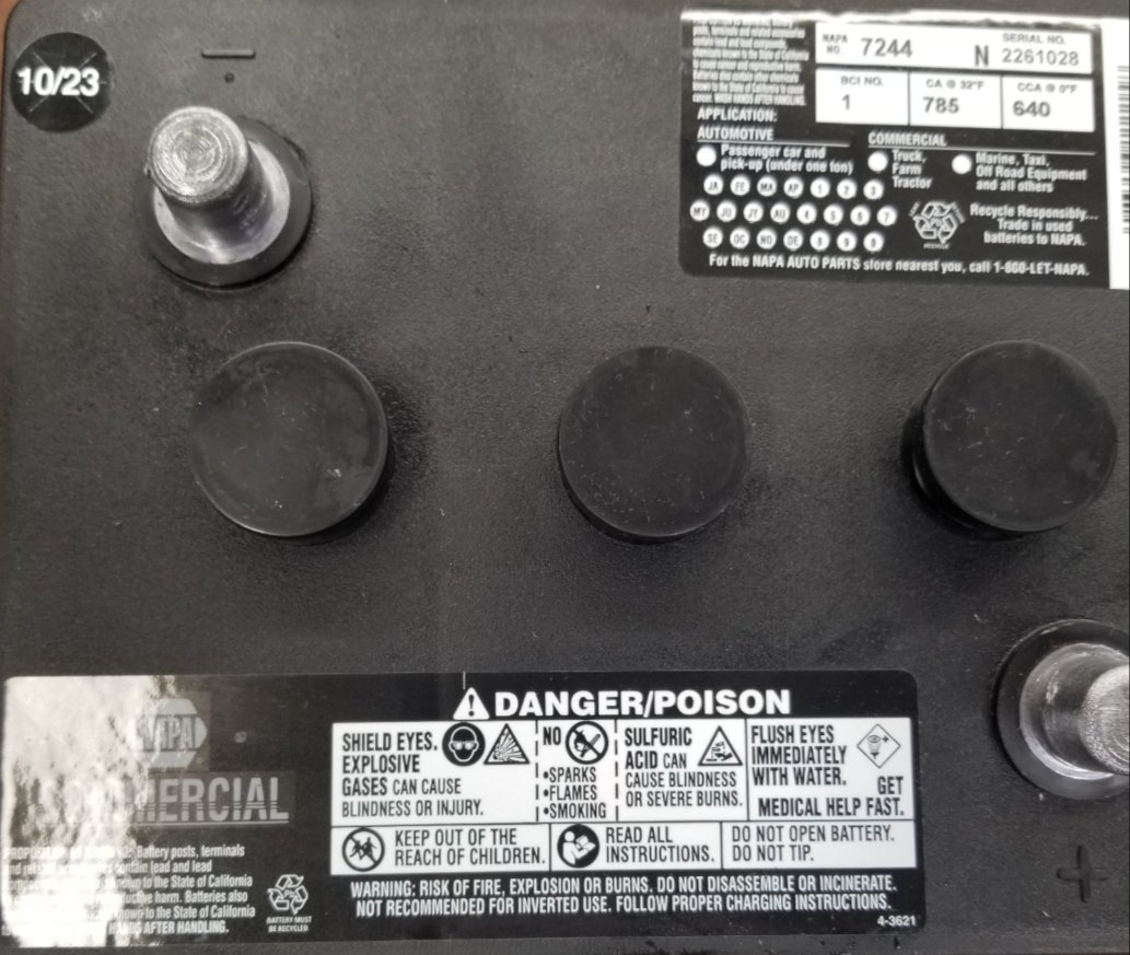

Re: 6 Volt Battery Size

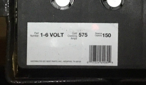

If there is a battery like that, “Auto Zone” would have it. They specialize in all types and sizes of batteries. I found a 6 volt battery with the terminals on the correct positions (negative on the near right and positive on the far left) at “Auto Zone” that fits perfectly in the metal Ford Script battery box underneath the trunk of my 1926 coupe. The battery box has the battery cable holes in the correct positions so, if you find a battery with the terminals on the same side, you will be unable to use a battery box. Jim Patrick

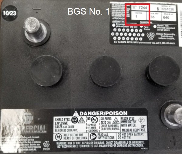

As requested, I have posted pictures of my Auto Zone Battery. The tag on the top says “Distributed by Best Parts Inc., Memphis TN 36103”
PS. The picture was taken upside down. The red cable is the negative ground, so with the picture inverted, the negative is on the near right.

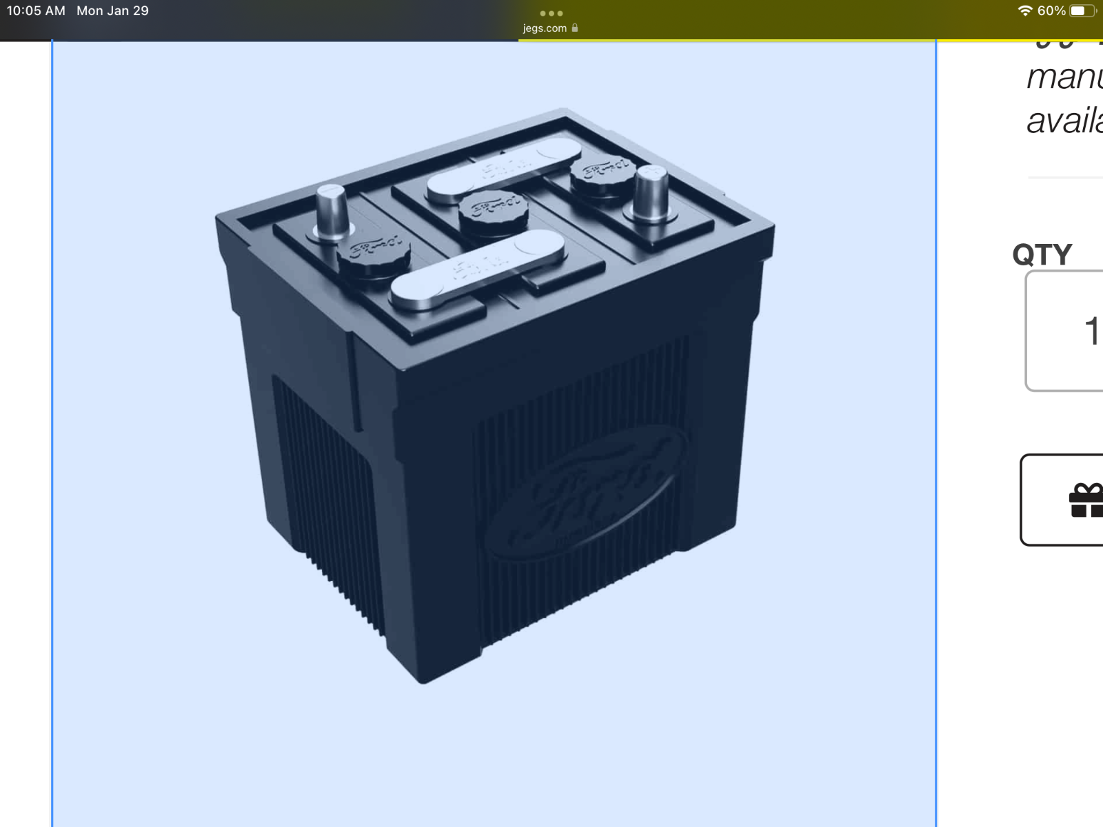

Yes! It would be interesting to see what that battery was used for in their battery information.

The battery in the photo above is 6 volt. Count the caps. Each cap or cell is 2v. A 12v battery will have six filler caps. Maintainance free batteries with no round caps is your guess. One thing I learned about maintainance free batteries is that you can carefully pry off the large square top and fill with water if needed and tap back on.

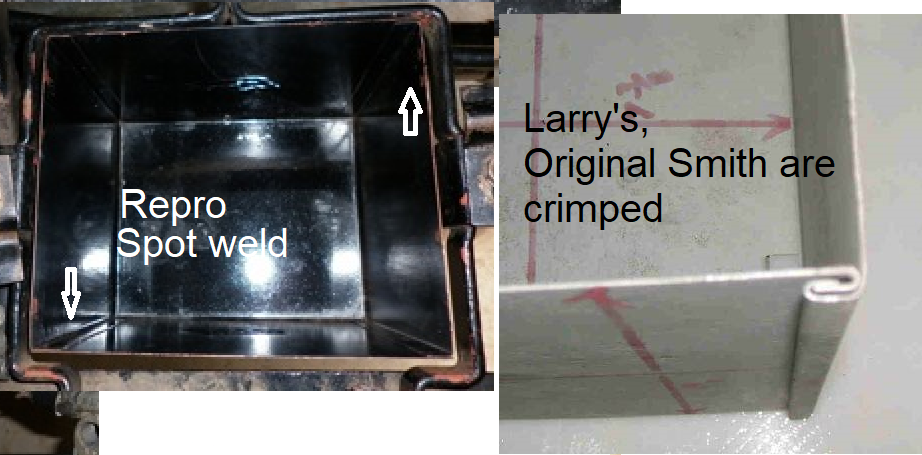

- Posts: 6577

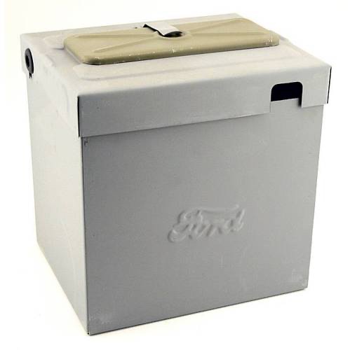

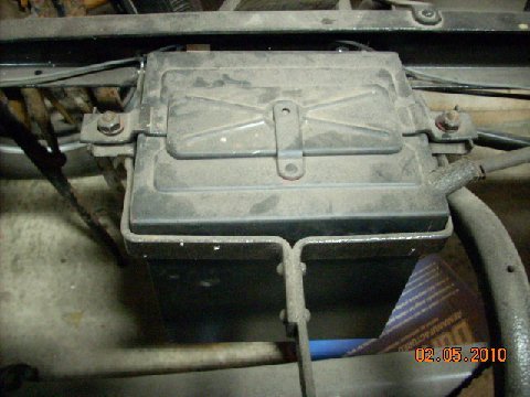

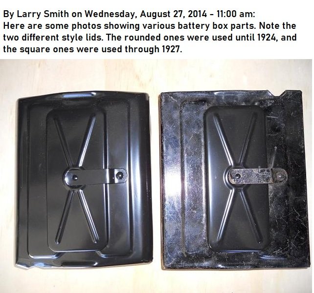

It is a Battery Group Size 1 battery --
If one has a battery box like this - size matters
The box lid allows for a bit more height
- Attachments
- 474425.jpg (38.27 KiB) Viewed 6690 times

I use the Auto Zone Group 1 6 volt. They usually have at least one in the store at one of the local stores in El Cajon. I have also ordered from Napa here in Alpine. and have to wait a few days for it to come in. I even bought one at an Auto Zone in Arizona on a tour we took there one year. I have been into Model T's for over 40 years and before that Model A's Both use the same battery except the ground on the Model A is Positive. Just turn the battery around for the A.

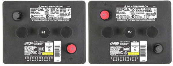

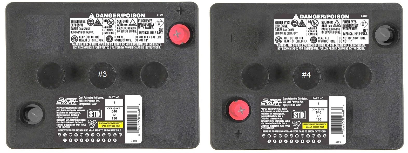

- Posts: 6577

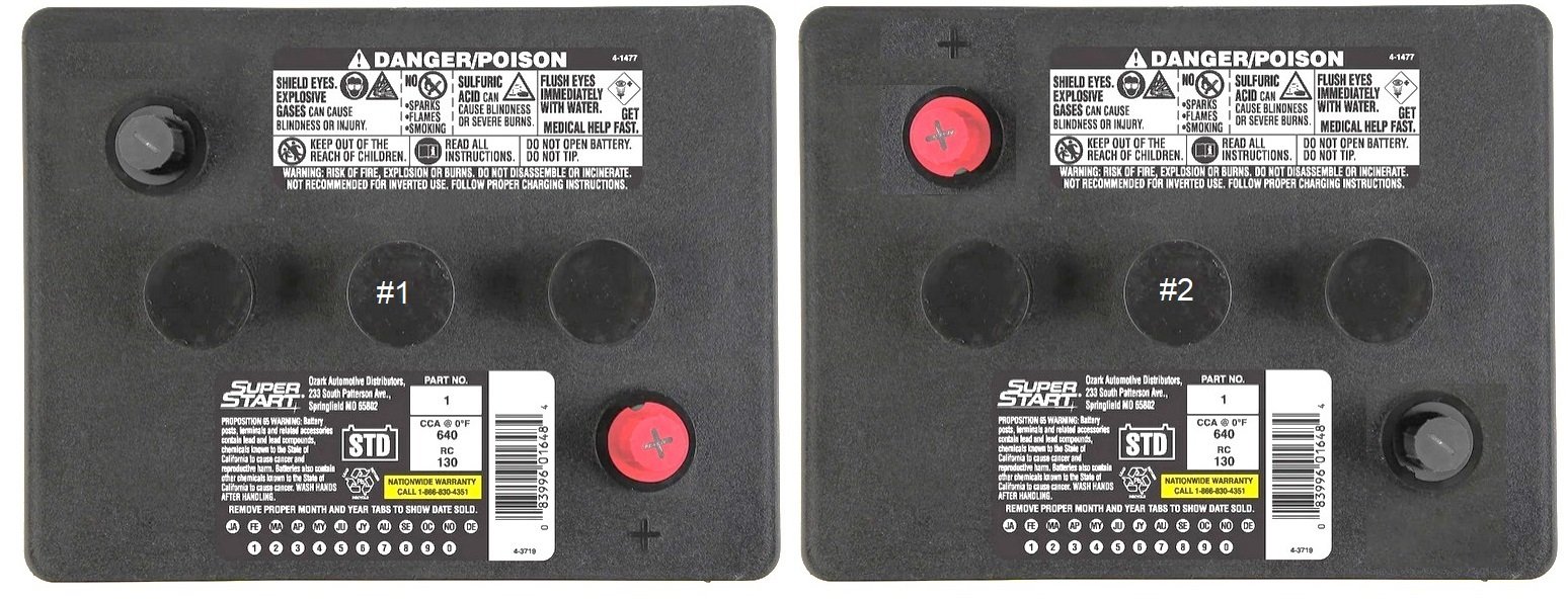

I understand the terminals are on opposite corners not in line. Like you I am confused with them being reversed. The pictures below show possible locations , I moved them to keep the labels the same positions & fool the eye into seeing a difference. So you can match them to your friends battery or take a picture of his/hers.J1MGOLDEN wrote: ↑Mon Jan 29, 2024 7:53 amA little more information still confuses me!
The battery is a 6 Volt type the same size as a Group 1 or very close to that same size.
The terminals are opposite and not in line, but they are reverse from the Group 1 battery shown above.
That is why my friend told me he had to remove the negative ground to frame cable end to a different location.
The lights, ammeter, and generator all function normally.
Later this week, I will get a photo and more information on the Group Number and manufacturer.
#1 & #2 have the terminals in the same position. If you ignore the labels & rotate the battery 180 degrees you'll see that. --
#3 & #4 have the terminals in the same position but reversed from #1 & #2 If you ignore the labels & rotate the battery 180 degrees you'll see that

Frank, great art work, but I have not seen the car, so I don't really know what the problem was, other than it was not a 12 volt battery with both terminals on the same side.
I should see the car this weekend.

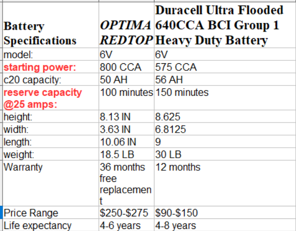

Have you thought of using an Optima 6v battery? They do have the terminals at each of the ends. The batteries are narrow & I pad them out with a block of wood to fit the carrier.
Paul

Different lids for how the box was made.
- Posts: 7259
Paul, I was wondering when someone would suggest an Optima battery. I would never use anything else nowdays.
i did once use a full battery box with the service lid as shown. My T nearly burned down with an electrical fault. Without a battery isolation switch, to disconnect the battery you have to unload whatever you have on the floor in the back seat, grab some tools to undo the nuts and bolts holding down the box lid, and then unbolt a battery lead. That close shave sees my battery box lid on a shelf in my workshop, and a battery isolator in that T. I suspect the lid caused grief when working on cars, just as the engine side pans do, and may be the reason originals are so scarce today.

- Posts: 6577
Information from the multiple Internet sites
What Are Cold Cranking Amps?
Cold-cranking amps measures the number of amps produced by a charged battery over 30 seconds at zero degrees Fahrenheit without dropping below 7.2 volts.
How Many Cold Cranking Amps Do I Need?
A good rule of thumb is that an engine will need about one amp per cubic inch of engine displacement.
Stock Model T engine spec says 177cu.in.
Do Cold Cranking Amps Really Matter?
Depends. Cold-cranking amps matter for those who need to start engines in climates where temperatures dip below freezing on a regular basis. Since cold can significantly impact the performance of batteries.
For batteries used in temperate or warm climates, you could ignore CCA and focus on other battery metrics like battery reserve capacity.
What is Reserve Capacity?
Reserve capacity is a measure of the time, in minutes, that a battery can run before needing to be recharged or replaced
Good info if your curious
Pros & Con's AGM Batteries vs Lead Acid batteries https://www.autonationmobileservice.com ... lead-acid/
Pros & Con's AGM Batteries vs Gel Mat Batteries https://www.bravabatteries.com/gel-vs-agm-batteries/
Pros & Con's Gel Batteries vs Lead Acid Batteries https://www.foxtronpowersolutions.com/g ... lead-acid/
- Attachments
- battery specs.png (131.43 KiB) Viewed 6176 times

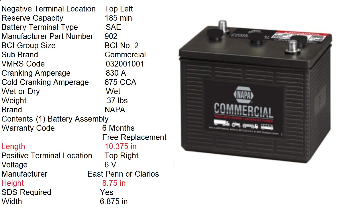

Has anyone fitted the larger group 2 battery into the Model T battery carrier?... What modifications to the carrier had to be made? The red top battery will fit diagonally in the Model T carrier with added bracing needed.
- Posts: 6577
Not sure why it would be needed
Length & height issues
