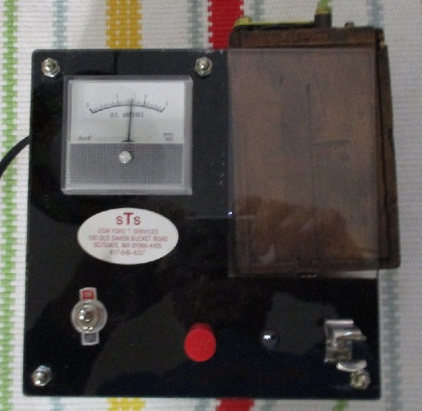

Picked this up at garage sale today for $1, so no big investment if it isn't what I think it is. Sure looks to be a buzz box tester. Google search for STS coil tester brings up an old listing for Mac's sellit it as a Model T coil tester, but Mac's is gone and the link does not upgrade to Eklers so I'm presuming this product is no longer being built or sold.
Anyone seen one of these? Anyone have one? And, more importantly...anyone have the instructions for one?
It appears to hook up to a xic volt battery, but don't know what the two fuse clip looking things are for. Spark plug?
I'll hang up and listen.

It is a Buzz Box Coil Tester.
Not an appropriate test device for Model T Ford ignition coils.

That box will tell you if a coil is bad when you see no sparks in the small hole.
The box cannot tell you if the coil has random misfires.
The box will also test spark plugs if you have a good coil to be tested at that time.
Those two little clips simulate the spark plug leads.
Those boxes come in two sizes, the larger coil size prior to 1912 can be tested in an earlier box.
Stafford is the name of the company that made and sold those boxes.

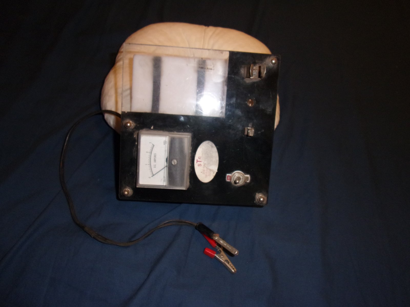

Do the battery leads clip onto a 6v car battery? Or a smaller 6v dry cell lantern battery?
Is the buzz box tester just a pass/fail? It sparks or it doesn't? Or is there a way to use this to find a matched set of coils?

The leads connect to a 6V car battery. An alkaline 6V lantern battery can also be used for short term use. I wouldn't recommend a cheaper carbon zinc battery in view of the current draw, although it will work to a degree if the battery is particularly fresh. Once the contact gaps are set, the coil vibrator tension is adjusted so the meter shows 1.3A.
It can be used for a pass/fail test in that the coil buzzes and sparks, and can be used to set a coil so the car is drivable, but will not provide the adjustment necessary for optimim smooth running, particularly for magneto operation.
It's the kind of thing to keep under the seat for emergencies, but not as an instrument to provide best possible performance.
And it's definitely not suitable for finding matched coils since it cannot show firing characteristics of the coil.

That STS is designed for the early coils and has the bottom coil connection slightly to the right.
So, the newer coils have to be set slightly off straight or the test set appears not to work.
You can see the col sparks coming of the termina and in the small window to the right of the red spark plug connector for testing those.
