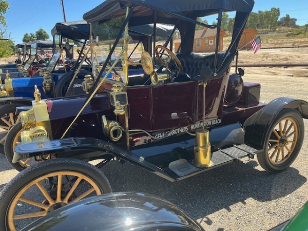

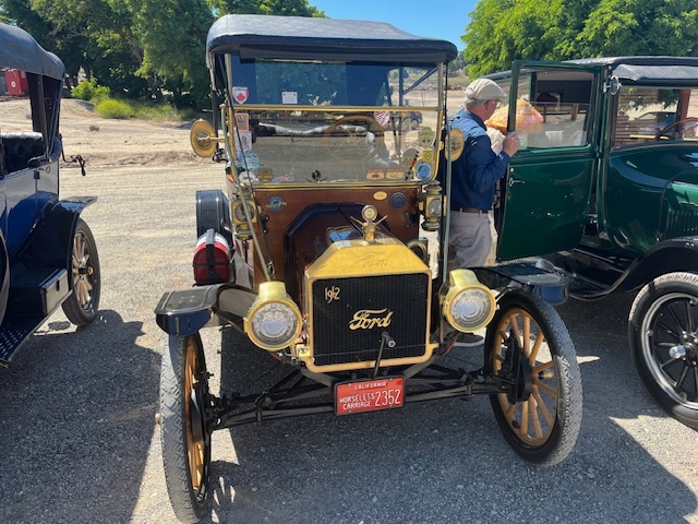

Just saw this for the first time at the National Tour in San Diego.

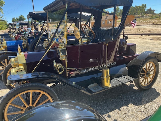

More pictures of the same car with front brakes. He passed us like we were in park today. I’m told the top speed is near 70 mph with a stock engine and Warford transmission.

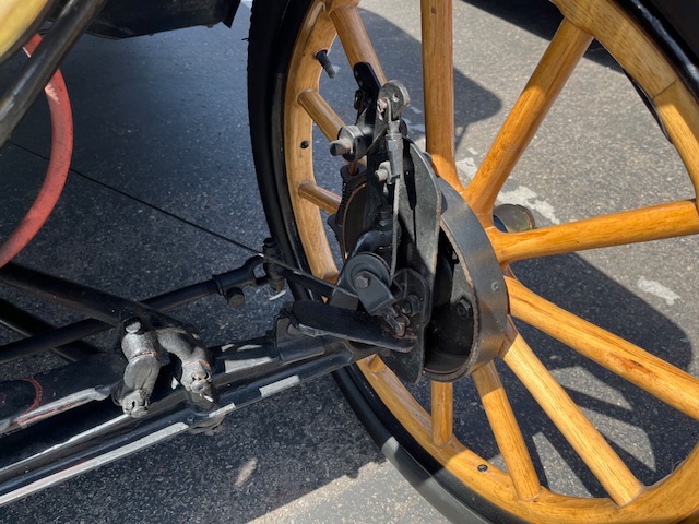

The pictures of the '12 Torpedo above was taken on the recent SD National tour and belongs to me. I purchased it back in the early '70s and have driven it on many tours.
My best friend and neighbor Ralph Ricks RIP had four wheel hydraulic Nash Metro brakes on his brass PCup/Speedster made by Orville Ernhart from Long Beach and they worked comparable to a modern car! RDR required buckling up to ride with him. RDR was a strong proponent of Front wheel brakes.
Many years ago I first installed a set of Bennett outside brakes on the rear of the Torpedo. I saw patent drawings of the McNearney and also the Big Four brakes from back in the twenties and thought I could make some using ideas from both companies.
The picture posted above is what I first ended up with and had always wanted to make a couple of improvements. Now after many years and miles and the second set of linings I'm still running them and have had no problems with them. I run an equalizer system and have backed off my tranny brake band slightly. A cable system connects the front and back with the rods operating the inside shoes on the small drum rears. Initial set up and adjustment is a nightmare but with an assistant and then some driving everything seems to wear in to a happy balance.
It's not perfect but a sort of a period correct look and does perform better than original design.
