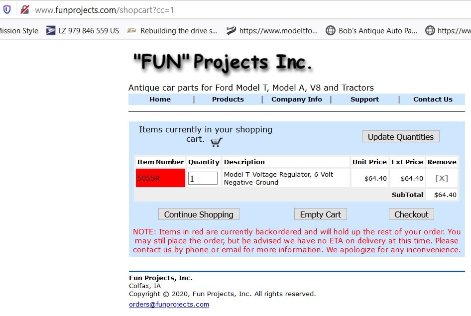

Why do you think you can't use it? Doesn't look like they are available yet sourced from Birdhaven (owns FunProjects & Texas T now). Bob Bergstadt had one awhile ago, likely sold it. There was another brand is sold through Snyder's - looks like its no longer available. It claimed up to a full 20amps output but MTFCA forums says never more than 12 amps or burn up your generator - output is controlled by the third brush in the generator so it can be used

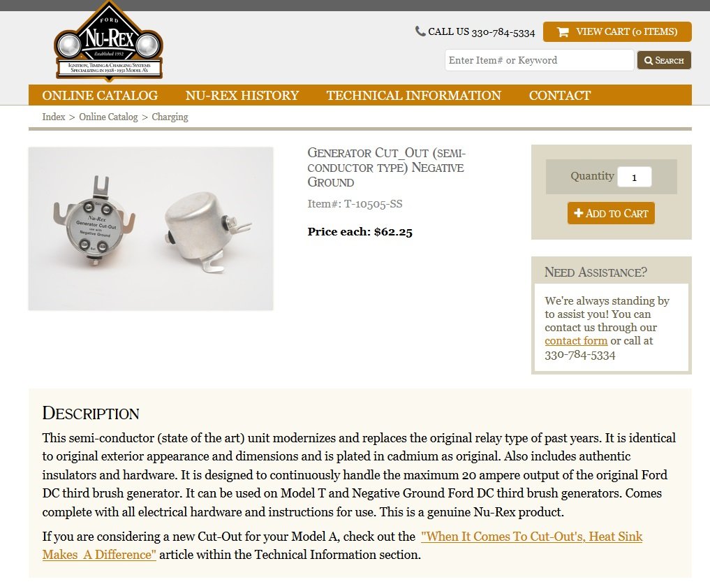

Not sure if they still make them. This is the one that puts out "up to" so amps but you should set the 3rd brush between 10-12 amps jus the same as Fun=Projects https://www.nurex.com/generator-cut-out ... ive-ground

The Nu-Rex Generator Cut Out (Semi-Conductor Type) js NOT a voltage regulator. It does not "put out" up to 20A; I believe it is just a Diode cut out capable of passing up to 20A of current through it which is apparently the same current ratings as the original cut out contacts. The FP VR is a completely different product with much improved functionality.

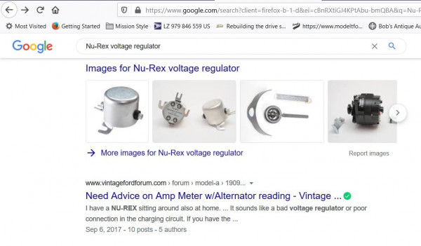

You are correct it is just a cutout I got GOOGLED bad. Like so many search engines they provide unwanted alternatives mixed in with what you asked for. I should have caught it. Sorry for the misinformation Frank
