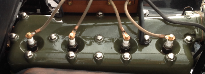

Only “seat of the pants dyno" to go by here.
Installed Prus head on my ’26 runabout 2 years ago. No modifications were needed. Can maintain 35 mph on hills I used to have to shift into Ruckstell. A noticeable improvement in performance all around. Engine runs cooler. No problems with ignition knock. Head weighed in at 12 lbs. The cast iron head weighed 28 lbs. Even adds an additional quart coolant capacity. Like Tony B. noted, gets better mileage as well. My engine does have an EE crank. A happy camper. :)
