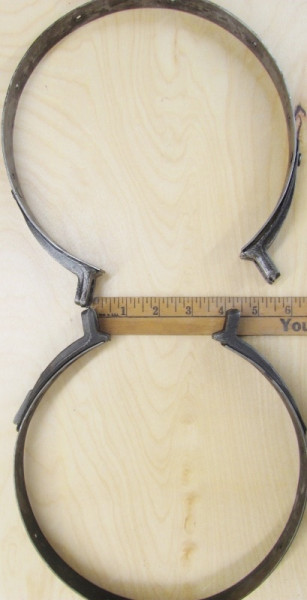

First check that you fixed any out of round band. The proper way is to bend over a dia. of a drum or something and get the circle round so that before you re-line the band, the lugs are approx. 3 1/2" to 4" apart. That ensures you have round bands.
Bands that are not ready for re-lining, note how wide apart are the lugs.
These are ready
These are ready

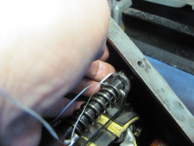

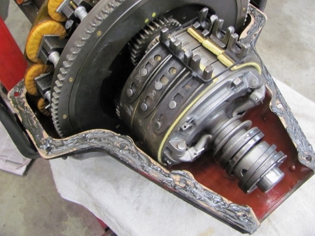

The transmission drums are 7 1/2" in diameter. The shape of the band does impact the way the lining grips, so yes, I try to get the steel bands into shape by wrapping around a drum, and tapping with a ball pein hammer to get the band as round as possible, that ends up with around a 4" gap at the ears.
Since you have them re-lined, should be able to fit them anyway. Check first that none of the bands are riding on each other's edges, and they wrap pretty straight around the drums. Then use Vise Grips or some means to draw the ears to appro. 4". As you said that breaks the wire, go with heavy plastic type straps, the thicker ones. I use two, as the length isn't enough, so I loop two together. Those straps are tough. Should hold.
Then when you get the hogshead on, clip the plastic to withdraw. If a tiny piece should fall to the crankcase, its only plastic and not steel wire, so injury to the gears is so minimal if any.
Band ears wrapped in plastic wire ties
Finally, when you fit the nuts over the pedal shafts, use methods to keep from dropping a washer or nut! Some like to place the springs and washers and nuts on the reverse and brake shaft prior to fitting the hogshead, so all is done in one placement. That works, but normally I like to do the springs, washers and nuts separate.
Dental floss to keep from losing stuff into the abyss!
Then with the hogshead seated, BUT not bolted in place, remove the plastic tie wraps.
Then proceed to completely seat the hogshead to do the final bolting, BUT, also fit the inspection cover with a couple of screws before you grab a handful of bolts and nuts for the crankcase to hogshead! You don't want to drop those either!

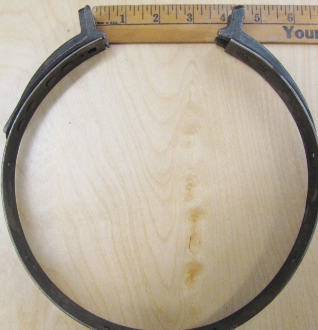

Here are some pictures of my bands. When I put these on the transmission drums I can easily squeeze them together to 3" outside to outside of band ears. To fit the Langs band installation tool I need about 2 5/8". its the last 3/8" that I can't get. f I use the plastic tie wraps as suggested it should work without using the tool or at least I think it might. Tomorrows job !
- Posts: 6804
Re: Problem Installing Transmission Cover
William
Two things:
1. try your best to get those rivet ears doubled over and sunk deep into the lining. If they are laying on top they will be worn off pretty quickly
2. Forget the band tool. Once you get the bands to close enough to get the tool installed, you will find that it is permanently trapped inside the hogs head, never to be removed again. They are a cruel joke and it is hard to believe anyone still sells them.
Two things:
- Posts: 7293
William, those rivets need to be pounded home as Scott suggests. The tangs need to be well below the band surface. The fact they are not may well be why you cannot close the gap at the ears enough to fit the tool. The zip ties are a very good alternative clamp.

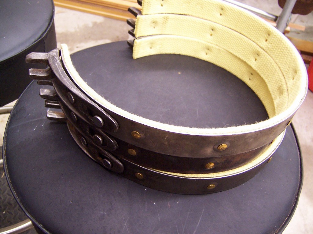

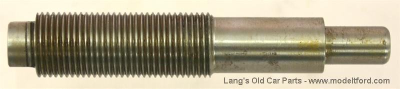

I am reviving this thread to ask for help again. I got the original problem solved with the suggestion to use zip ties to hold the bands in place. Now I am very confused about the low speed pedal shaft arrangement. This car had bands with removable ears when I got it. The pedal shaft has the stubby end sticking out of the low speed notch as seen by the yellow arrow in the attached picture, The adjusting screw (red arrow) looks to me, like the type used for non-removable bands, Then there is a third piece (Blue Arrow). The left end has a "head" that rides against the slow speed notch as it slides on over the stub end of the shaft. The spring goes over the third piece and the left end goes inside the adjusting screw. Is this correct ? I didn't think there was supposed to be a third piece. Is this somebody's alternate way of modifying things to use the bands with removable ears or is something broken and need to get a new pedal shaft or adjusting screw ?
I am just getting back to work on the "T" after going through Lyme disease. Not too bad except for the extreme fatigue, Work for 15 minutes then rest for 4 hours. At first I thought it was because I will be turning 80 later this year. But then a trip to the ER to find out I had a tick buried deep in my right arm, causing Cellulitis and Lyme Disease. Took a bunch of antibiotics, now I am recovering and doing much better.
bill goodheart
Topic author - Posts: 59
- Joined: Sun Jan 06, 2019 9:37 pm
- First Name: William
- Last Name: Goodheart
- Location: Edwards, ny
Sorry !! I forgot to attach the picture. Here it is
- Posts: 6804
You can mess with that, as it looks like someone made a stub to go into the hole of the original (now incorrect) adjuster bolt. Or buy this:
from here: https://www.modeltford.com/item/3419B.aspx
Mark Chaffin
- Posts: 4847
- Last Name: Chaffin
- Location: Lake Elsinore
Your demountable bands do not appear to be Ford factory bands. The ears also appear to be thicker which would add to your interference problem.
- Posts: 4089
Mark is correct
Those bands are aftermarket, and the long tube like device is made to fit into the #3419 hollow adj. screw to serve the purpose of the later Ford design #3419B 'stubby' adj. screw. Your bands were made before the advent of Ford demountable bands. So the mfg. came up with that item.
See similar device in middle of adv. below:
- Posts: 6804
Mark
good catch
Dan
I wondered where that stub came from...I figured it was not something ginned up in a home garage
thank you both for great observations

Mark: Thank you for noticing the bands, that explains a lot of the problems I was having. Dan: Thank you for sending that old advertising for the non Ford bands, they look exactly like the ones I have. Now, what should I do about it? If I buy the adjusting screw, discard that tube shaped thing will these bands still work ? Or, will the thicker ears still cause problems? I expect the best answer is to find a set of the Ford bands as well as get the correct adjusting screw for the removable ears. Does anyone have a set of the Ford bands (Narrow brake drum) for sale, for me the best thing would be to find a set all relined. Thank You Everyone.

My opinion and it is opinion only: those bands were made to fit in a later hogs head, pre-Ford removable band design (almost certainly won't fit in an aluminum hog's head, though). Understanding what the designer intended, I don't see why they won't work when properly installed, though with the thick heads, you may not be able to use the "Best Quality" springs, as they may coil bind once band material "sets" and compresses a little.

After looking closer at the band ears they are thicker than the originals. That would definitely be an issue getting them together. I would find some original Ford bands and make it an easier job to do for you and the next owner.
