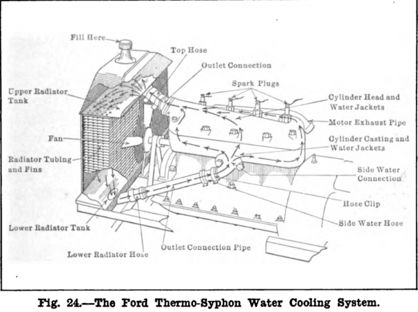

Are you sure you need the water pump? Perhaps the stationary pump impeller is blocking the natural thermosiphon circulation of the coolant after the engine is shut off.

I wholeheartedly agree with Mark. As long as the engine is running and the pump is pumping everything is fine. When you shut off the engine the thermosiphon system would ordinarily continue to work until the engine cools down. The not moving pump prevents this proper operation.

the coolant is still trying to absorb latent heat, is rising through the block and will naturally spill over into the radiator where it will cool and sink. Be thankful that your system is working efficiently. With a new radiatior and flushed block, the waterpump is making YOU feel good, not the engine...when not running, the impeller is an impediment to water flow during the post-run cool down period. That said, I am not anti-waterpump, as I have one on a car with an inefficient radiator and it has saved me the cost of a new radiator, so they have their place...conversely, I ALWAYS remove the pump immediately after purchasing a car and have found the vast majority of them did NOT need it, though this ONE car did and I am perfectly fine with that idea.

As someone else has noted: do you mean water comes out of the overflow tube or radiator cap? Almost all Model T "water pumps" don't pump; all they can do is assist in circulating (splash is a better term) fluid by use of finned impellers or propellers within a housing. The impellers are in a cavity much larger than themselves - can't really see how a blockage could occur since they don't cover either their inlet or outlet ports and are smaller than the cavity they are enclosed in. Here's my 2 cents - If the pump/cirulator was the cause of a blockage and the thermal siphon action of the hot engine would continue until a temperature equilibrium was reached, only the water in the head could continue to flow into the upper radiator tank. Then if the water volume in the head was more than the unused capacity of the upper tank when the engine was off there would be an overflow. So how full do you fill the radiator?
