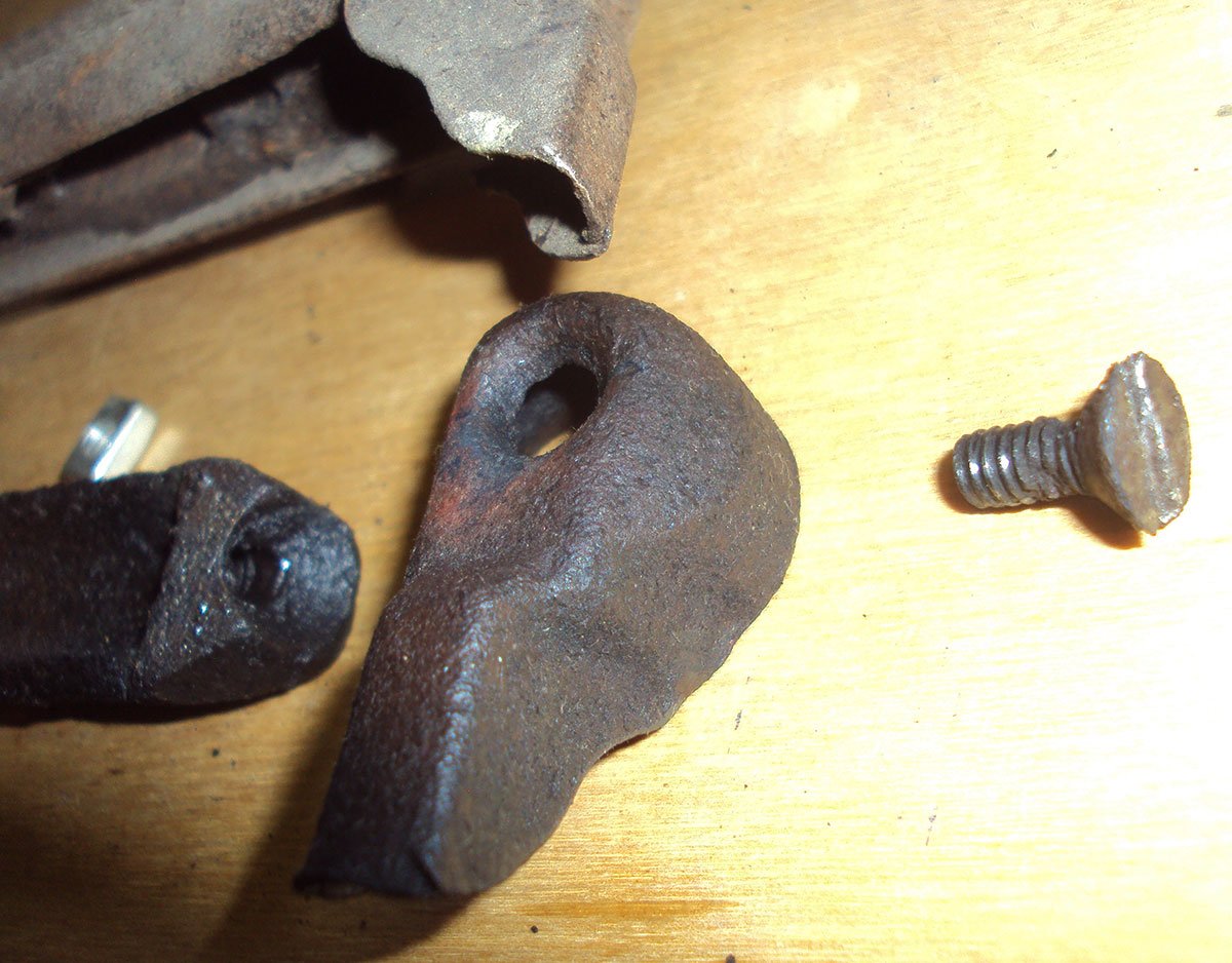

I am about to embark on fitting new glass to my 22 Runabout, the current glass appears to be normal plate glass and I want to replace it with safety glass. Can someone explain to me how the glass clamps attach to the filler blocks. On my car they are glued on and it appears that the screws have broken off. I notice that there are no less than 4 different types of screws that fit in there according to the Chaffins catalogue. Which one is correct and what are the thread specs? Anyone have a drawing how it all fits together?

Re: Fitting new glass
This is what is going on there. I don't know what years used which screws but this one is a #12-24 x 1/2 lg steel screw. I have seen longer. That cap matches the '15-'22 in the catalog. Hopefully you can check your size with a tap in the filler block.
Thanks Richard, another mystery solved!
