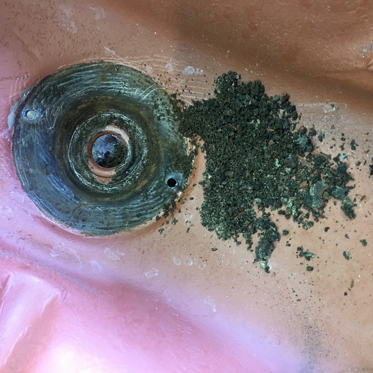

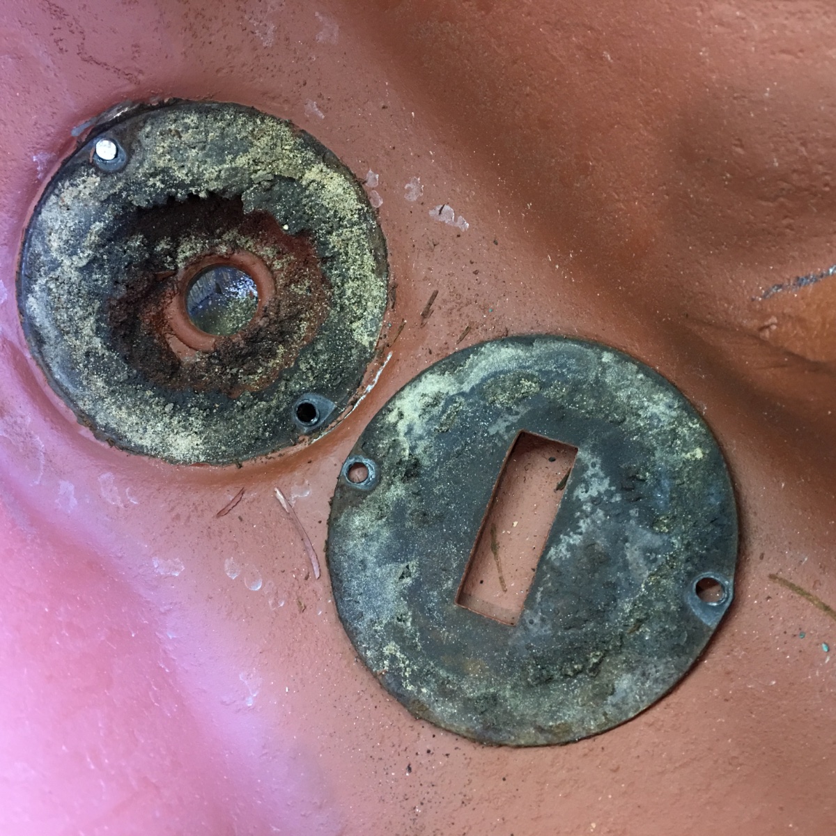

You Have To take the baffle out. Check this out:

Re: So how do I get this stuff out.
Post by Kevin Pharis » Sat Jun 20, 2020 3:59 pm
Mopar_man wrote:
Sat Jun 20, 2020 3:22 pm
I want to go less aggressive and then a bit more.
It doesn’t hurt anything to leave a few $$ worth of solvent in the bottom of the pan for a day or two... but if you are critical about cleanliness today, you will still be critical tomorrow too. And if it’s “not clean till it’s clean”... you might as well take the baffle out now and have it clean and reinstalled (or leave it out) in an hour or so.
