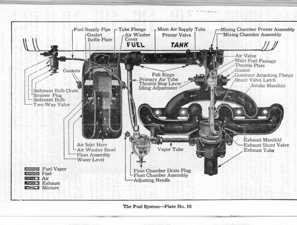

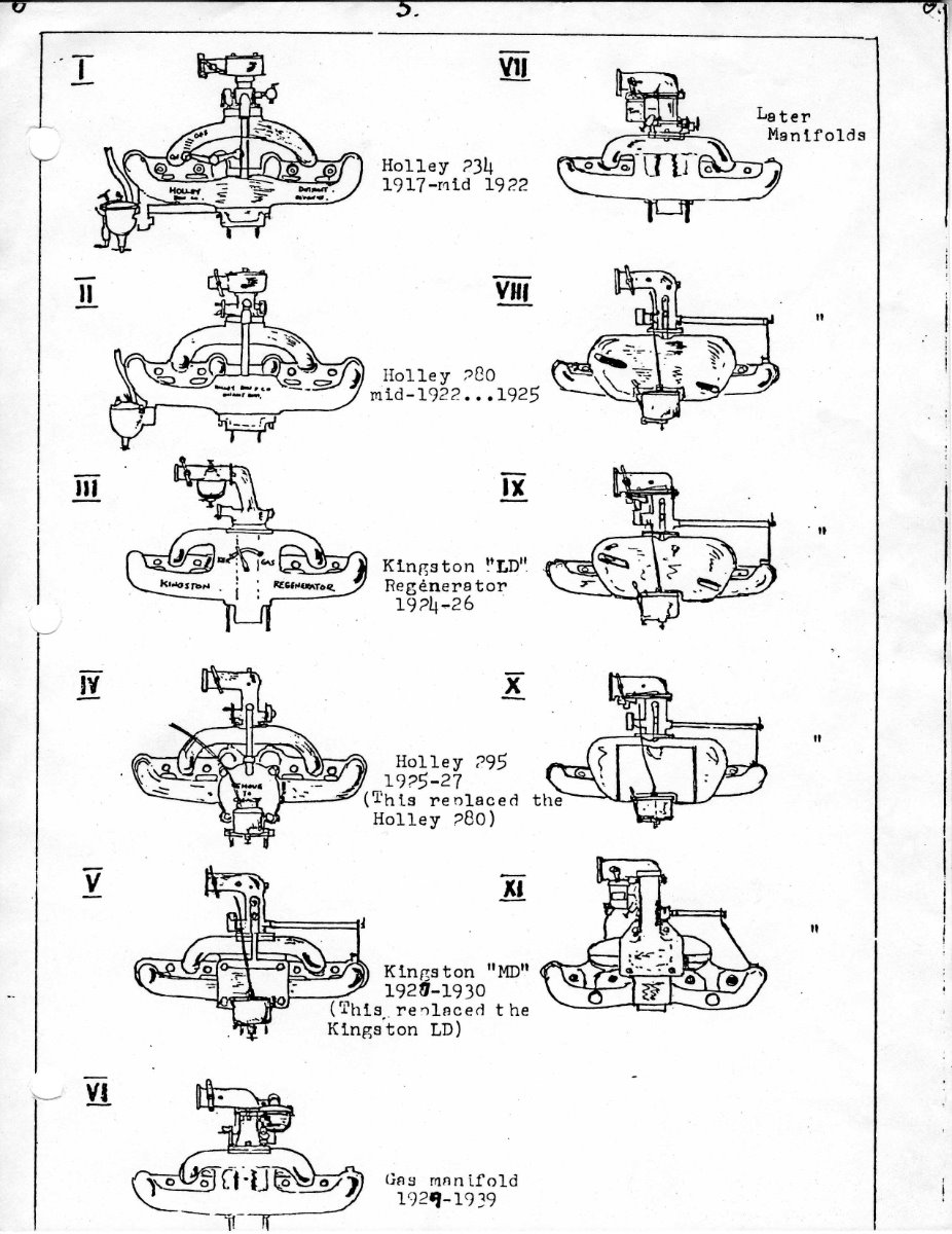

I have attached a couple of scans. When you mentioned your vaporizer was a coil, it got me thinking. Kingston MD's have a large rectangular block that has a maze cast in it for the hotplate. Earlier Holly's have the coil.
Again hope these help,
Kevin

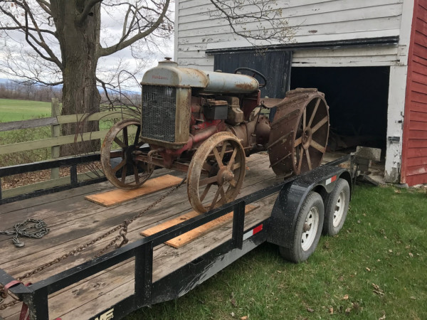

Here is a picture from when I picked it up. Will be ordering a new radiator from Fordson House.

Kevin, plate 16 diagram is my vaporizer setup. Joe, I have to start mine about 4 times out on the needle and then can lean it. Maybe a valve issue. I can not run it with out water in the air bath because it seems to need that back pressure. I put packing foam in it to hold the float open and could only run it partly choked. Does yours have a priming cup on top of your vaporizer? I have a 36 Fordson N with a downdraft vaporizer that starts easier.

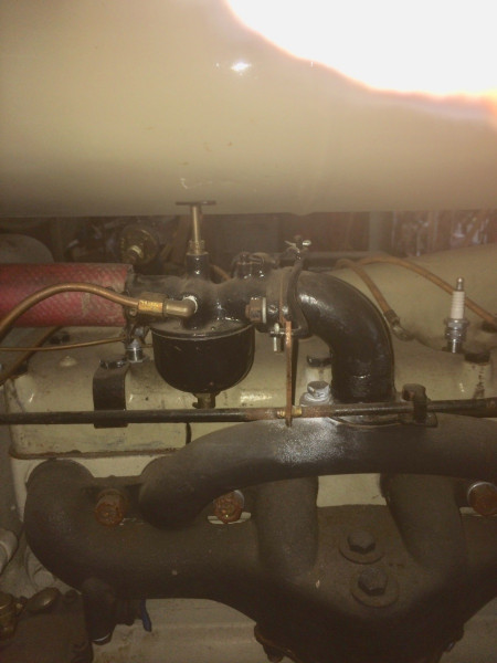

Ya’ll I cheated
....I tried following the up and down movement of the raw gas as it turned into an air/fuel mixture and found that sheet metal ‘coil’ was toast so I turned to the old standby NH carb. Makes starting and running much simpler....Question: How do I keep the 2 bolts fastening the bottom of the radiator from leaking??..they extend up into the lower tank coolant.

George, I like the NH carburetor setup. It makes it down draft. Is it prone to flooding? Are you using the water bath aircleaner? Joe, your coils must buzz if it is running, probably can’t hear them over the engine noise. A battery is the only thing that makes them buzz in a T before starting.

There’s no problem using an NH carb on a Fordson. I have one on my ‘19 ladder side 6 spoke rear wheel too. Don’t use the water bath air cleaner either. Just don’t plow in a dust storm.
