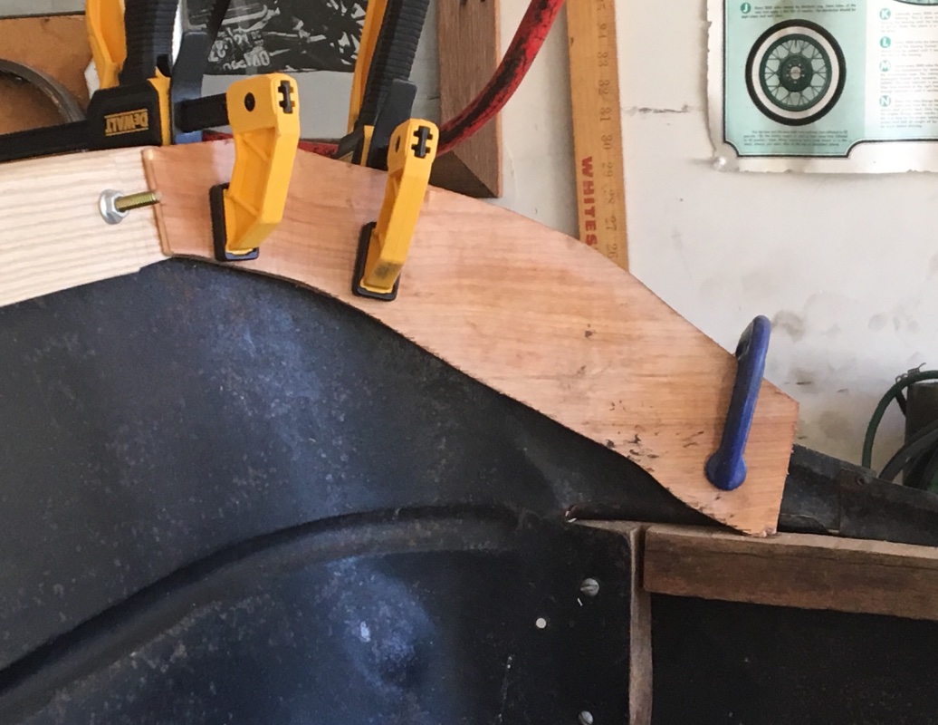

I wrapped up the day by continuing the tack rail project. I’m building the driver’s side curved piece out of plywood laminate like I did the other side.

Post by RustyFords » Tue Jan 08, 2019 10:41 pm
Had just a few moments after work, before I ran out of sunlight so I glued another layer down on my plywood laminate corner section of the tack rail.
Hopefully, this coming weekend, I'll be able to wrap up the tack rail project.

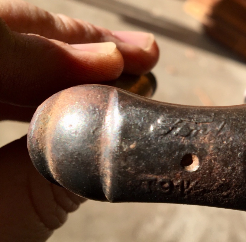

The spring bolt I got from Langs was rather disappointing.
Beside the remains of an original bolt it's obvious that the head is much too short. It's just a generic square head hardware store bolt. The head should be tall enough to fit into the hole in the frame and keep the spring from wandering.
This is the NOS bolt I got from Bob Bergstadt.
RustyFords
Posts: 1559
First Name: Don
Last Name: Allen
Location: Houston, TX
Re: 24 Touring Barn Car Revival - Part 3
Post by RustyFords » Wed Jan 09, 2019 7:27 am
Wow Steve...that is a huge difference. Thanks for clueing me in on that.
I'll contact Bob to see if he has another one.

Good to see the original style bolt is available. I found a good original in my pile of parts for my 21 touring. I was about to cut the head off another bolt to weld on the head of the standard head bolt to make a thick one which would work but then I found the decent original.
Posts: 3809
Location: Lomita, California
Post by Original Smith » Wed Jan 09, 2019 11:25 am
The later center spring bolts didn't have as high a head as the early ones did. I have no idea when the change occurred. Also, the two spring clips used on each side have a special square head, and use a 1/2" across the threads jamb nut, which is used in various places on the late T's.

Thanks for the info Larry.
I went ahead and used the earlier high head bolt that I got from Bob B. The later, shorter head version probably works fine (or Henry wouldn't have used it) but I like the way the earlier version protruded way up into the hole in the crossmember. It just seems more secure to me.
In my mind, I imagined that the hole in the crossmember would be significantly larger than the bolt head, but no...I couldn't even get a fingernail in between the two once the springs were installed. That's a pretty close tolerance, especially for a 95 year old crossmember that's seen as much hard use as this one has.

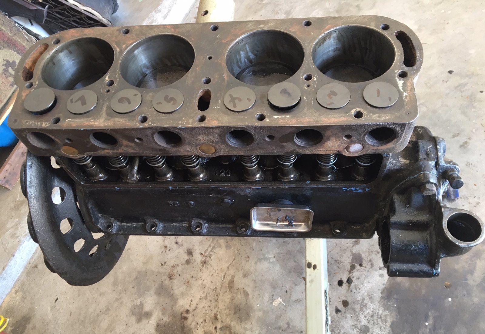

All I lack (mechanically) to have a running/driving car is to go through my spare engine. That'll involve lapping the valves, "time-savering" the bearings, installing new bands and a few other things.
The two front spring perches and bushings are toast and they'll get the full treatment, but I think I'll cheat and at least take it around the block a couple times once it's running...before I tear into the front axle.

More work on the front tack rail today. I hope to have the woodwork done by tomorrow and also have it all stained. Then I’ll let it dry for a week and install it next weekend.
That’s the plan anyway.

Post by RustyFords » Sun Mar 03, 2019 2:37 pm
Yet more woodwork today for the short time I had this morning. I finished sanding all the front tack rail pieces then did a trial fit of the whole assembly, then took it apart and stained all of it.
I also added a few thin pieces of plywood to the horizontal structural wood at the top of the front seat area (behind the front door) to shore it up. That piece of wood was (I believe) replaced at some point and wasn’t stout enough and didn’t have the right shape.
I’ll allow that repair and the stain to dry for a week and will then install the tack rail. All that will leave for me, in the wood department is wood kits for two of my three doors and the vertical struts for the back of the rear seat area.
I’ll buy the door kits because I want excellent quality hardwood with precisely the correct shape in order for my doors to shut correctly, but I’ll make the three vertical struts myself.

Post by RustyFords » Sat Mar 16, 2019 8:02 pm
One of my Chickasha goodies was this fender I bought from Mike Lebsack.
The right rear fender on my car was the only one that didn't have the worn original paint that the reast of the car is wearing. Mike had one that is just beautiful and is a perfect match for my car.
I got home around 3 PM today and was so geeked out about installing it that I went ahead and did so...even before I unloaded my car. Before I installed it, I gave it a gentle bath, then dried it and rubbed in some Penetrol to bring out the old black Gilsonite paint.
Here's a photo of it installed....the lighting wasn't the best. I'm a super pleased with it.

Post by RustyFords » Sat Mar 23, 2019 11:11 pm
Dallas Landers wrote:
Sat Mar 23, 2019 8:45 pm
Looking for update Don.
Ask and ye shall receive :D
Today I concentrated on the spare 25 engine. I lapped all eight valves and removed the pistons to prepare for the honing that I'll give the cylinders. Gene French is re-babbiting my rear main bearing and as soon as I have that back, I should be ready to reassemble the engine. The goal with this engine is to do a quick and cheap refresh in order to give me a temporary engine. The cylinder walls look good and a quick honing is all they should need. My car's original engine will eventually go to Ross Lilliker for a complete rebuild.
I continue to clean the block and the imense amount of blue RTV goo that the previous owner applied over just about every surface. And, I think he used a garden trowel to do it. ;)
I love the valve spring compressor tool that I bought on eBay. It's very easy to use, and for some reason was a fraction of the price of the more common tool.
Six of the valve seats are excellent, while two are so-so. But I've lapped them extensively...enough to make them seal up, I think, for the amount of time I'll run this engine. There's also some significant pitting at the ends of the block where the coolant ports are. I think a new gasket and copper sealant will be enough to compensate for this though.
I also cleared out the oil pickup tube. It was about 75% blocked and whatever was blocking the tube was very solid and persistently stuck. About an hour of fussing with it, jabbing at it, soaking it with carb cleaner and blowing out the tube with compressed air, cleared it out. As an aside...one should pay attention where one places one's face while spraying compressed air into a stopped up tube containing carb cleaner. It could spray the carb cleaner back into one's eyes, causing searing pain and a mad dash for the garden hose and a good soaking for 15 minutes. Ask me how I know. :|

Post by RustyFords » Tue Apr 16, 2019 10:20 pm
Pushed the project forward a bit this evening by installing the valve cover and head.
1924 Touring

Post by Scott_Conger » Tue Apr 16, 2019 10:38 pm
Don
see those "dots" on the center main bearing bolts? They correspond to the cotter pin hole. Next time you're into an engine, you'll want to pay attention to them so as to EASILY fit cotter pins to them! ;)

Post by RustyFords » Tue Apr 16, 2019 11:30 pm
I'm not following you Scott...please explain.
1924 Touring
Posts: 6595
Post by Scott_Conger » Wed Apr 17, 2019 10:18 am
Don
Look at the bolt heads...they're square...there is a "dot" rasied on a corner of the bolt head. If that dot is aligned toward the outside of the block or inside of the block, then the cotter hole will be thusly aligned. In otherwords, if you aligned both bolts such that a straight line can go from the "dot", across the opposite corner of the bolt AND cross over a "dot" on the other bolt and it's opposite corner, the cotter pins will then be a straight shot with both bolts conveniently aligned and easy to put the cotter pins in. I'm sure there is a much easier way to say this but I am flumouxed as to how to say it right now :)
RustyFords
Posts: 1559
First Name: Don
Last Name: Allen
Post by RustyFords » Wed Apr 17, 2019 12:04 pm
ah...ok....got it.
