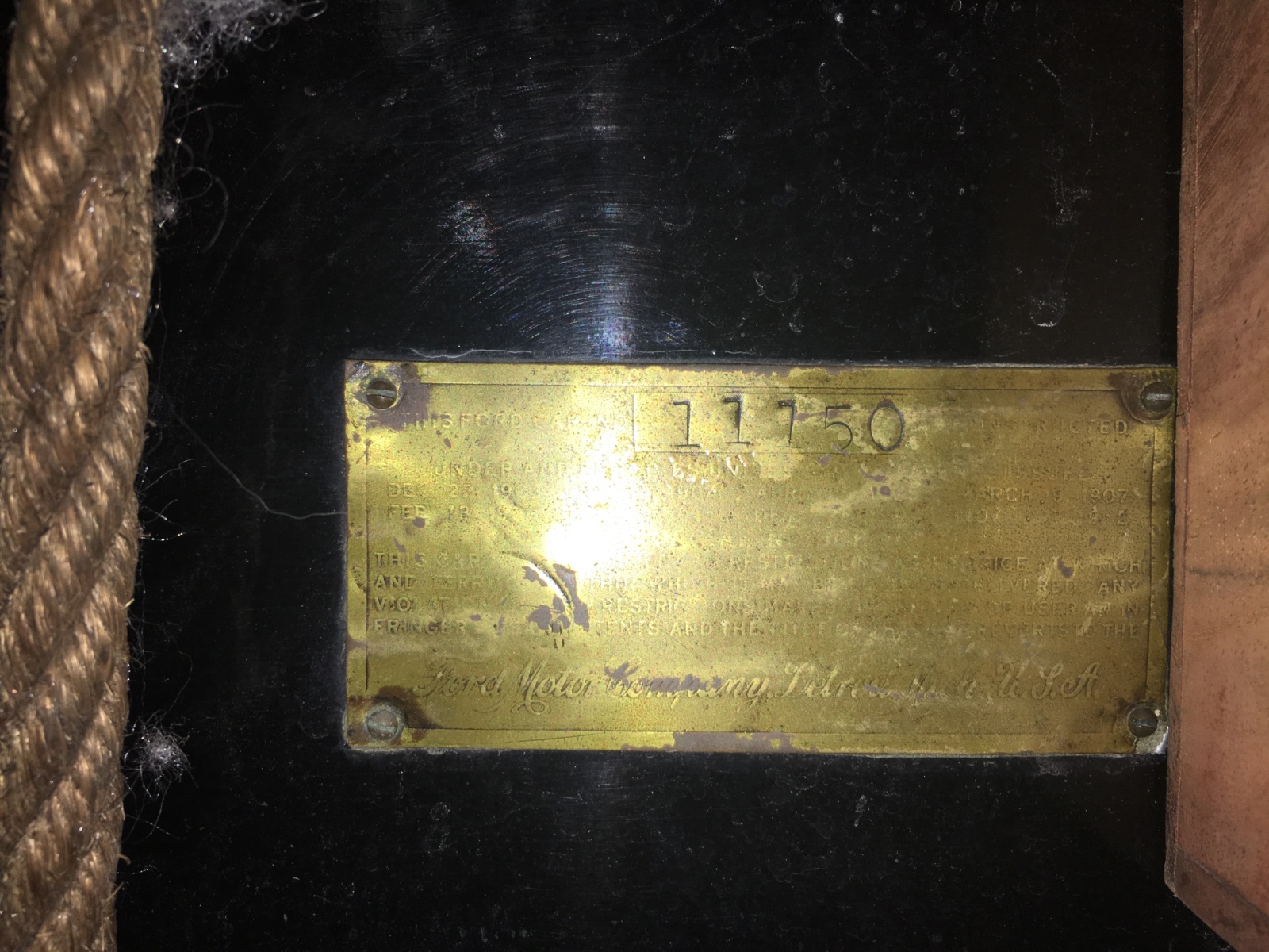

I’m fairly confident about the date of manufacture with two irrefutable items. Both were in the video but only visible for a few seconds.
The first is the serial number tag shows 11150 which according to the encyclopedia is 4 October 1909.

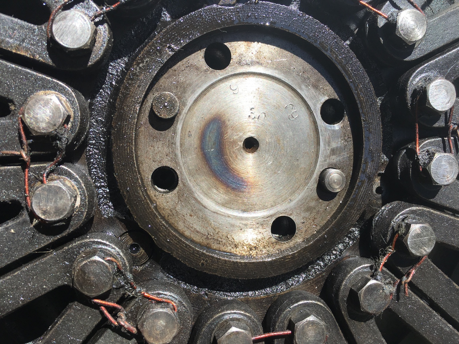

The second was even more convincing, indeed when I saw the transmission shaft stamped 9 30 09, I bought the vehicle.

So that’s how I dated the car. Subsequently I bought the build sheet for 11150 and sure enough it was stamped on 4 October 1909 and shipped to a Michigan dealer. I also acknowledge that all cars built after July 1909 were considered 1910 models but in my mind, that does not effect the date the car was assembled.

There seems to be some evidence that the Ford company made a clean cut change from the 1909 model years and to the 1910. After the change there were probably none painted red, only breewster green, whihc is a 1910 color only. A local T has a serial about 8500 it it is an original tourabout, which was first offered during the 1910 model years. There are nice 1911 torpedo roadsters around with september 1909 build dates and this style is a 1910 body style only. What is important is to dress a Model T out correctly for model year and the above T is finished as a 1910.
