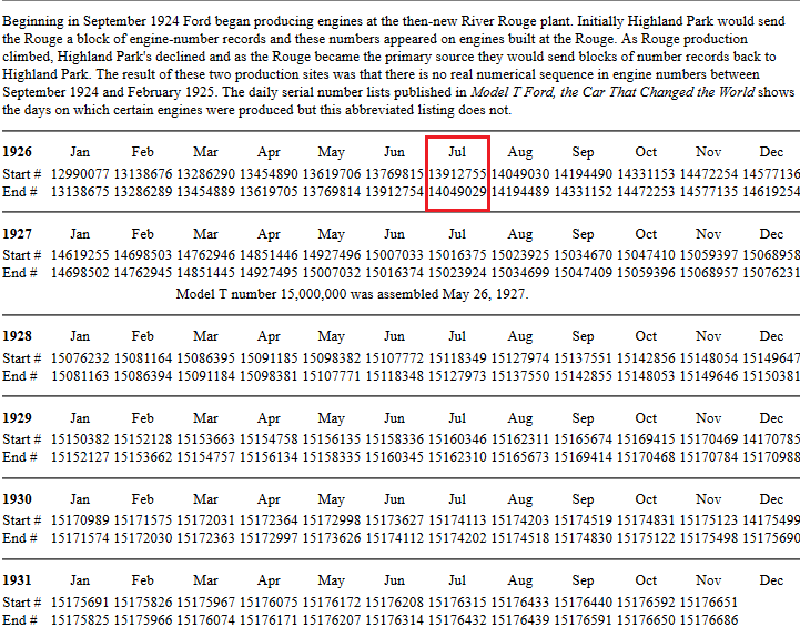

My 1927 Roadster has matching engine and frame serial numbers of 13999657. Where can I find information such as production date and dealership sold to? I would like to confirm information I have been told about this Model T.

The mtfca encyclopedia will give you build date for a s/n, beyond that you are out of luck.

from the Model T encyclopedia https://www.mtfca.com/encyclo/sernos.htm You'll need to scroll down to the year. To further discuss the discrepancy I sure pictures of the vehicle will help members identify any further differences. The year on a car's title is always suspect.

Except the very very early years of the Model T, the only thing the serial number will tell you is the date it was stamped on the motor.

July 1926 build date makes it a '26 model, not '27. I know, my 'September '26 Runabout is a '27 but titled as a '26 to satisfy the state records.
