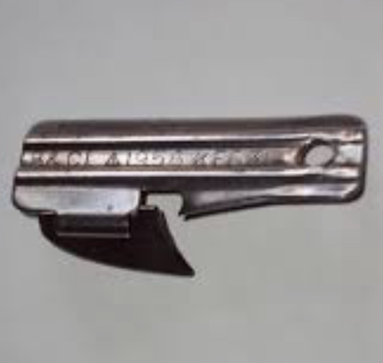

If you’re trying to be authentic...

Kevin, how can a can opener dated 1956 be authentic for any T model?

Sorry Allan... was the oldest one I could find a picture of...

I stand corrected... turns out the P-38 can opener wasn’t invented till 1942. So NOT a period correct holemaking method. Guess you’re goin to have to look for an ‘ol bit and brace... or get out the ‘ol trusty cold chisel!!

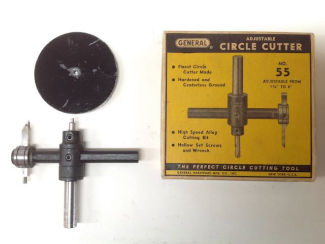

Lacking the proper sized hole saw, I used this Adjustable Circle Cutter I had on hand.
