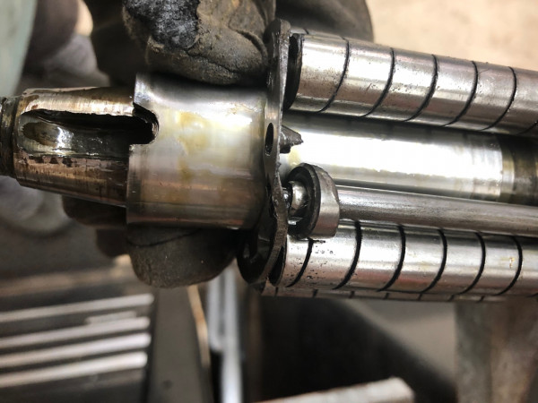

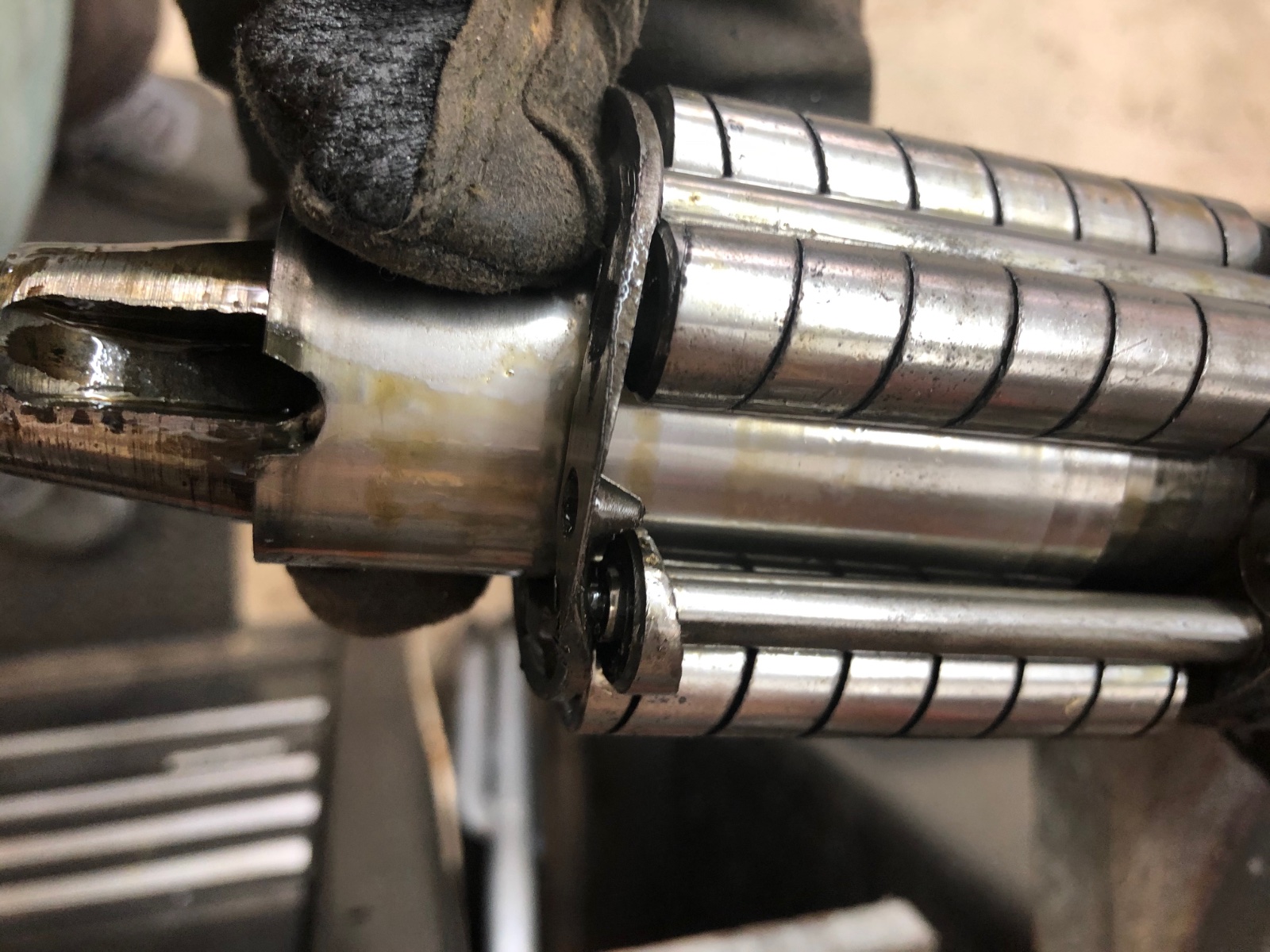

Took apart this one for clicking at the u-joint, after removing from the motor,. The Hyatt pinion bearing was busted, and that caused the sleeve to migrate down into the gear. Found the pinion gear loose on the driveshaft, and it moved both ways, with just finger twist, along with the pinion sleeve, note the excursion of that sleeve, from one side of the key way to the other
Those wheel hubs do the drive, and do the stopping too, so keep them in good shape.
No real way to know if new bronze thrusts are there, or if any other things are amiss in the drive line without taking it apart for safety inspection.
