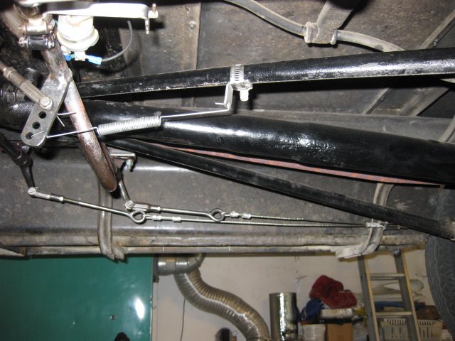

I have just converted the emergency brakes on my '26 roadster to works as service brakes as well. I modified an old stock T cross shaft mounted about 6" behind the regular cross shaft with an adjustable link to the brake pedal and two arms to connect to the "new" service brakes. I removed the original steel brake rods, saved the ends, and replaced center section of them with 1/8" aircraft steel cable with 4 adjustable connections on the original emergency brake system and the new service brake system for each side. After fiddling with the adjustment for a while I now have way better brakes, and can lock up the rear wheels at will. They actually work better that the outside brakes on my '25 coupe (small drum). Sure was a very effective and inexpensive way to get great brakes. I can send pics if anyone is interested.

I would be interested in pictures of how you made them work, thanks. Dennis

He said he removed the original rods, and replaced the original emergency brake rods with cables, and added two more cables to actuate them as "service brakes". So, either way will apply them, and since they are cable operated, the unused system will just get some slack when they are applied.

Pictures Yes-- please

I would also be interested in pictures. Sounds like something they would have done back in that era and offered it as an accessory kit.

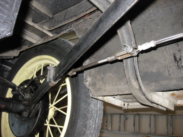

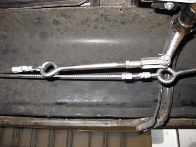

OK guys , here are some pictures. I'm extremely happy with this set-up and the cost was minimal. I do have a hoist that enables me to lift the rear wheels and it was sure beneficial when making adjustments....and I made lots to get he action just right.The "new" service brake hits just before the transmission brake as there is more linear motion involved with the new brake set-up as opposed to the short brake pedal travel to activate the tranny band as well as more connections to have the slack taken up. Note also the arm for the adjustable rod to the brake pedal has several choices for travel and mechanical advantage. More travel here gives more leverage so I had to coordinate the travel of the new set-up with the existing travel of the pedal to fully apply the transmission brake.Also note that the new cross shaft is as far back as I could place it to clear the travel of the original cross shaft as well as the two arms from the U-joint to the backing plates. To get adequate clearance I had to put a 1" spacer between the mounting blocks and the lower frame rail. Photo 1 shows cables with both brakes off. Photo 2 shows placement of the new cross shaft. Photo 3 shows the cross shaft, brake light switch (1949-54 Chevy) and with both brakes off. Photo 4 shows the saved rear section of the original brake rod with both emergency and new service brake cables attached to a common point.Photo 5 shows another view of the two cross shafts and rod to the brake pedal. Note that I initially used the little bolt on cable clamps while getting the cable lengths close. When I was satisfied with my cable lengths I removed the bolt-on clamps and installed the crimp-on clamps that not only look better but they will not slip.

I was going to ask if the transmission brake was still hooked up as well... that is one heck of a balancing act! My hat's off to you, sir... Well Done!

This is not a brake design that lends itself well to use as a service brake. Because the shoe is not anchored separately it puts a tremendous load on one side of that little brake cam (which is doing double duty as an anchor) when using it to stop a car that is rolling. That's to say nothing of the rest of the parts in the load path not being designed to withstand the rigors of life as a service brake. After things wear or something snaps you can wind up with some very undesirable results. Be safe out there.

Walter, thanks for your concern, but these brakes are intended to be in addition to the standard "service" brake in the transmission and not to be the "only" braking system. I would agree that the pre-1926 small pin brake cam and actual cam thickness might give one second thoughts but this is a 1926 with a much larger cam and 1/2" steel cam pins with a shear strength of somewhere between 13,500 and 17,000 lbs in a car that weighs around 1500 lbs. As well if you look at the rear brakes for a mid 50's Ford the only anchor is the wheel cylinder held to the backing plate with two 5/16" grade 3 bolts totaling a lot less shear strength than the single Model T anchor and in a system meant to stop a vehicle that weighs maybe three times that of a Model T , capable of speeds more than twice that of a T running on tires maybe three times wider with a footprint also three to four times larger than a T. I would be more concerned about having a tire break loose on the wire wheel than having the actual shoes, cam or anchor fail trying to drag two 4" tires supporting maybe 300 lbs each on pavement. BTW, the anchor pin on the R.M. brakes is the same size as the '26-'27 stock T pin and the braking surface is larger on the Rockies. Thanks again for you concern, but I'm more than quite comfortable with the additional braking capabilities on my 1500 lb car at 40 MPH, and I'm out of pocket less than $50.00 plus some engineering and tinkering time....which is why I have a Model T in the first place.

There is a very substantial anchor pin on the Bendix brakes...that thing above the wheel cylinder, I think it's 5/8" thread. The wheel cylinder does not do any anchoring at all, it has a hole through it--it's job is merely to push the shoes apart from each other.Bruce Compton wrote: ↑Thu Jul 09, 2020 10:06 amAs well if you look at the rear brakes for a mid 50's Ford the only anchor is the wheel cylinder held to the backing plate with two 5/16" grade 3 bolts

You're right Jim. I saw that and knew it before I screwed up in my text. The wheel cylinders might temporarily slow down the destruction if the main anchor failed. Thanks : Bruce

Bruce.....I thank you for taking the time and effort to share your rear brake upgrade. Your results look very carefully executed. Certainly has to provide a marked improvement to the standard "push and pray" Ford foot brake......Regards, John

Yes John, I couldn't be happier with my modified brakes, and everything still looks stock unless one wants to crawl under the car. I was forced to use the hand brake a few times with other T's I had and am not crazy about using one hand to brake with and the other one to steer especially in a panic situation. Both braking systems on the pedal sure feels safer to me anyway.
