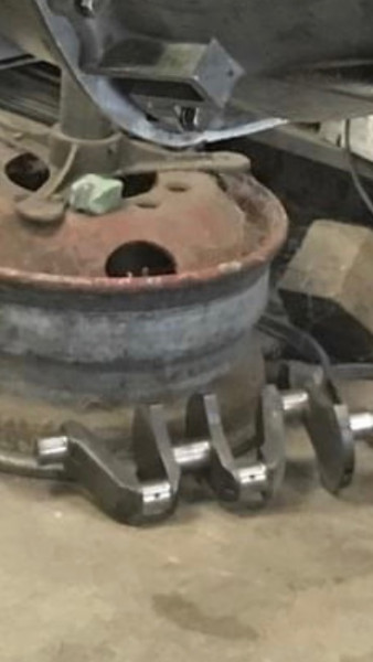

The Model T engine was designed in 1908 when there were no paved road and cars ran on mud trails. The engine power curve peaks at about 1100 rpm and terminates at 1600 rpm. This equates to about 25 mph and 36 mph and this seems to equate to the normal and maximum speed that is normally associated with Model Ts. I believe that over 2000 rpm, the valves will “float” due to weak valve springs. Also I think the valves will start to embed into the block due to the high speed hammering when closing. Now the engine was quite well balanced but the pistons are heavy, over two pounds and ride on quite small bearing surfaces. While fine at 1000 rpm you can expect a shortened life at higher speeds. To some extent this us born out by the Montana 500 races, their engine don’t seem to last more than one race before a rebuild. This is certainly true in modern engines which will last many thousands of miles at low speeds (up to 4000 rpm) but Less than 100 miles when racing at 7000 rpm.
Now we can add hardened valve seats, stronger springs, stouter camshafts, lighter pistons and so on and so on but it’s no longer an as designed Model T.

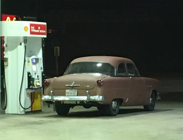

My dad's main hobby was drag racing, which he did from the late 50's through the early 80's. I came along in '69 and tagged along and got that high octane in my blood.
I'm about to undertake another rebuild on my high school car ('54 Ford tudor sedan) with a stroker small block Ford...looking for around 500 hp. With my Model T, the goal is to slow down and enjoy the scenery.
Tony's explanation of the engine internals is one of the best explanations I've seen of why the little engine shouldn't be revved too often. I baby mine....probably too much.

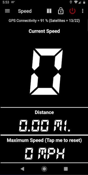

Neither one of our T's have a speedometer, so my driving speed was an educated guess. I know how fast I'm going now since I installed a free GPS speedometer for the Android phone made by COOL NIKS. It has a nice screen showing your speed in large font, and is handy for getting a quick look at how fast you're going.

Post by TonyB » Fri Jul 17, 2020 10:58 pm
This was a pressure fed crank with less than 10 hours but 6500rpm
Broken crank
Broken crank
Reliability is in the eye of the beholder.
(Picture from Erik Barrett)
