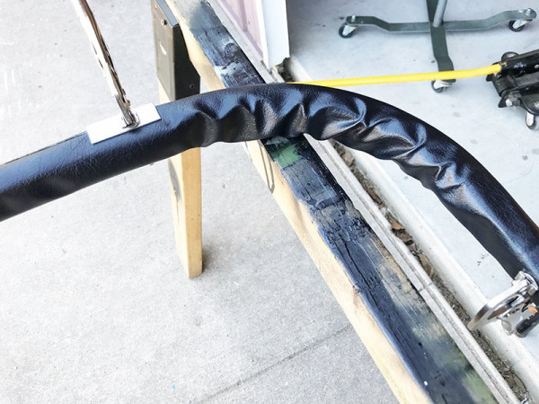

It's a 17 Touring, two man top. Instructions say to wrap the front bow in vinyl. The vinyl is cut on the bias. It's cooking in the sun as I type and I'll be going out shortly to work on it.

For those who have installed a vinyl top I have a question. Are there any tricks to smoothing out the corner puckers in the vinyl used to cover the front bow?

I maintain that the original leatherette on the first bow is not the same thickness as the leatherette top material. It is thinner than the top material and comparable to the thin leatherette currently available that is used to cover the door panels.
I have two sets of bows with the original leatherette on the front bows - one set is on my un-restored 1917 roadster. My father has the original top material from 1917 touring and also a roll of "Turf" grain top material he recently purchased from Classtique.
The original leatherette front bow wrapping is thinner than the "Turf" top material.

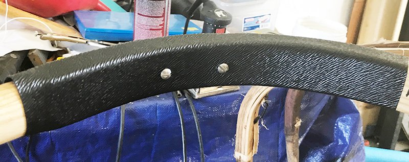

Post by NealW » Tue Jul 14, 2020 6:31 pm
I'll take a picture after work and post later.
Tim,

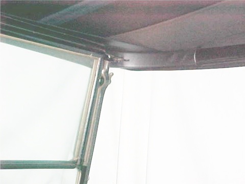

Here's what my wrapped top bows look like. I think one of the classtique videos shows wrapping the bows that may be helpful for you too.
Neal
Posts: 2548
Last Name: Strange
Location: Hillsboro, MO
Re: Top install question
Post by CudaMan » Tue Jul 14, 2020 7:16 pm
I wonder if there is a period picture that shows what that area looked like on the cars when they were new?

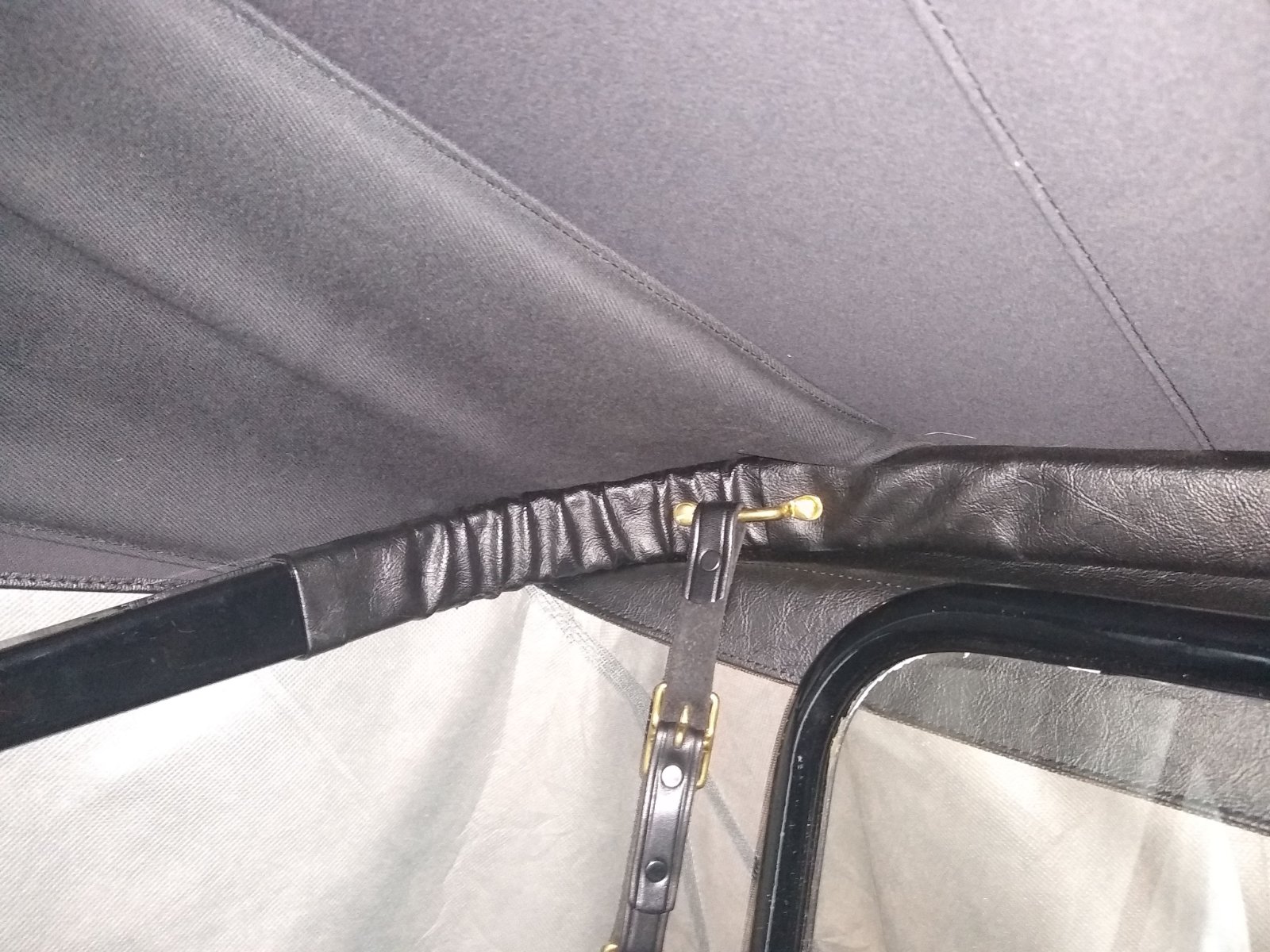

On my '23 the front busted bow had a metal repair, and remains of the front bow wrapping, it was stiff, but was tight around the curve. With hardly any wrinkles. That old material Ford used was thinner that our modern vinyl.
I wrapped the new wood bow replacement with vinyl, takes time to pull and stretch, and got little fold wrinkle. But this was the barn look car so didn't really work on it.

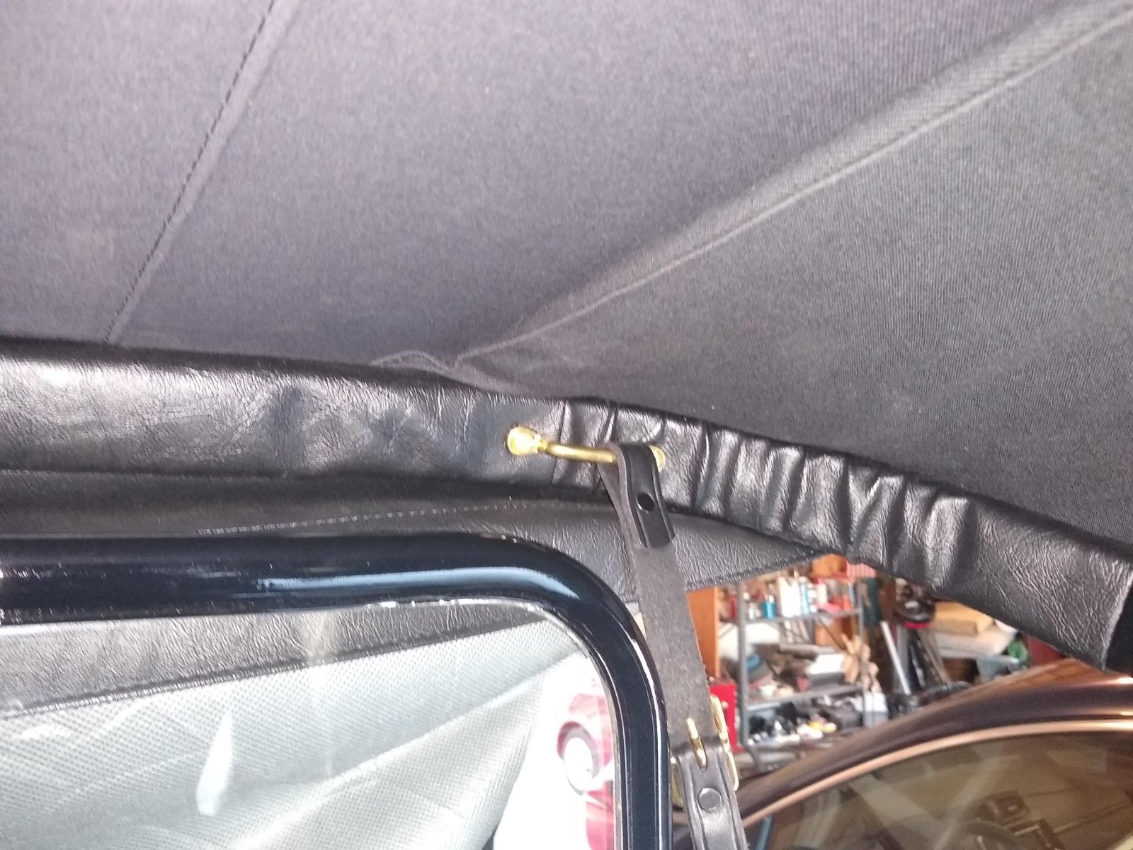

For my '25 touring the kit came with nice angle cut pieces of bias cut vinyl, and that wrapped very nicely without large wrinkles.

Dan, did the wrap on your front bow come in more than one piece? It looks like a seam in the photo.

The photo that Dan Treace posted is correct. There are two posted above that are horrible, and I would be ashamed to own a T like them. Those guys need to read up on what cutting the material on the bias really is! It is not an impossible job. However it takes some effort, and as I mentioned previously a heat gun and some contact cement are a help. Tacks work too, but a staple gun is easier than dropped tacks!

Dan Treace, thank you for posting that picture showing how smooth the job can come out when the wrap material is cut on the bias. :)

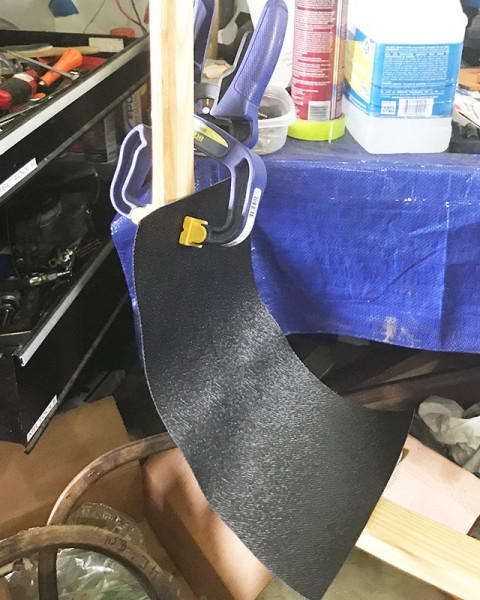

Ok, I'm back again. I ordered some material from Classtique that matches the rest of my kit. The front bow wrap comes in three pieces with the end pieces for the curve cut on the bias. Now I am faced with how to proceed with attaching it. I don't want to ruin it and have to buy replacements and lose time getting my top installed.
I've attached a picture of what Mike sent me. I'm thinking I might glue the center to the underside of the bow and try using a heat gun and such to stretch it around the top where I'd tack it. I believe the video said they cut slits in the material to help it conform. I assume we are less worried about the appearance of the material on the top of the bow compared to what is visible to the car's occupants.
For those of you who have been successful in getting a tight wrap on the corners, what did you do?

Why don't you try using some clamps and push pins to temporarily hold it in place while you practice wrapping it and smoothing the wrinkles out?

Preventing wrinkles is deceptively simple. Spray scotch adhesive to the inside curve of the bows and then apply the fabric. Once it has dried, you can stretch and wrap the fabric up over the outside edge, stapling as you go. Only wrap the fabric almost halfway across the outside edge, so when you wrap the other side, it is still secure, but only one layer in thickness. The spray glue prevents wrinkles from form on the inside edge, and also prevents wrinkles, since you are wrapping it onto a larger radius.

As I said, I purchased material from Classtique to match my top. It came in three pieces with the end pieces cut on the bias. I agree that you could likely do it in one piece if it was all cut on the bias.
What I did was glue the material to the inside of the curve and by using heat, clamps and strong fingers, stretch it around the bow. I did put a little slit on each side near the center which I think helped a bit. I did not make numerous slits as shown in Classtique's video - they were not necessary. In truth, the spray glue made it easy - I also used it to glue each side of the top down as well. I put in a few tacks for safety and am ready for the next step.
