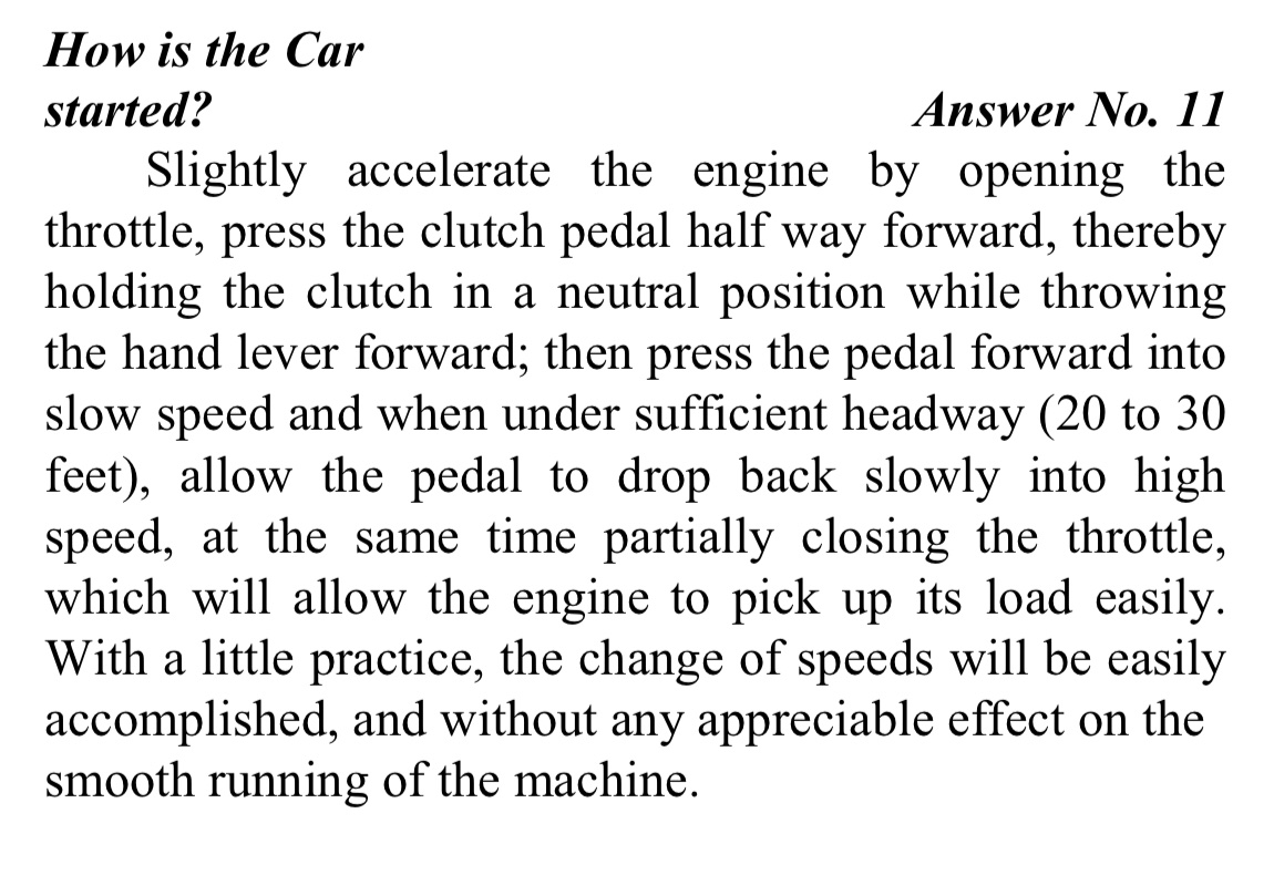

Post by Adam » Fri Feb 15, 2019 6:08 pm
From the 1924 FORD Manual:

Post by Scott_Conger » Fri Feb 15, 2019 6:54 pm
Well, now Adam, that's just unreasonable, citing the factory liturature and all.
