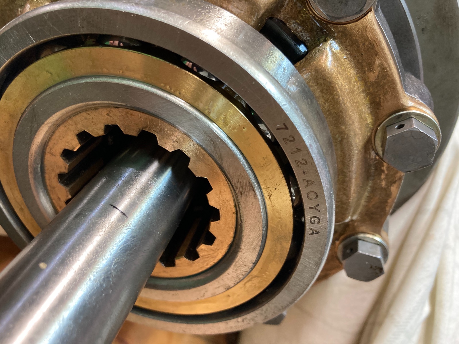

I have a brand new P211 thrust bearing and a brand new P139 bronze plate. I pressed the bearing onto the bronze plate as described in the MTFCA Ruckstell book. It went on fairly easily in what I would describe as a light press fit.
Yesterday, I was performing the shift lock function test. When I was removing all of the parts, I set the bearing/bronze plate assembly face down on my work bench. When I went to lift it up, to my surprise the whole bearing slipped right off and laid right there on the bench.
I am confident that the bearing was fully seated. The only thing I can figure is that the cooler temperature in my garage caused a contraction of the materials and allowed them to separate.
How tight of a fit should the bearing be on the bronze plate? Should I consider using Loctite bearing retainer on the surface between the bronze plate and the inner race?

Yes it should be a press fit- about .002" interference.

Here is the spec sheet for a 7212 angular thrust bearing:
https://www.skf.com/group/products/roll ... 12%20BECBP
This specifies that the inner diameter of the inner race is 60mm which is 2.362” (subject to tolerances).
The Ruckstell book states that the shoulder of the bronze plate should be 2.3625”. Mine measures nominally that much although I am just using a dial calipers.
This seems to me that if you have two parts that are machined perfect that you would only have 0.0005” interference fit.
This does not seem like much and so I guess what I’m asking is that assuming the parts are not perfect, is what I experienced out of the ordinary and should I be taking steps like using loctite bearing retainer to make sure that the inner race stays put once installed.

Ok, I've finally had a chance to get caught up and do some research. I'm by no means a bearing expert. Everything I've typed below can be found on the internet, but here it is all in one place:
1. 7212 is a industry designation for a single-row angular contact (thrust) ball bearing. It describes the critical dimensions of the inner and outer races. I have to believe this is why the MTFCA Ruckstell book only says to use a 7212 bearing and says nothing else about a longer part number.
2. The bearing that I received from Lang's is a 7212 ACYGA. The "ACYGA" is a designation system used by SKF and its subsidiaries to describe bearing construction. Therefore I have to believe that what I have is a SKF bearing regardless of where its made.
3. Angular contact bearings are designed with different contact angles. The contact angle describes the point of contact between the balls and the races relative to the operating axis of the bearing. The larger the contact angle, the higher the axial load capability. The smaller the contact angle, the higher the permissible speed capability. Centrifugal force changes the contact angle between the inner and outer race.
4. A "BECBY" bearing has a 40deg contact angle. An "ACYGA" bearing has a 25deg contact angle. Here are the advantages of this bearing taken directly from the SKF website:
AC Series 25deg contact angle bearings:
-have a raceway geometry optimized for high speeds
-have reduced sensitivity to axial loading and misalignment, including the ability to accommodate two times higher peak loads before edge stresses can occur
-are equipped with an optimized machined brass cage as standard
Compared with bearings with 40° contact angle, benefits include:
-20% higher limiting speeds
-higher radial load carrying capacity (by trading off lower axial load carrying capacity)
-increased robustness when used as the backup bearing in sets that are predominantly loaded in one direction
A review of bearing data from the SKF website shows that an "AC" bearing exceeds the basic load ratings of a "BE" bearing, with a 3500r/min increase in the limiting speed rating.
I have to believe that someone at Lang's or other suppliers did a similar analysis and determined that the bearing which I received was better suited for this application which my amateur research seems to support.
Finally, I will say that apparently the information I posted above about there being only a 0.0005" interference fit between two perfect parts is correct since no one has told me otherwise. I know that my parts are not perfect so I decided to use Loctite bearing and sleeve retainer on the surface between the inner race and thrust plate shoulder which is designed for that exact purpose. Unfortunately, you never do things as good the second time around and like a dummy I forgot to buck it with the P145 thrust plate when pressing it back on. So I spent the following hour pressing it back into shape very carefully to achieve less than 0.003" runout. Not perfect but the book says to look for detectable wobble so I would consider this sufficient.
Any comments, questions, speculations or insults are welcome!
