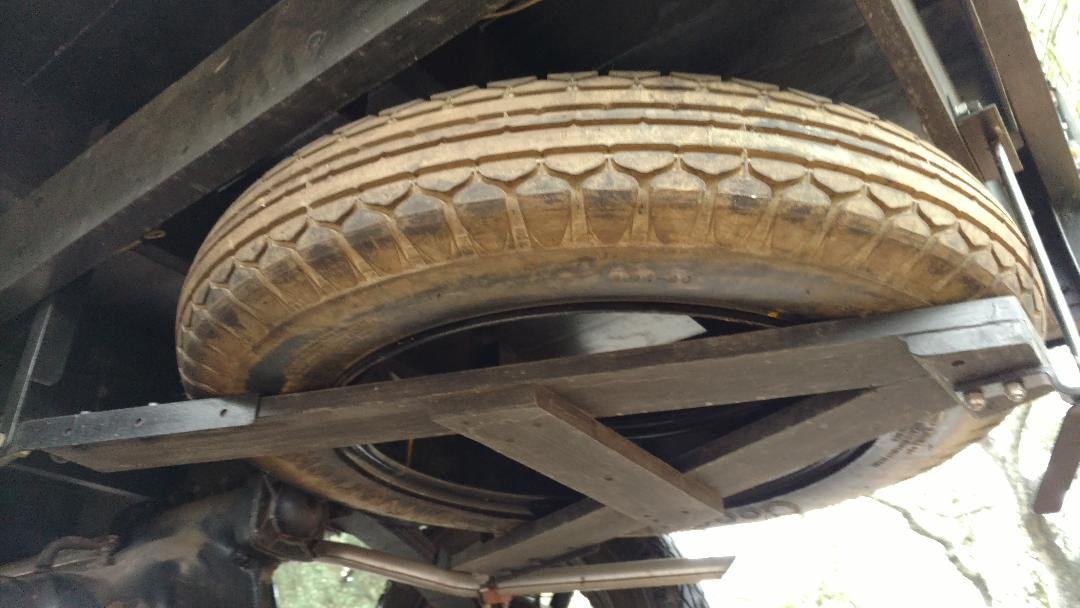

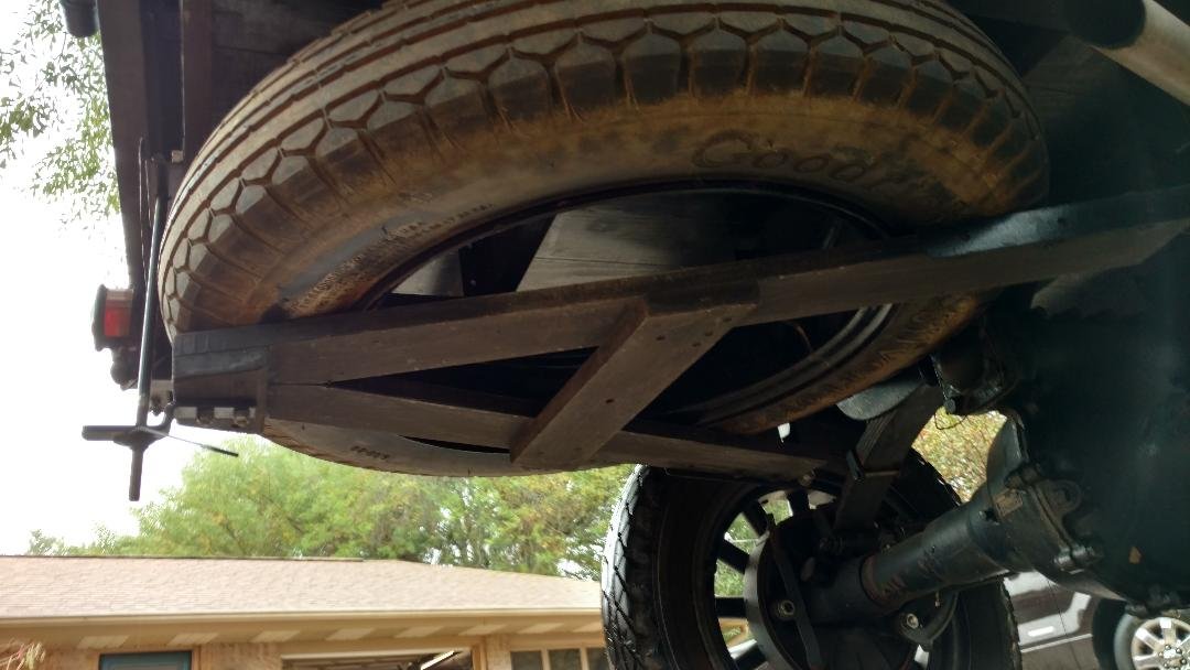

Im getting ready to make an under bed spare tire carrier for the 23 TT. I have two sizes. 32x4 1/2 rear and 30x3 1/2 front. The 8in1 bed is long enough for this. Just asking to see what others have come up with on their T pickup or TT. Im leaning toward a hinged front mount that swings down in the rear so Im not lifting both rims and tires to the ground for access. Any photos would be great. Thank you.

I very much dislike the idea of lying on my back in the mud to wrestle a heavy spare in or out, which is what's required by some under-bed spare carriers I've seen. I like the swing-down idea in Randy's photos, but I would put the hinges toward the rear so that when it's down the tire would be easy to reach. I would put a latch at the front end with a control rod to the rear. Pull the rod to undo the latch and let the carrier swing down. I imagine this would eliminate the aforementioned mud wrestling. But how about raising the carrier up to the latch with that heavy spare on it? Maybe a cable winding onto a shaft with a crank at the rear. I haven't tried this, but I think it would work if designed properly. Maybe it could be made to accommodate both a rear and a front spare.

Something like Randy posted is what Im thinking. Will be made of flat and round stock. I dont have a place for a sidemount the way the bed is made. Thanks for all the input.

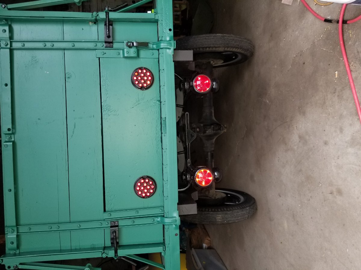

The weight is a factor. Maybe I need to think about a rack that the tires slide in from the side. The tail lights are in the way to the rear. Moving the lights outboard of bed runners may be an option also.

Dallas, can you reverse the brackets and make them swing outboard instead of inboard? Would that provide enuf room, and still keep the look?
