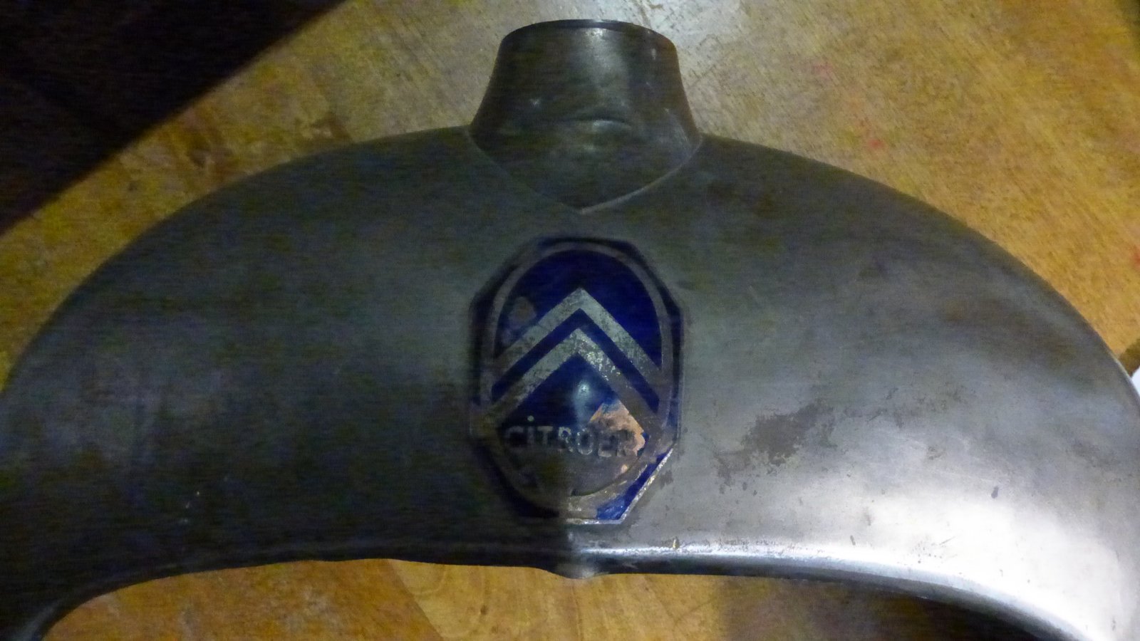

The radiator badge on my 1924 Citroen is soldered in place and must be removed to nickel plate the shell. I'm afraid to re-solder the restored badge on the re-plated shell. Any suggestions? A badge restoration guy says to use silicone adhesive.

I used a torch to remove the emblem on a similar spare radiator shell and the neck fell right off. I was thinking, for re-attaching the emblem, to position a piece of solder beneath it, then holding the iron underneath.

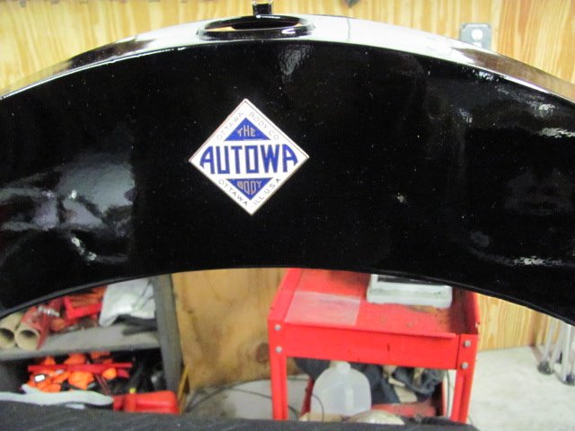

Just me, but I wouldn't trust silicone adhesive for such a rare piece. As silicone adhesive can age and the heat alone at that spot on the radiator would make silicone adhesive for long term in that vibration spot a suspect.

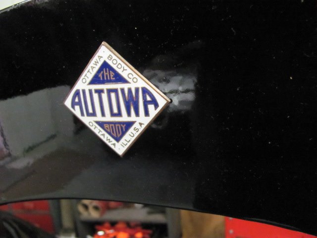

The extremely rare emblem off this shell was originally held just with rolled metal edge in a circle, it was loose over time too, so pried it off to refinish the shell. Installed the cloisonné emblem back in place using J-B Weld. Can trust J-B for this preservation.

Good comment, on this shell the area around the circle was masked from paint, and circle of J-B Weld placed on emblem, plus some around the rim of the emblem on the inside of the shell.
