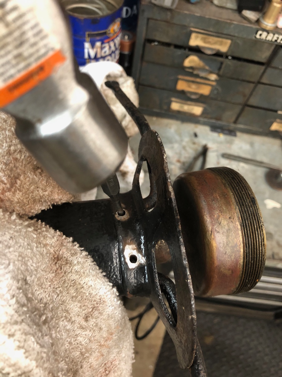

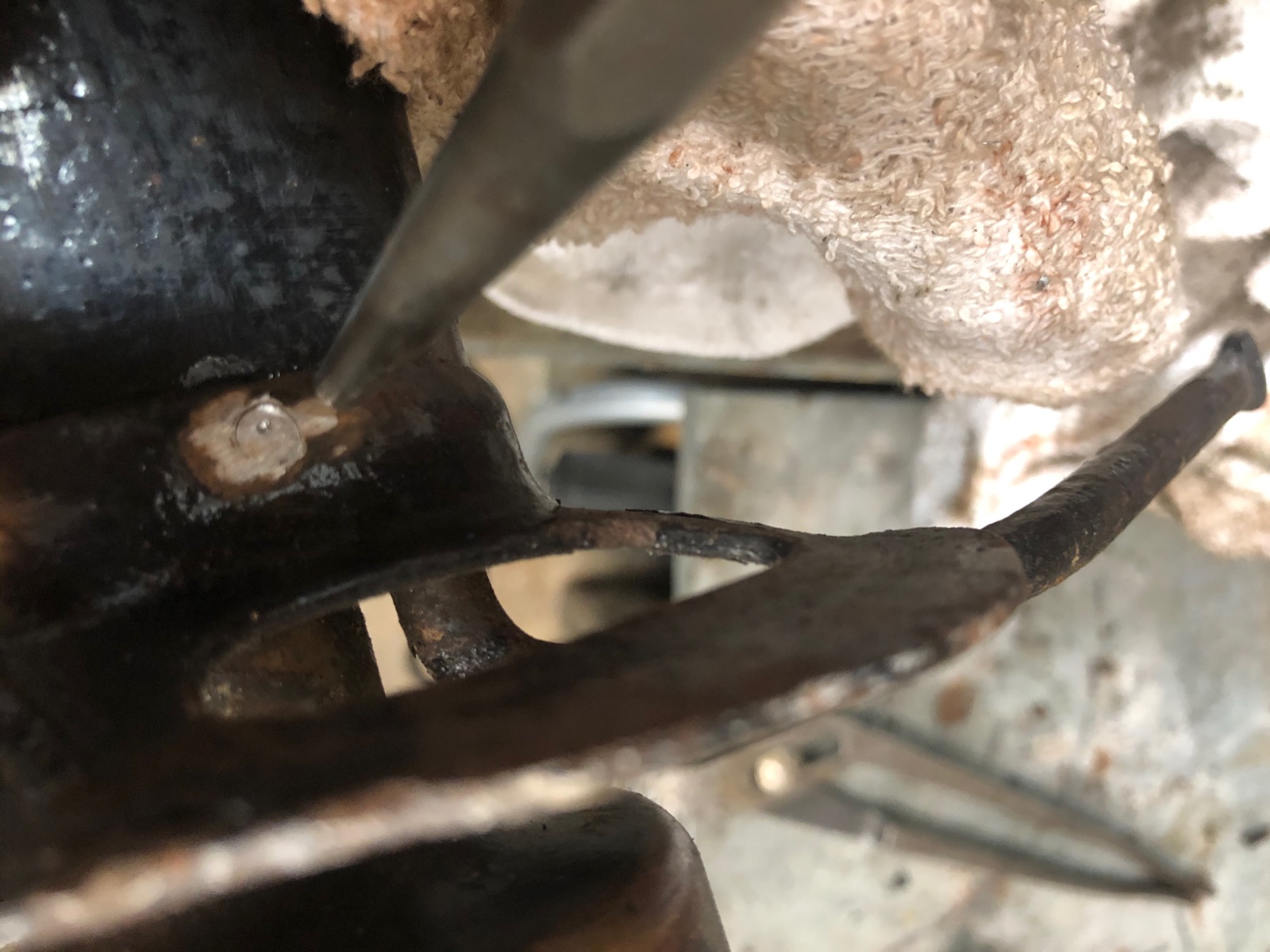

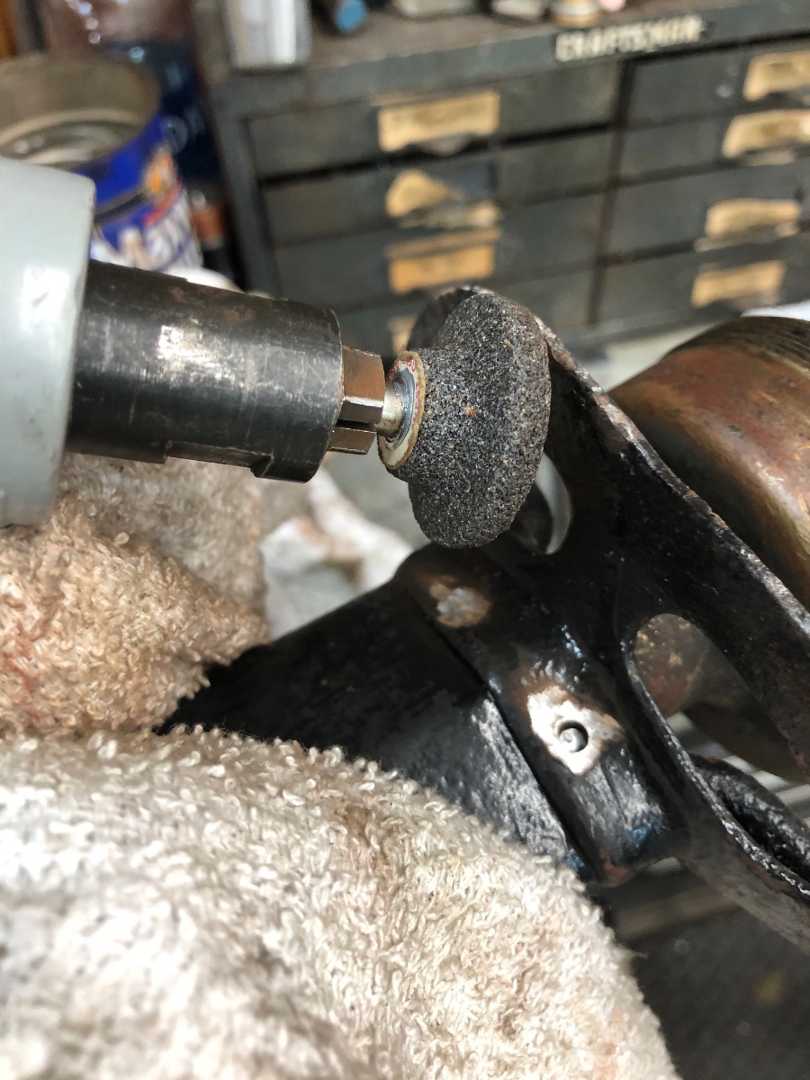

I'm replacing the spark and gas levers:
I've filed the heads off the bottom side of the quadrant rivets but can't seem to knock them out. Is there a secret to doing this?
Thanks in advance.
R/ Roger.
Thanks in advance.
R/ Roger.

Most likely a bigger hammer and a real good steel drift - I've always taken the tops off - easier to pound down !

Grind the underside rivet flush, then you can see the circle of the rivet shank.
Center punch the center. Sometimes a twist drill is needed to drill down about 1/4" or so.
Then punch out with drift that will fit into your drilled pilot hole. Lots of times they loosen up with just the center punch.
Of course having the column locked tight in a vise gives solid fixture to apply the hammer, no lost of energy.

The column is out of the car.
The heads are ground off the bottoms of the rivits.
I'll try drilling down a little bit.
What's the correct terminology for the notched semi-circle under the steering wheel that controls the motion of the spark and gas levers?
R/ Roger.
R/ Roger.
