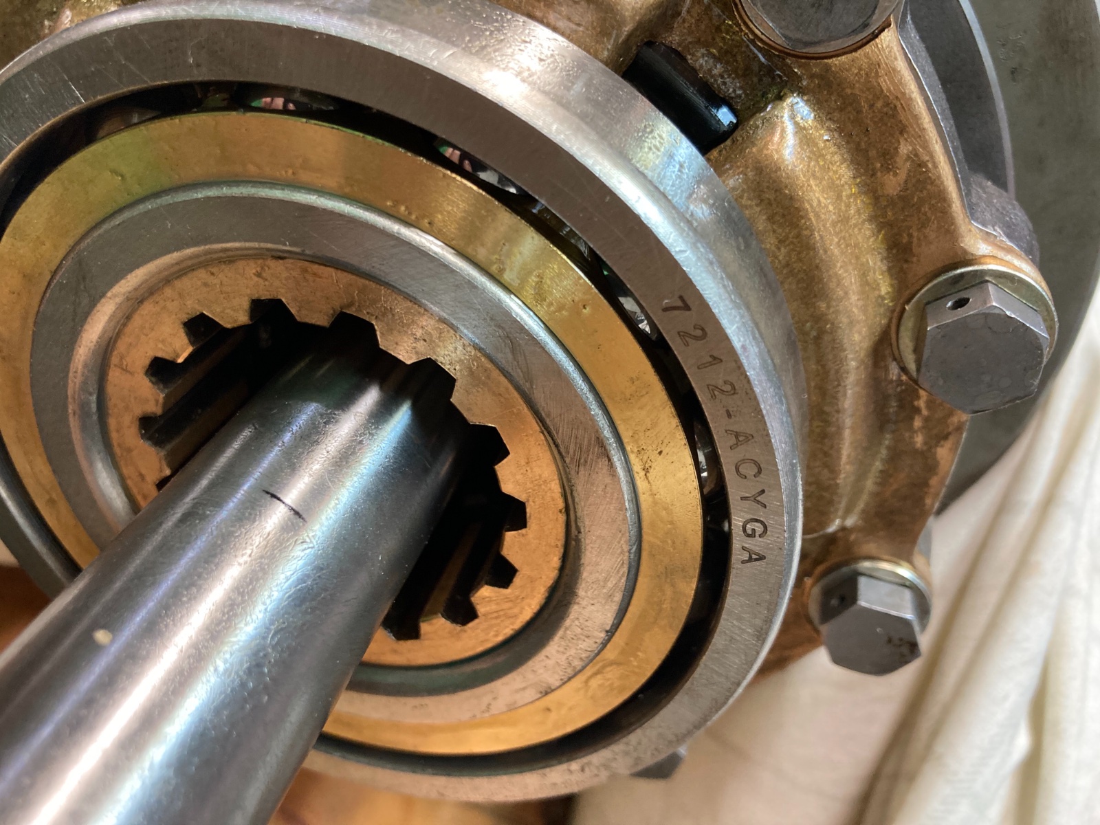

I have a brand new P211 thrust bearing and a brand new P139 bronze plate. I pressed the bearing onto the bronze plate as described in the MTFCA Ruckstell book. It went on fairly easily in what I would describe as a light press fit.
Yesterday, I was performing the shift lock function test. When I was removing all of the parts, I set the bearing/bronze plate assembly face down on my work bench. When I went to lift it up, to my surprise the whole bearing slipped right off and laid right there on the bench.
I am confident that the bearing was fully seated. The only thing I can figure is that the cooler temperature in my garage caused a contraction of the materials and allowed them to separate.
How tight of a fit should the bearing be on the bronze plate? Should I consider using Loctite bearing retainer on the surface between the bronze plate and the inner race?
Any thoughts or experience would be helpful.

Ok, I've finally had a chance to get caught up and do some research. I'm by no means a bearing expert. Everything I've typed below can be found on the internet, but here it is all in one place:
1. 7212 is a industry designation for a single-row angular contact (thrust) ball bearing. It describes the critical dimensions of the inner and outer races. I have to believe this is why the MTFCA Ruckstell book only says to use a 7212 bearing and says nothing else about a longer part number.
2. The bearing that I received from Lang's is a 7212 ACYGA. The "ACYGA" is a designation system used by SKF and its subsidiaries to describe bearing construction. Therefore I have to believe that what I have is a SKF bearing regardless of where its made.
3. Angular contact bearings are designed with different contact angles. The contact angle describes the point of contact between the balls and the races relative to the operating axis of the bearing. The larger the contact angle, the higher the axial load capability. The smaller the contact angle, the higher the permissible speed capability. Centrifugal force changes the contact angle between the inner and outer race.
4. A "BECBY" bearing has a 40deg contact angle. An "ACYGA" bearing has a 25deg contact angle. Here are the advantages of this bearing taken directly from the SKF website:

I’ve got to agree with you there. It might have nothing to do with why I got the bearing I did but it’s helpful to know the how’s and why’s behind the bearing designation if you’re out there searching in the wild for one. The SKF website is a great resource.
StanHowe
- Posts: 979
- First Name: Stan
- Last Name: Howe
- Location: Helena, MT
Re: Ruckstell Bearing/Bronze Plate (P211/P139) Fit
I doubt that anybody at Lang's could tell you the difference.
I've rebuilt over 70 ruckstells and have seen some pretty strange bearings in them.
Lots of guys are if it fits use it!
