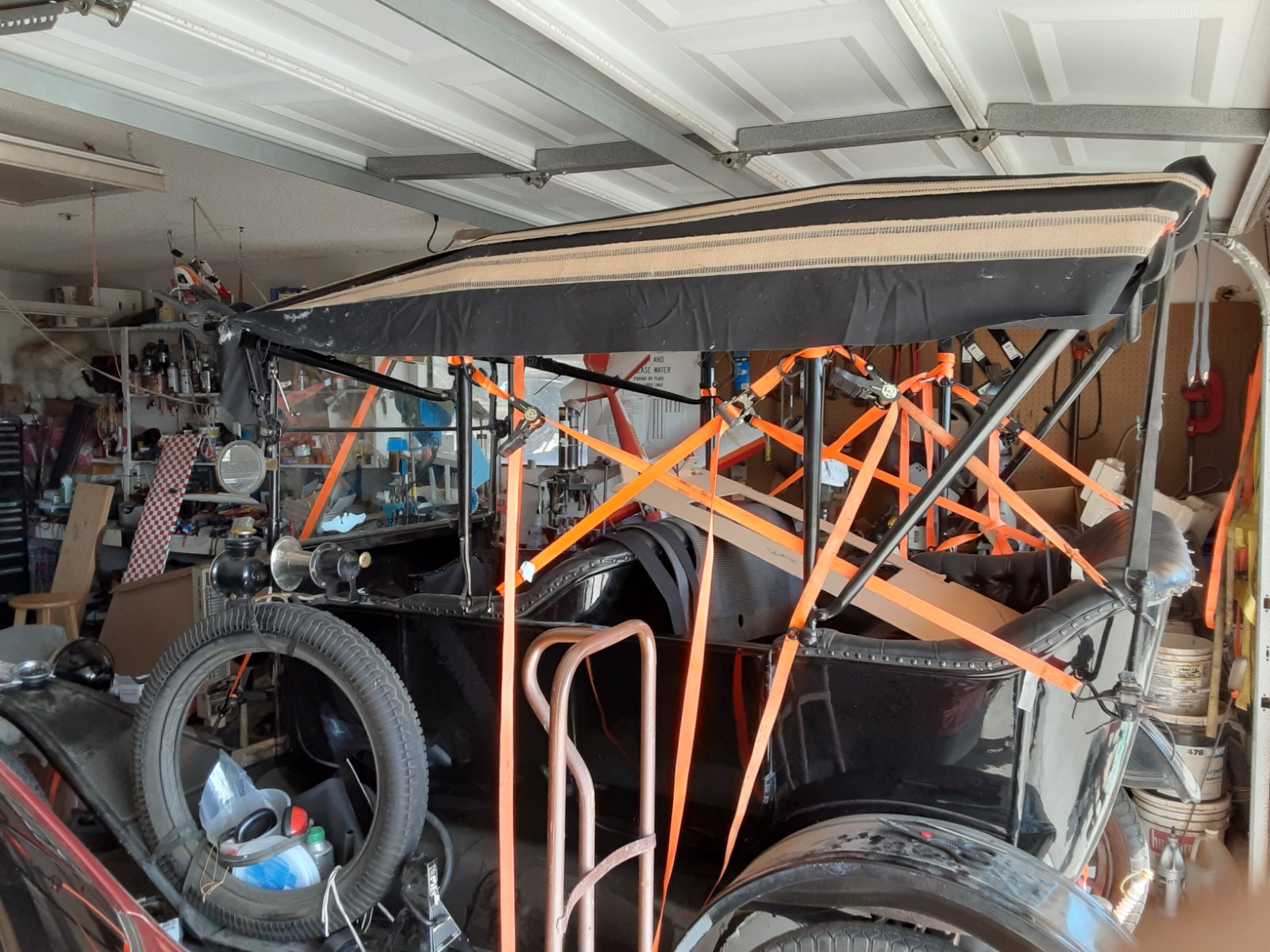

I just replaced the top on my 15 touring car. The information in the Model T Ford Owner is for a 1923 and later top. I determined the length of the wood bows using that drawing, but set the rear bow to align with the rear seat tack strip. From the Ford Owner book I determined the bow lengths. I'm not certain that is correct for my car, but it came out looking good. On the last bow, raising it to align it made it about 1/2" to long, so I adjusted the rear bow length. The top iron mounting locations are in different locations, i.e. they are not in alignment nor are the top irons the same length. I just adjusted bow lengths on each side as necessary. The front bow length from the top iron on my car is about 1/2" different. I broke a bow, so I replaced all of them when I put on the new top. I went to harbor freight and bought a dozen ratchet straps to align my top bows. If you use straps, put them there the top pad wont interfere when putting them on. I found a nice pair of sheer scissors at Harbor freight for under $10 bucks and they were handy trimming the webbing to length. I bought longer tacks as my fingers are just to large to hold the short ones. Also I bought extra finish tacks as I bend a lot of them. I used a plumb bob to align my top irons vertically. A minor movement of one ratchet strap affects the whole top iron alignment. I tried tacking wood strips in the past and that worked just wasn't as easy as ratchet straps
The 1915 car uses a wedge shaped piece of wood on the last top bow. I do not know if yours uses this piece.

This article is by far the best one on how to do this: https://modeltfordfix.com/installing-a- ... r-model-t/ The videos are ok and helpful but the reference article is the one that really explains it. Yes I did it without experience. My Mother said it is ok and not cheating to use fabric glue instead of stitch for the pads. So far she was right and that was a huge time saver as well as I don't stitch very well. Someone said 3 Saturdays and that was about right. Here is an extensive discussion of my experience: https://mtfca.com/phpBB3/viewtopic.php?f=2&t=3803

We have installed well over 100 tops over the past 25 years. The dimensions in the model t ford owner book are in fact for the 1915-22 top and are very useful. The 23 and later top is a different and much easier top to get right from a kit due to the fixed bow positions(especially at the windshield)As shown above the real secret to doing a 15-22 top is fixing the bow positions correctly beforehand and making sure they dont move during stretching. The biggest mistake i see people make is to not make sure the rear bow overhangs the back of the body by 2-3 inches. This gives the top the correct look at the back. Unfortunately even the top kit makers are not aware of this and leave little or no extra material to grab onto lengthwise. We are in minnesota so if you want some help let us know.
