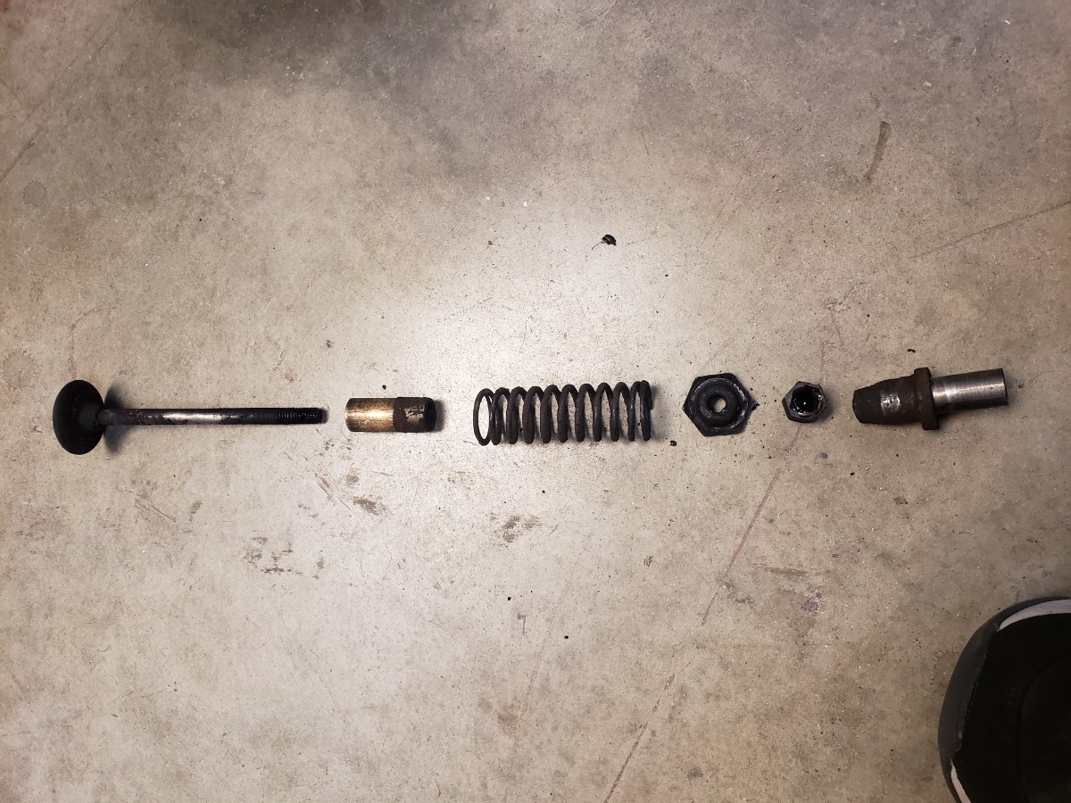

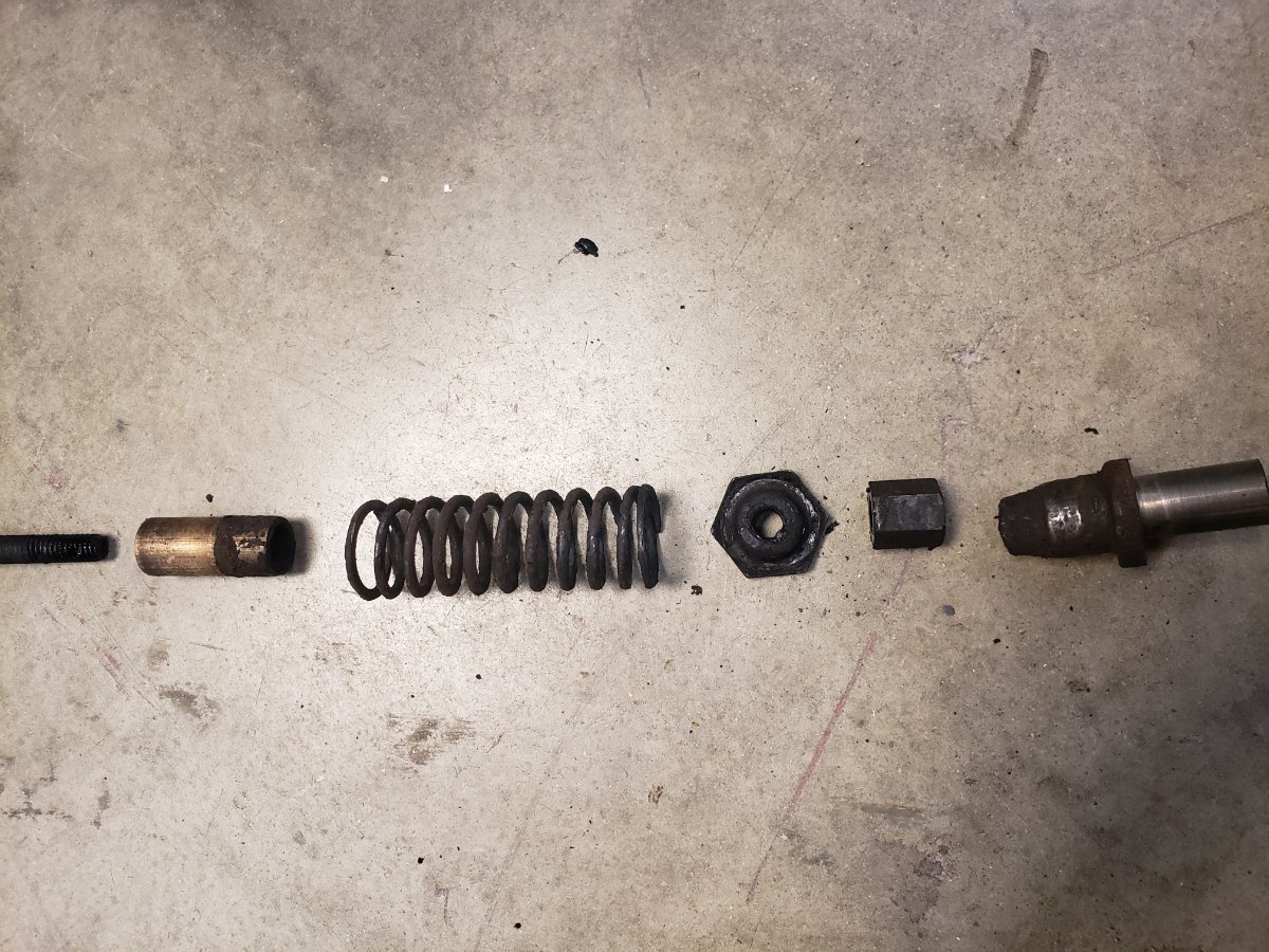

these are pictures of the valve parts out of my 1911 engine
i removed the valve guides as the valves were really loose in the guides, the guides appear to be brass but could be bronze
the tappet guides are also removable but these are either iron or steel as a magnet will stick to them.
the valve guides and tappet guides would be easy to recreate.
the nuts at the bottom of the valves are worn on the bottom side but i would assume these to be hardened steel as the ride on the tappets.
the spring seats are also fairy easy to duplicate but i suppose these could be reused. the valves could clean they may be able to be reground and reinstalled but i would prefer to use new ones if i can find threaded replacements.
i know they can all be replaced with newer parts but i would like to rebuild it original except for the crank and pistons

Looks to be some ones creation, don't believe it to be an original Ford set up. You wouldn't want to re-use those valves anyway, they are 2 piece ones that are prone to break.

A machine shop probably could have installed what's called a guide liner that would have been concentric with the seat. I probably would have left them in and gone that route if your wish is to get back down to standard. I'm not familiar with that threaded valve and hex retainer that you show.

I'm wondering if those very "unique" and unusual valve train components might be found in one or more of the several Model T era "after-market" accessory and parts catalogs? Like Western Auto Stores accessory catalogs for example. Never seen anything like what's shown in the photos,....especially the octagonal valve spring retainers. It does make sense that, back in the day, someone would come out with a method of adjusting valve lash easier than grinding valve stems, or, the very labor intensive procedure to replace the original solid tappets with adjustable tappets. Great photos by the way,....thanks,.....harold

.......ooops! Just noticed that the valve spring retainer is "hexagonal",....NOT octagonal! Oh well,....not all that important I guess. The main thing is,....they are normally perfectly round!
