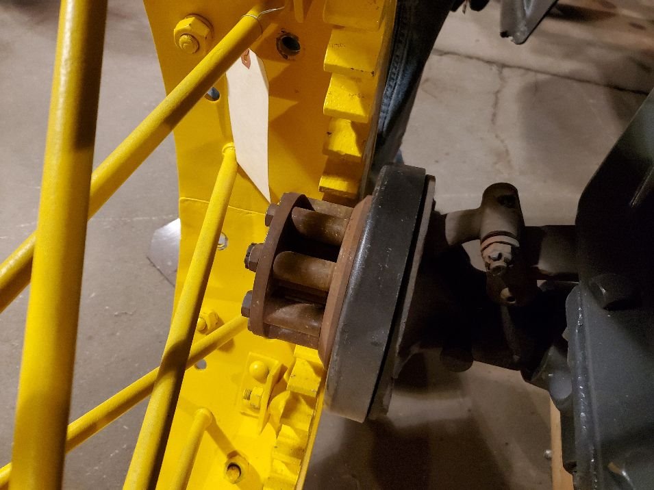

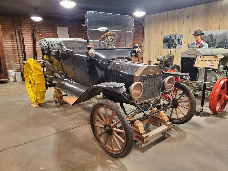

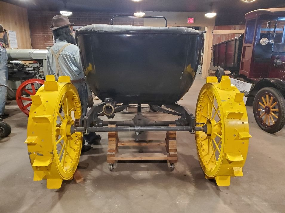

Many thanks to Justin of the museum for these pictures. It seems the museum has a real life STAUDE tractor conversion on site:

I don't see a way to attach a draw bar. Would the farmer create his own or were they offered by the manufacturer?

Its hard to see in the photo, but there is a small hitch in the middle of the axle that is part of the attachment. It slips onto the axle before the wheels are put on and can be moved anywhere on the axle between the channels and can be tightened wherever the operator wants it placed.

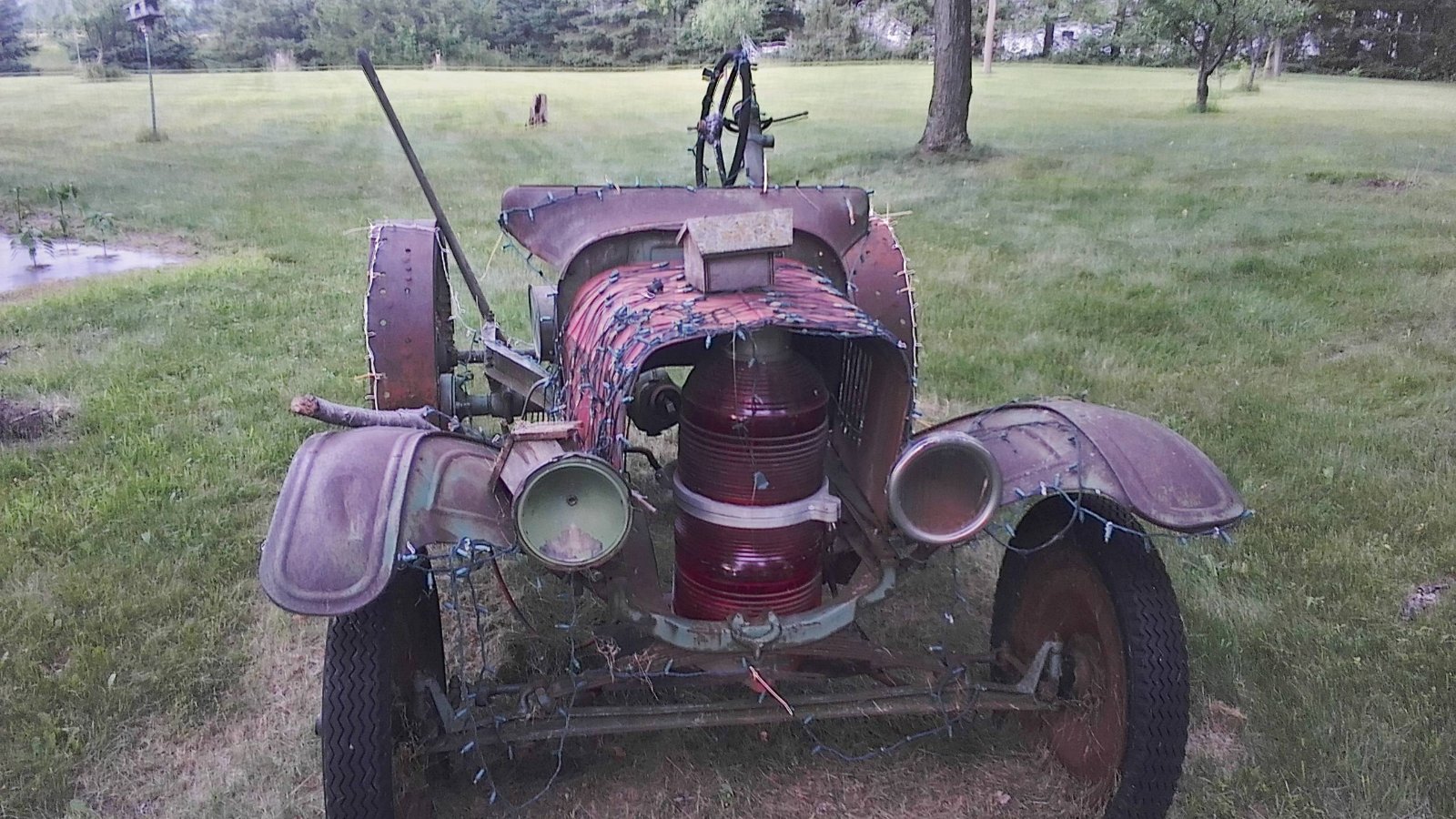

Mine is waiting for an engine in the works. No hitch to show. Powered by a 625 watt bulb for now.
