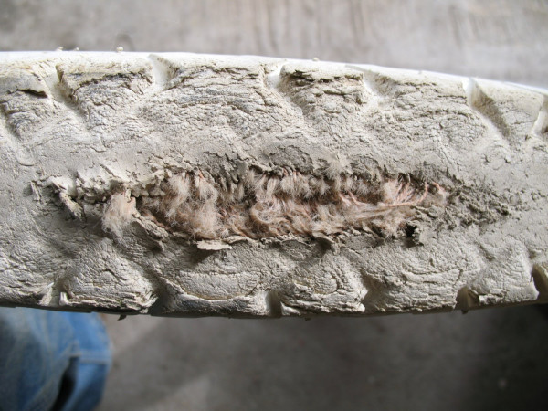

No, the NOS tires I bought were white Firestones made in New Zealand. They came out of the original wrappers looking brand new and gorgeous. Country roads ate them up in no time.
The fact is that rubber deteriorates with age, no matter how good it looks. I will not waste money on more NOS tires.

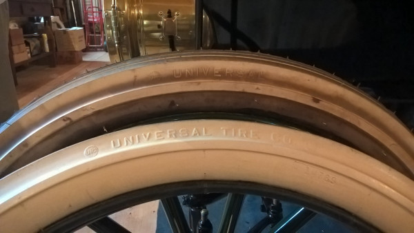

That didn't used to be the case. The white PJA's made 50+ years ago that you see today are still white. This one in the first photo is one I took last year on a car that is regularly toured. All of the PJA's that I have seen are still white, so it's not a matter of technology, it's a matter of a decline in the quality of the new product that seems to coincide with manufacturing moving overseas.
I have been round-and-round with this the last couple of years. The next photo is a 30 year old Universal next to its replacement (mounted in 2014) that turned brown in a matter of weeks. The 30 year old Universal had turned ivory long ago and then nothing more. Perfectly acceptable. They replaced that set under warranty. The third photo is from the same set shown above against its replacement in 2016. The replacement is starting to turn, but has taken longer. It is also on the road to being unattractive.
Making white tires that would hold their color used to be a doable thing. Somewhere along the way the chemistry changed. Maybe you'll get lucky and the new batch will have the issue resolved, but I think it highly unlikely as every time I have had this conversation with the suppliers they will admit that they don't know what causes it and they have no interest in rectifying it.
Also, for what it's worth -- some black Model T tires turn brown, too.

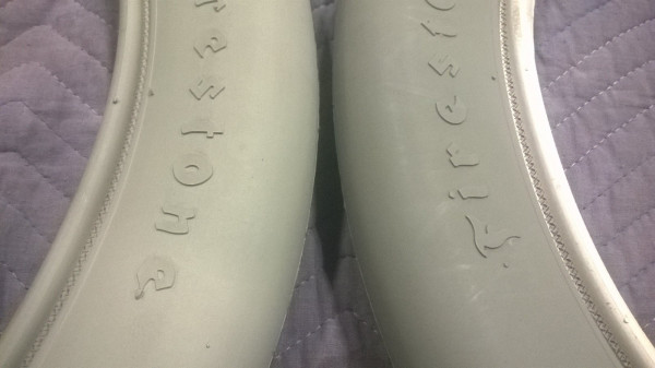

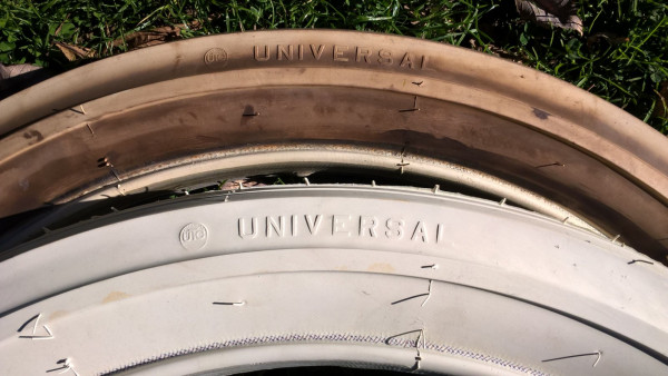

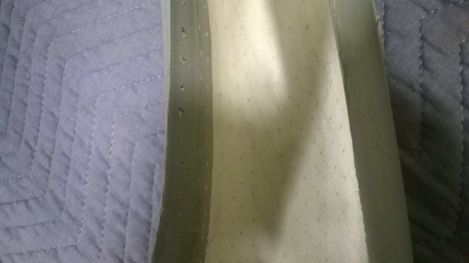

Hi George, I'm glad that you joined the discussion. I can't answer all of your questions but I can add to the confusion if you would like. The first set of whites that turned brown were turned back in for the warranty claim. The second set of whites that have now turned brown are on a car that I don't have access to at the moment. I will gladly test as outlined when I can, but that may not happen this year.
I will add a couple of observations:
These new white tires seem to have a more porous surface finish when inflated as compared to the 30+ year old white Universals I have handled which seem to have more of a waxy finish.
I have also handled an equal number of sets of gray tires. The gray tires look like a white tire "painted" gray. However, the white tires look like a gray tire painted white. I've had whites that are gray in the inside and grays that are white on the inside. I've had grays that have a white clincher bead and grays that are gray all the way around and the color wraps partly inside and then changes to white. To say nothing of ordering one set, unwrapping them, and finding different combinations such that you can't get a matched color/set on a single car.
If you want I'll add more photos later.
As to the tubes, they used to say the EEC tube was the problem, so then they required use of the individually-boxed Hartford tube for warranty claims. I put both side-by-side and looked them over hard with respect to mold marks and whatnot. They are exactly identical except one says "EEC" and the Hartford's say "Made in China".
With respect to the flap question above -- in the case of the white tires shown we reused three of the 30+ year old flaps that were already installed previously and one new "Made in USA" flap and that had no effect as all four discolored equally.
Also, the inside of the tires don't turn brown.

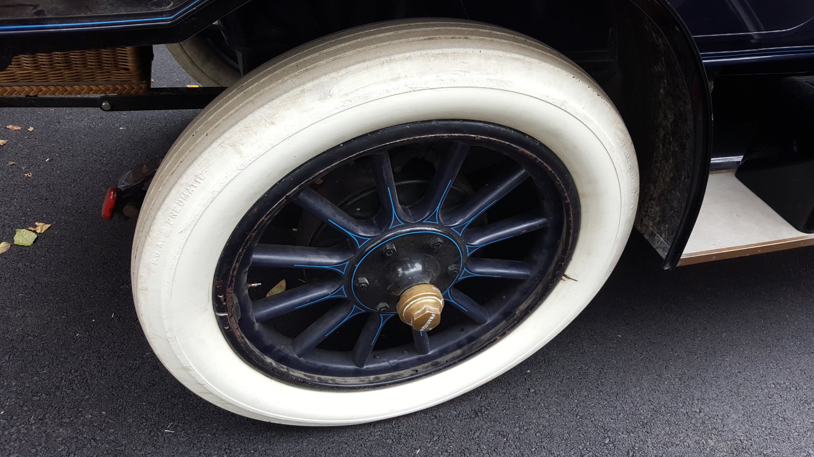

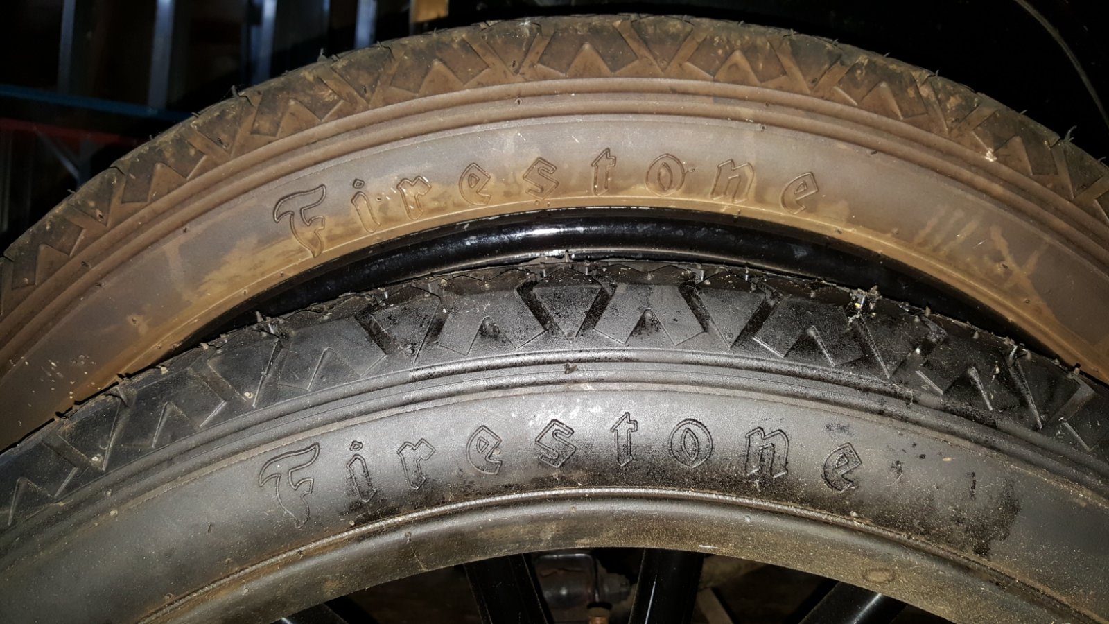

Just to irritate the black tire crowd, I will attach the following!

Good luck! I should have pointed out that the grays I mentioned above were all smooth Firestones.

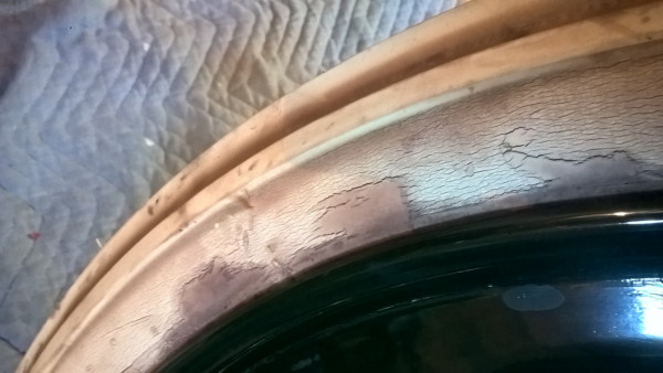

Since you are a sucker for punishment, George, here are a couple more! Of the ones that had a white bead some were so sloppy that the white was just peeking out from the rim when installed. I don't remember being able to feel a step at the color change if that helps. The second photo is the all-gray tire (on the left in the first photo) spread open to look inside. I have another set of grays here to unwrap soon so we'll see what kind of surprises they have in store for us.

I've dealt with whitewalls that have browned and that is a completely different animal. Typically it will clean away with Bleche-Wite. At worst they can be wet sanded clean with 600gt sandpaper. I've not seen whitewalls that turn brown experience the inconsistent surface degradation of the rubber where you'll have a dense hard spot right next to open cracks.
Interestingly enough, as was pointed out to me by a friend offline, he has seen the PJA's that I mentioned above where they are black on the inside. The same is true of the old Universals that I have handled, neither of which have this issue of discoloring and degrading.
This photo will show the worst of the issue. This was a tire mounted in 2014 and switched out in 2017 when this photo was taken, though it was already significantly deteriorated well before that. It just took a while to sort through securing another set and doing the swap.
