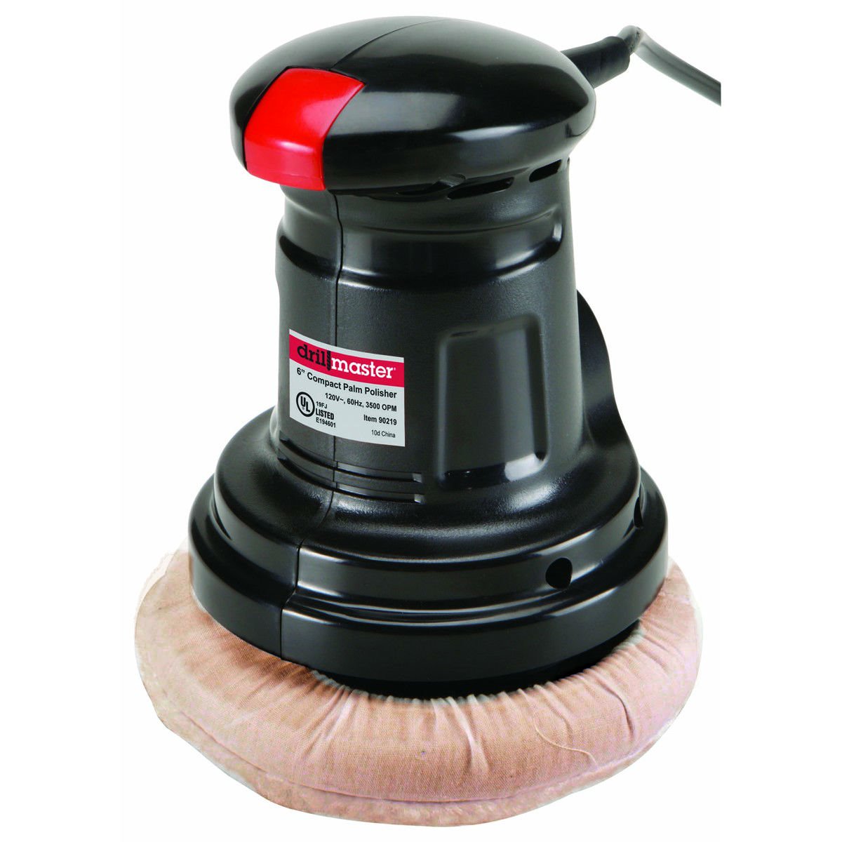

The heat generated by your radiator makes the situation a whole lot different than lacquering things like door-knobs and candle-sticks. If you hate polishing, get one of these small orbital buffers from Harbor Freight:
https://www.harborfreight.com/6-inch-co ... 90219.html
It's cheap as dirt and makes polishing the radiator a breeze (but you must dismount the headlights to gain good access—no biggie).
Use a polish that has little or no wax in it because wax, when heated, fogs over. I prefer Prism Polish because it works well and a little goes a long way, so it's fairly cheap.

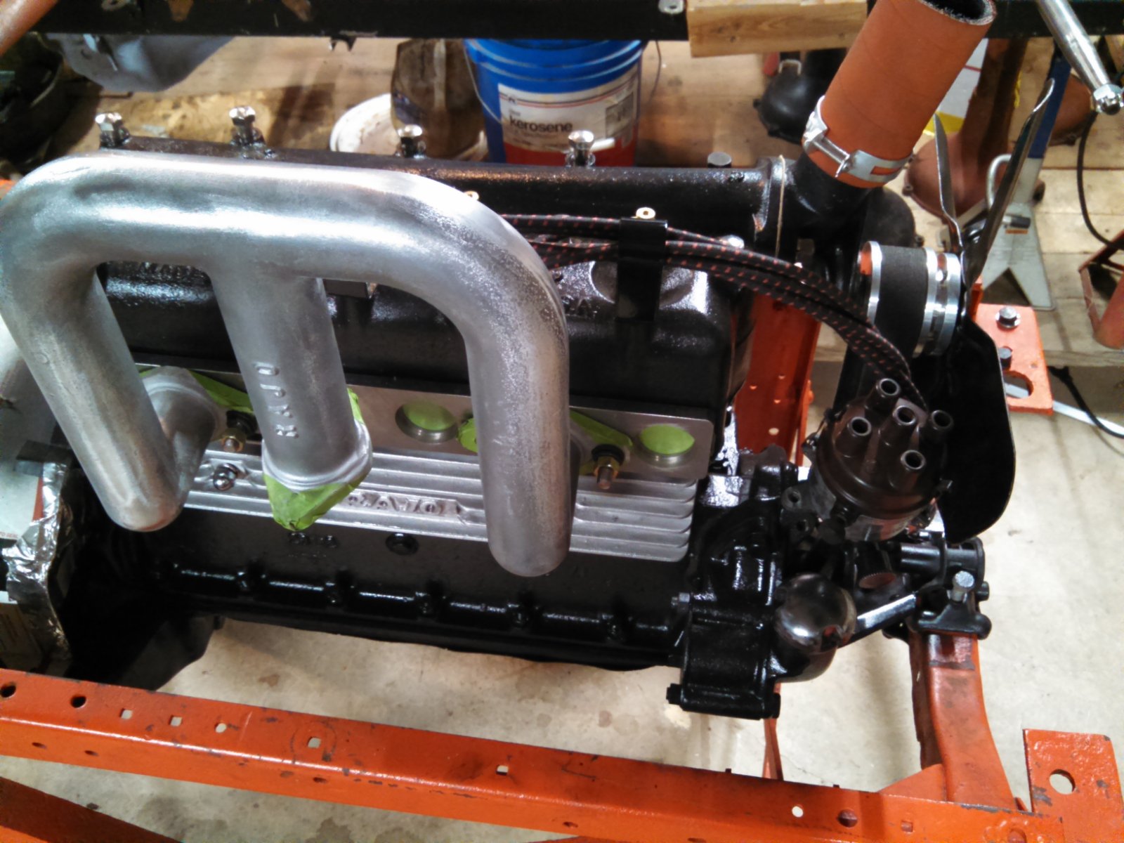

I am using these Rust-oleum Clear products as appropriate; manifild and other engine parts as I go.
In the process of a build so I have no results from heat exposure. The engine enamel is good to 500 degrees and the High Temp to 2000. Hard to get locally - online at ZORO (500) and Summit (2000)
