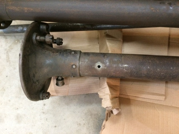

Clean 105 years of dirt and grease off the rear axle housings today. No wonder my t has been marking her spot. Found this in the right side housing. Should I try to braze or weld it? Was it drill to let out oil so it would get into the emergency brake drum? Going to order all my replacement parts on Monday. The outer bearings and s leaves were replaced about 10 years ago but have very few miles on them. They are the type with no grooves on them. They fit nice with no play. Should I replace them? Where are they available with the grooves or do I order the sealed outer bearings $$$.

To me it appears to be a Breather Hole. Probably not required with the original type sealing arrangement.
However, as discussed here previously, once you upgrade Pinion Bearings and use effective Oil Seals there and in
Safety Hubs the likely hood of pressure build up is real. I have just added a Breather to a rear end and have used a clear
tube to see any evidence of oil working its way up.
You will notice that it has been drilled inboard of the original seals and Hyatt Bearing Sleeves. ideal spot. I would tap the hole and fit a low profile Breather with a Cap. Others may disagree but once tapped out, you can easily plug it later if required
Cheers Alan in Western Australia

That hole looks to be at the bottom of the tube. If so it would not be a "breather" but a drain. We now have available good seals for the wheel bearings and you should not need to drain the fluid. Only exception would be if the 4th main at the rear of the transmission leaks letting oil drain down the driveshaft tube to the rear axle. If your babbitt is good at the 4th main and you keep plenty of grease in the U joint, this shouldn't be a problem. It is better for the brakes to let a little oil leak to the ground at the U joint than to let it run back to the ground. Just put a pan under the transmission at your parking spot and don't worry about it.

I put a grease cup in that hole on one of my tubes just to mess with people.

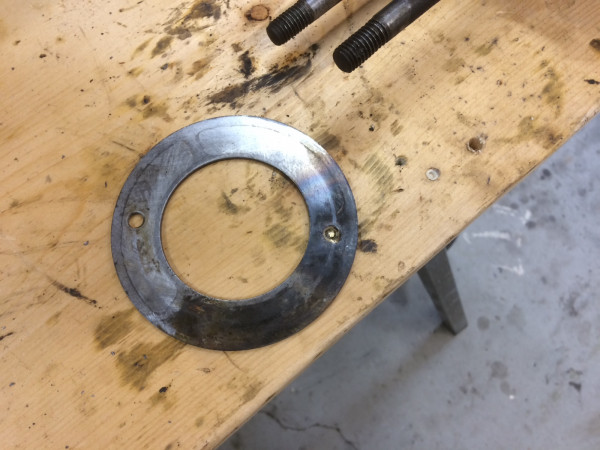

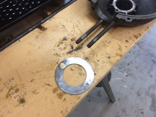

It should have self destructed. One Babbitt thrust bearing missing. Three thrust washer rivets sheered off. I found what looks like a broken drill bit in one of the rivet holes of another. They had tried to braze and grind smooth the thrust washer to the broken drill bit. Going to be tough to get that one out and cleaned up. Pinion bearing sleeve not sitting in key way. Good thing the universal joint rivet was still in place. I do need to place a second order for parts now before it goes back together. Only good news it’s been too hot here in the afternoons to take it for a spin.

I have new thrust washers. All the old ones were worn down to .085 and scarred. I have a friend who can mill me up a plug for the drilled out rivet. I’ll ordered new rivets tomorrow, thrust washer shims, and a few of small items needed.

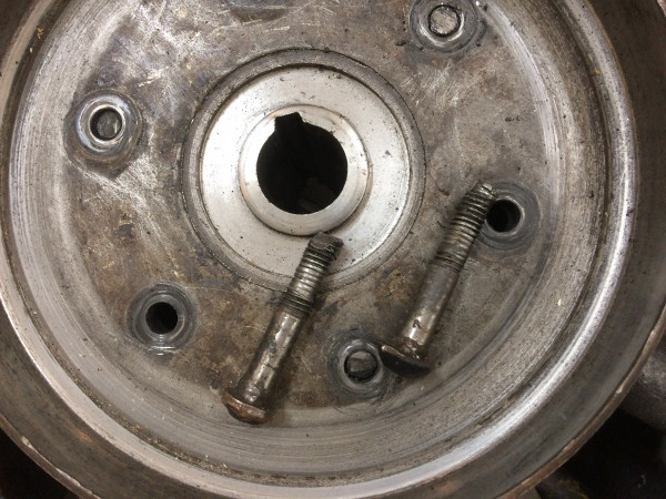

Hubs all Cleaned, wire brushed, painted, and reassembled. Turning nice a true. Ran the differential last week with the wheels off. Sound nice a quiet. Everything looking good so I couldn't finish looking at the rusty rear springs. All disassembled and wired brushed. Picking up some spray graphite slip paint tomorrow. Saturday finish reassembling and a test ride. I’ll post finished pictures then. Been a lot longer project then I was thinking, but worth the wait.

Great progress. On my first worn out T so many of the hub bolts were questionable that I just changed them all for new ones. On those better safe than sorry. The hubs were much more solid after changing for new ones.

I would get the new hub bolts from RV Anderson or ask the parts dealer if they came from him. He supplies them because others were (are?) of poor quality.
