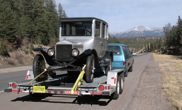

I have not because I have a trailer for the T.

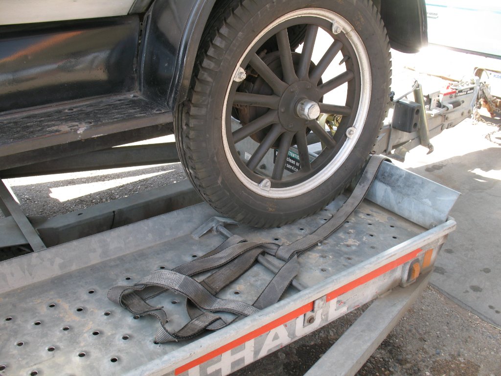

What I understand is that the wheel tie down does not work for T wheels and comes off.
Use straps on front and rear axles. Also have one strap from the rear axle to the front of the trailer.

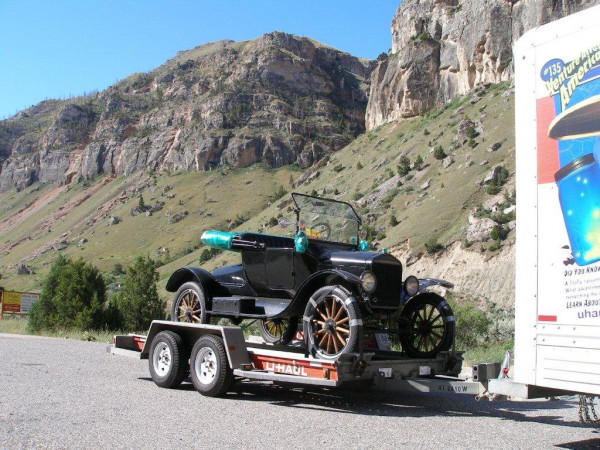

I towed my speedster on a U haul open trailer for 300 miles, it did very well, the trailer pulled nicely.
Tim

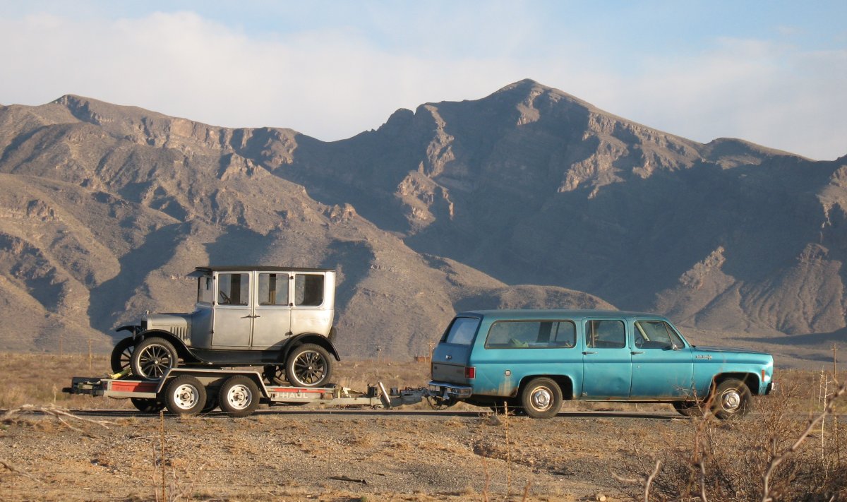

We towed a 1920 Center door sedan on a YouHaul trailer. Pulled very nicely with no problems. You most likely will have to work on the "tie-downs" as the ones on the trailer are for standard modern tires and not T tires. We have since purchased a trailer to haul our Ts. We are planning on finding a longer one so the Ts do not have over the back end so much. Ours is a 12' bed, which works well but the TT is just short of the maximum legal rear overhang. We're looking for a 16' for less overhang and more flexibility in positioning the T on the trailer for the best tongue weight.

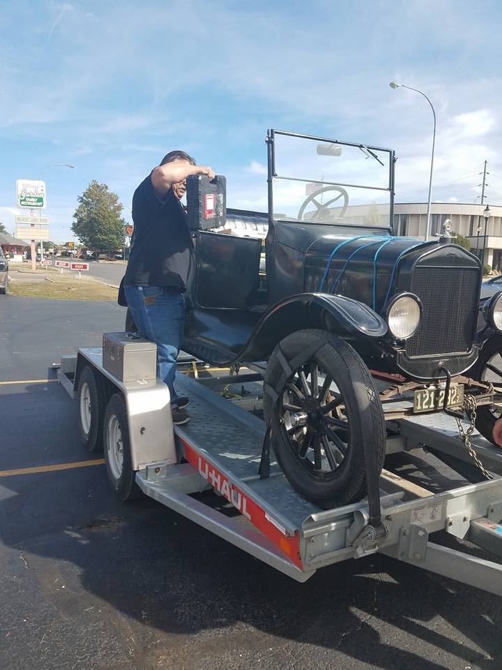

My tool boxes hold down the floor boards. Straps/cords hold down hood. Never had a seat vision come loose. I retired from a nuclear generating facility where I learned about redundancy of safety systems. Defense in depth! There is one thing that man cannot take away from you, your education.

I have done it and it worked well. Like everyone says the though, the front wheel "net" straps do not hold well and need to be re tightened periodically. Instead of relying on them I recommend strapping the front and rear axles with come along tie downs.
- Posts: 7392
Re: Towing Model T
Yes, I have done it. I agree, don't depend on the wheel straps. They wouldn't stay on. I had no other problems.
I have since learned that straps should not pull forward on the front axle. Fortunately I didn't learn that the hard way.
They simply would not stay on.

Re: Towing Model T
I would agree with Jelf.
Noticed the yellow straps.
Strap it down like it is on a utility trailer. Cross strap it at the wheels and axle strap back to front.
