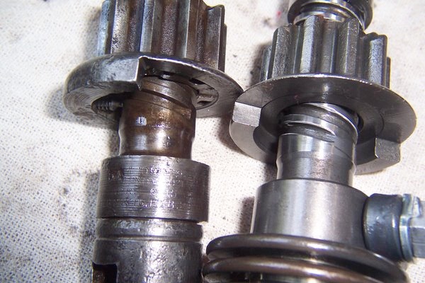

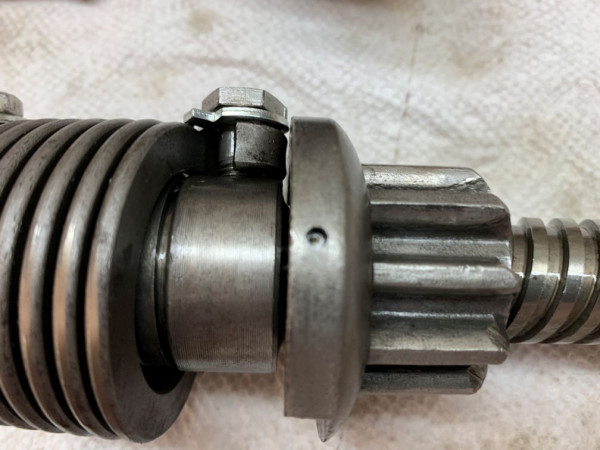

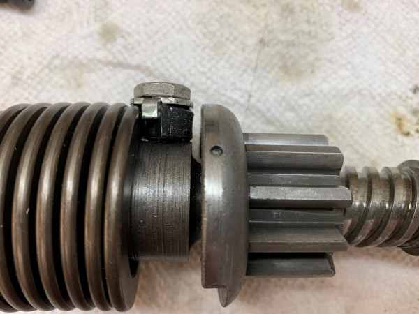

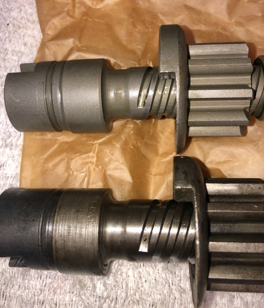

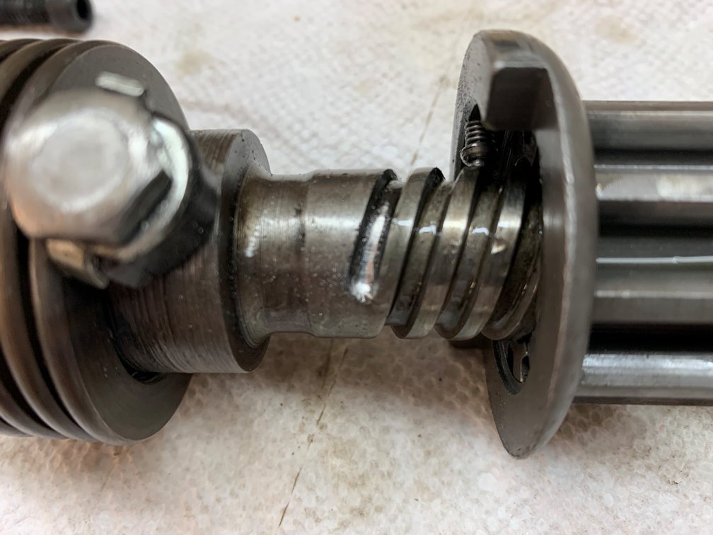

I've had a starter Bendix which would stick and frequently not engage the ring gear. When I took it apart I found a divit at the end of the channel or threads. I have dressed it with a small dremel tool, but I think it will reoccur due to a more fundamental problem. This Bendix has a new reproduction gear. I compared it to another Bendix with an original gear. The two photos show the comparison. The first one has the original gear and the 2nd is the one has the repro gear. When retracting, the original is stopped by the face hitting the edge of he spring. The repro is stopped by the Bendix running to the end of the channel or threads. This is not a good stop and creates a divit at the end of the channel. The last photo shows the end of the channel after I dressed it to remove the divit. Has anyone else run into this and what did you do about it? I think there is a problem with this repro gear.

Noted on your photo that last tooth root ends in a dead end, that probably could be an issue with sticking.
Early repro Bendix on right with little bit of closed end and square teeth hanging up the gear travel, compared to Ford Bendix on left
Freed up the last part of the square teeth for easy sliding return of the gear.
Just received this new repro Bendix, on the brown paper, and right out of the wrapping it is pretty nice, and the gear won't stick at the end when twisted back quickly with hand force slinging it to the end of the threaded shaft. Working freely.

Dan, I think my problem is different. Maybe my explanation wasn't clear. Unfortunately, I had already dressed out the divit before I took the bottom photo. Just pretend there is a divit there where it is now shiny. The divit made the Bendix a bit sticky in the retracted position. It must spin easily because only centrifugal force from the turning starter makes it engage. The Bendix retracts because the flywheel begins spinning faster than the starter, so it gets flung back until it stops. The original Bendix stops when the face hits the spring (no clearance in top photo). The new gear stops when it runs out of thread and this creates a divit at the end of the thread. I guess if no one else has had this problem, I must be the only one to receive a bad gear.
