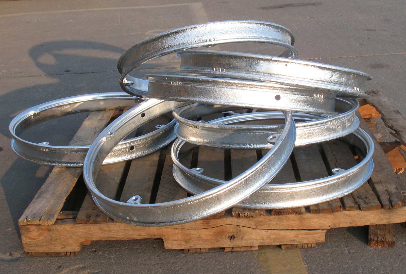

Oh so very long ago, at work we had to have some custom antenna mounts made and hot-dip galvanized. Because it was done by the pound, and the company had a large minimum charge, I was able to have every loose T rim I owned at the time done for free!
The wonderful thing about hot-dip galvanize I found, was that the zinc filled pits and thin areas so well that several rims I figured were beyond using came out nice enough that with just some minor filing and cleanup, I had nice usable rims. The downside was that good or bad rims all needed some cleanup where zinc would puddle and/or solidify in lumps (often easily done by melting the excess away with a torch!). If you have nice rims? The zinc plated may be best? If you have some marginal rims that you would like to save? Definitely hot-dip is the better way to go. As long as the steel is solid enough for strength, the zinc can do an amazing job of filling thin spots and pits.
Of course, nothing short of a massive welding and grinding job can save a really bad rim. Those few, after hot-dipped, I mounted ancient tires onto for display use. With enough of the clincher edge gone, mounting brick hard tires was easier.

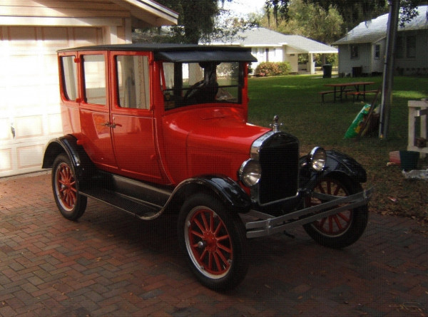

If you don’t have access to a place that does this plating or are working on a limited budget, the next best option is a bright silver roof paint called “Silver Brite”, made by Sherwin Williams. I painted my split rims with it and it is as bright and shiny as the rims in the pile of rims in the photo above. The best thing about using this is that it requires no primer and is very durable. Roof paint is made with a very high content of metallic pigment to protect steel shingle roofs from the most severe elements. Sunshine, heat, rain, hail, falling limbs, etc. It is also very easy to touch up the rims if they ever get scratched or become dull. Check out the rims on my two T’s in the photos. The rims were painted many years ago and are still shiny. Jim Patrick

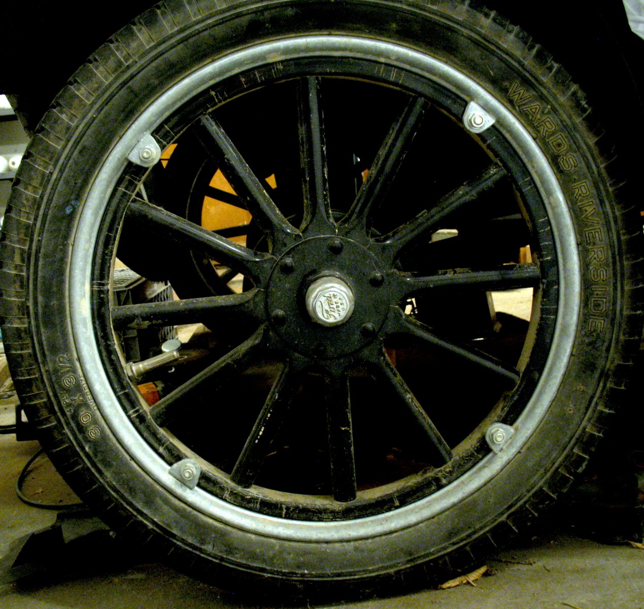

There are two types of galvanizing: hot dip and electroplate. Hot dip is exactly what the name says. The object to be plated is dipped in melted zinc. Electroplate is exactly what the name says. The dissolved metal (zinc) is deposited on the object by an electric current.

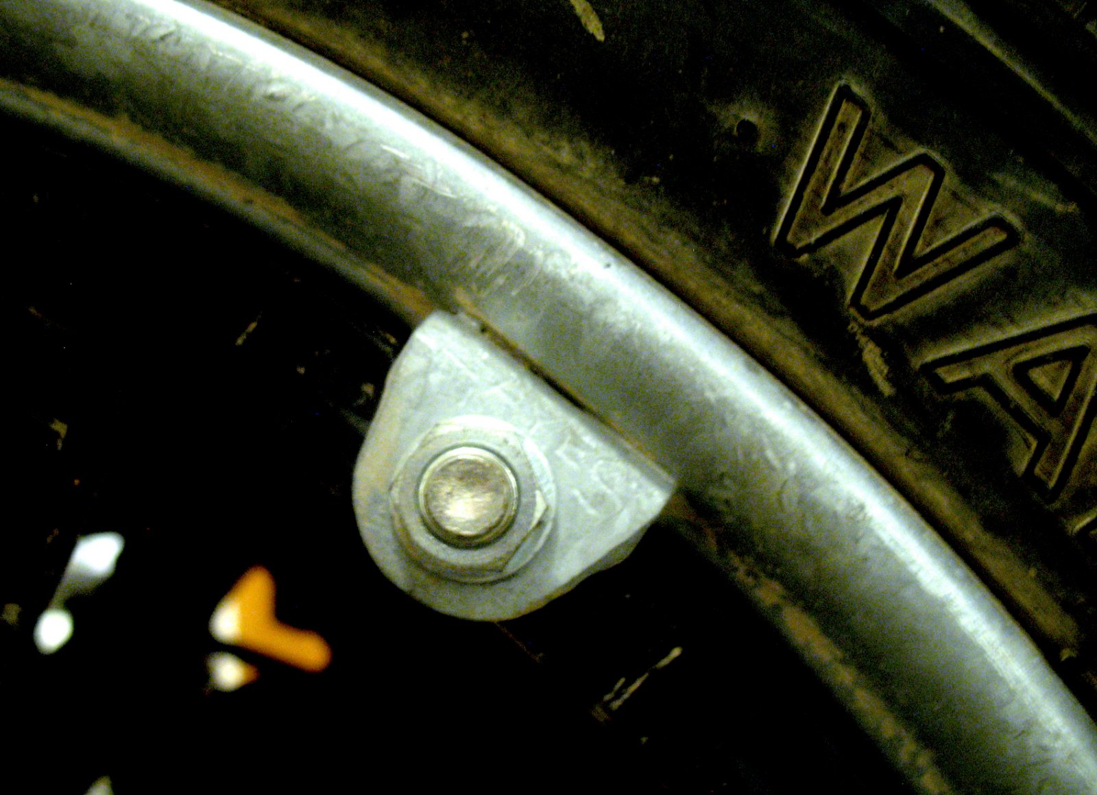

Yes, the zinc loses its brilliant shine over time and becomes a light metallic gray.
Modern galvanized roofing nails you buy at the hardware store are electroplated. Their zinc coating is very thin and in a few years they become rust spots. Galvanized shingle nails my grandfather used when he was building my house ninety years ago were hot dipped. Most were unrusted and I was able to use them over.
Here's one of those shiny rims eight years later:
