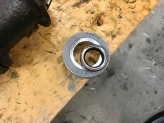

The press in oil seals on my modern outer axle seal from Lang’s got chewed up. Could some one look at theirs a send me the seal #. I matched the O rings but having trouble finding the axle oil seal.

The ones that are available from the vendors today don't look like yours, but may still use the same seal?? The seal # is POS26407 TF marked PEER TAIWAN.

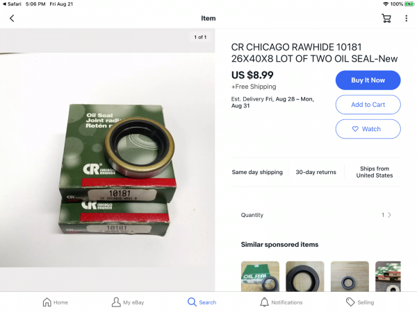

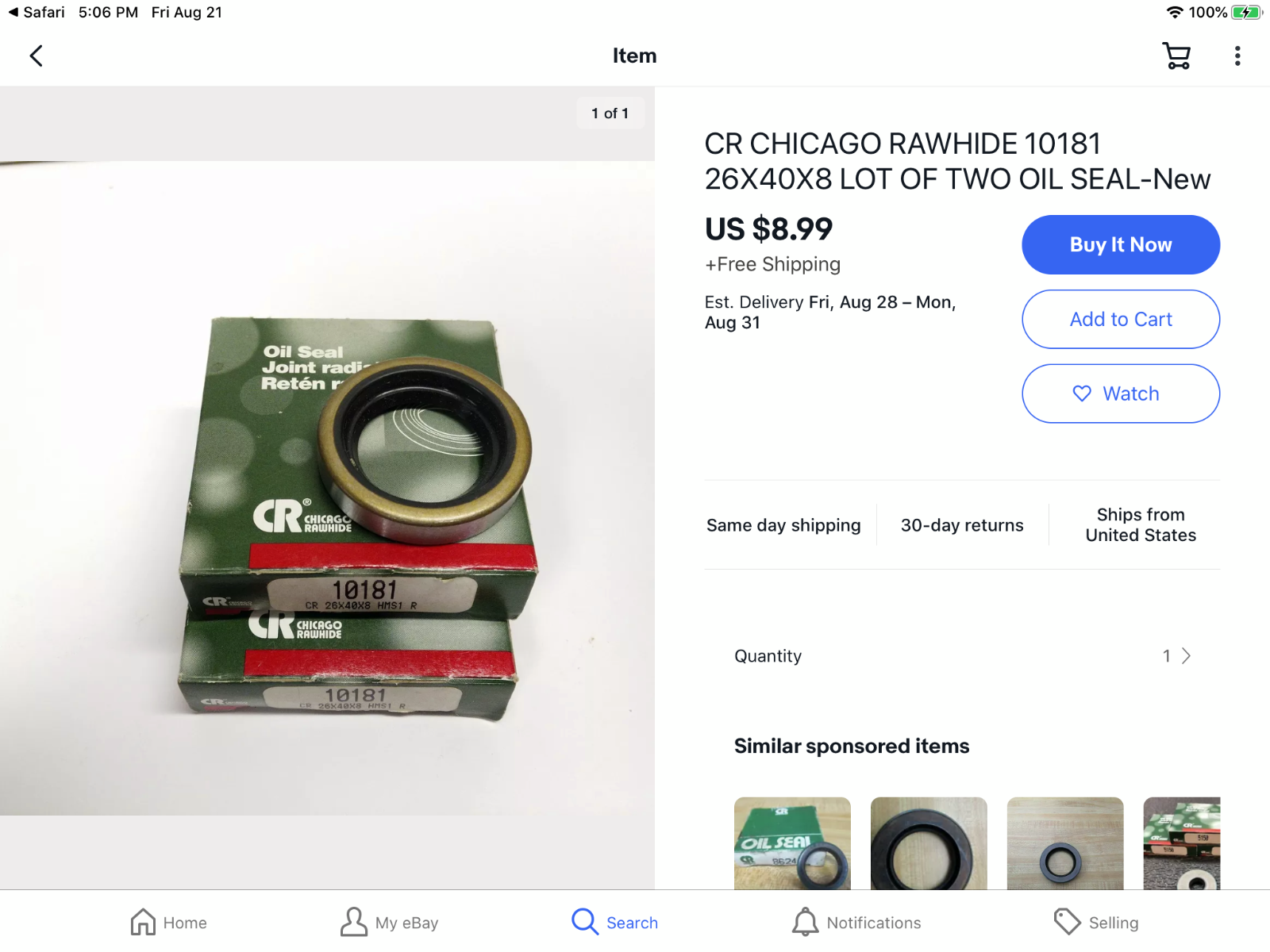

Could only find 26-40-7 from any local venders. Found these on eBay. They are discontinued. If they work I’ll find another set to have on hand.

These modern seals do not work well. the seals are very narrow and will not follow the axle as it moves off center from bearing and axle wear. this causes a seal gap on the opposite side that results in a leak. Our modern seals are a boot type seal and will follow the axle movement. Glen
